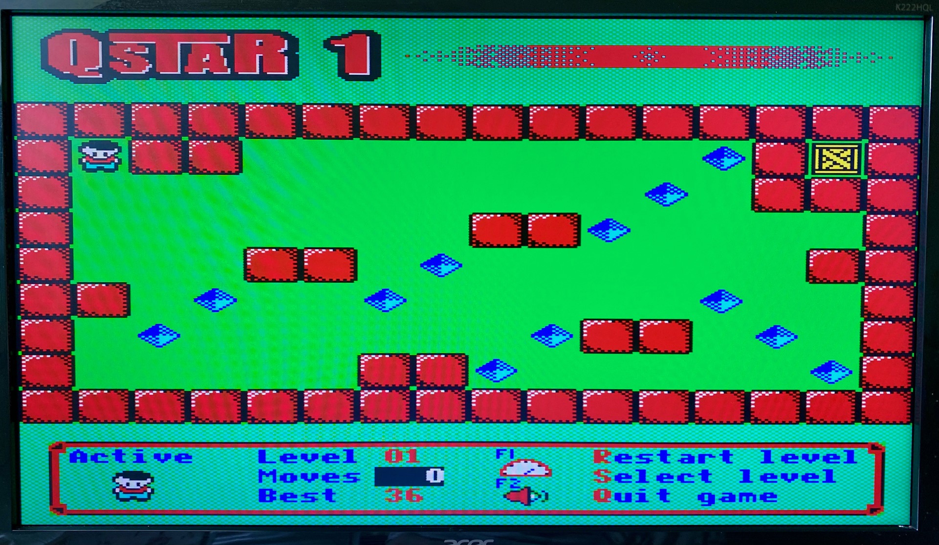

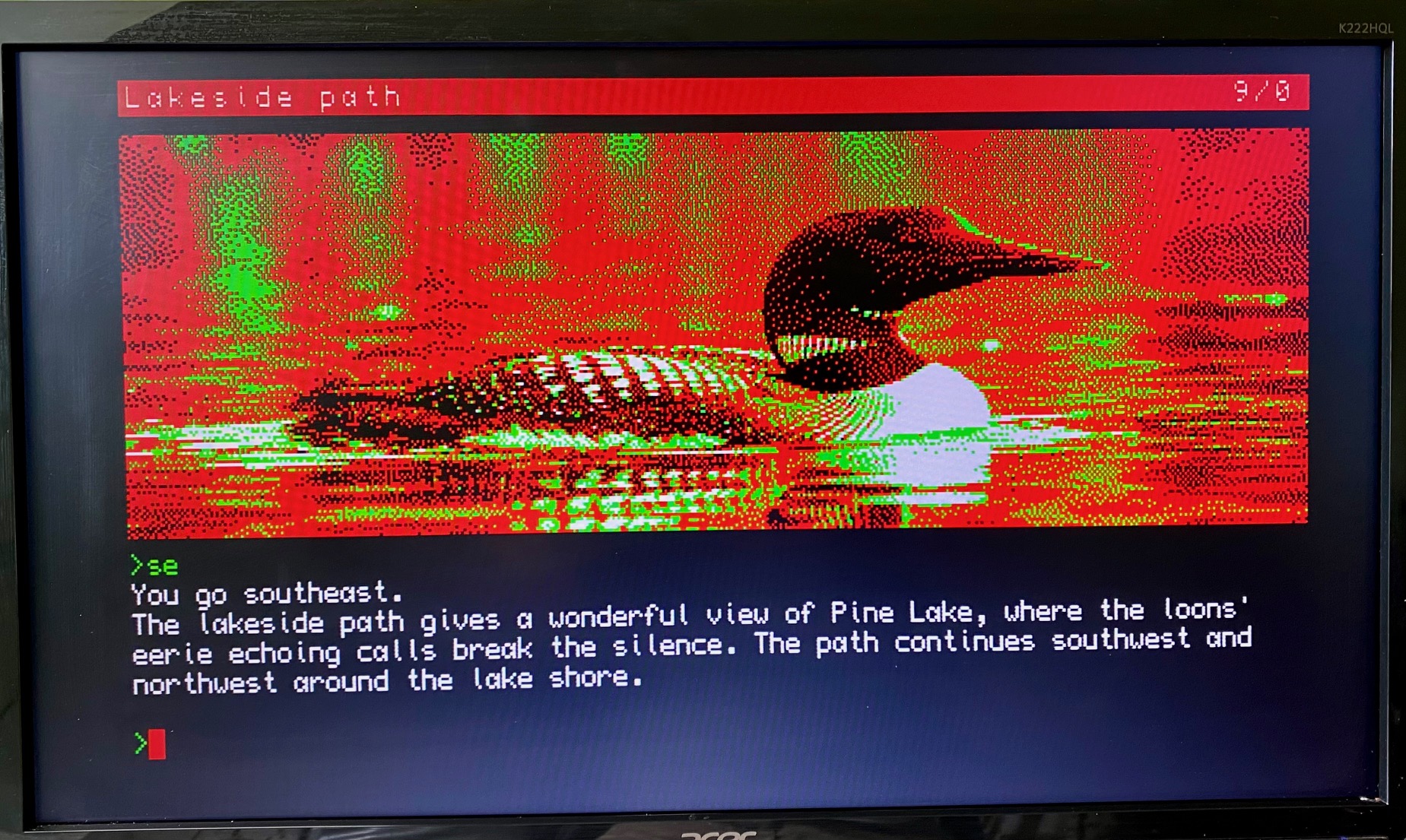

I'm happy to report that my QL resurrection has been a success! I have one working floppy drive (which is strictly off-limits to my old disks, which finally wrecked my other floppy drive, despite lots of head cleaning with cotton buds and IPA). And now having re-felted a number of microdrives, I have finally transferred an old program that I had feared lost forever.

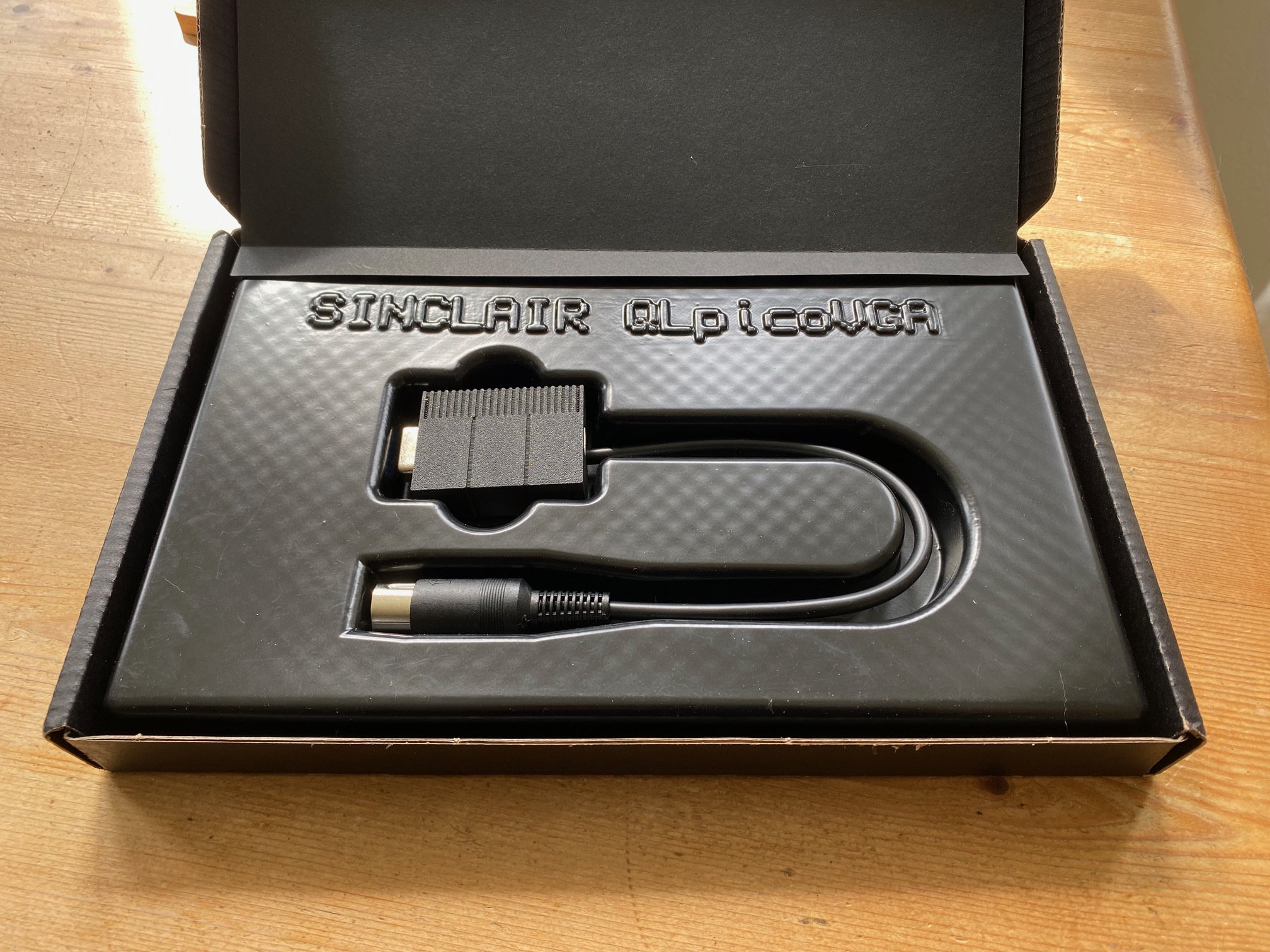

And not only that, Marcel_X's QLpicoVGA was set free from customs and arrived today. Wow - it's so beautifully made and packaged, and it works beautifully too! The screen is so clear and pixel-sharp. What a difference from plugging into my big TV with composite video. Thanks so much Marcel :D
Thanks also to all who helped answer my incessant questions. My QL is happier now and so am I :D

Sebright wrote: Sat May 03, 2025 3:27 pm I'm happy to report that my QL resurrection has been a success! I have one working floppy drive (which is strictly off-limits to my old disks, which finally wrecked my other floppy drive, despite lots of head cleaning ...
Congrats!
And amazing package!
I wonder how did it with the plastics. Really very very very high quality.

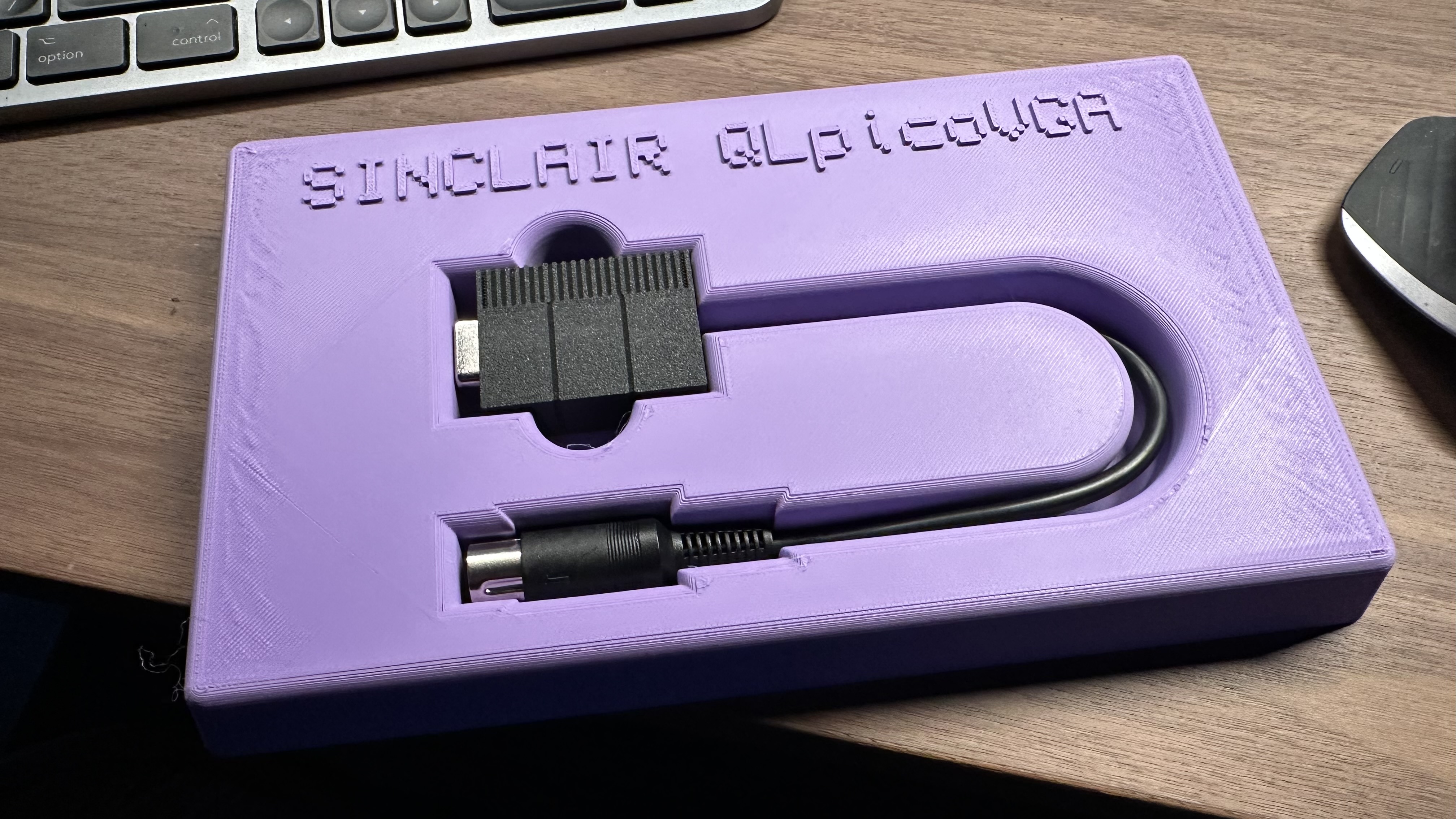

Thanks for the compliment! And thanks to Holmatic as he is the one that made the firmware and initial hardware. But good to hear it arrived in good condition. It did take quite some time to arrive :( I was getting worried.
Popopo wrote: Sat May 03, 2025 5:09 pm Congrats!
That's a trade secret :-) Nah, just kidding! I got myself a vacuum forming machine and still learning the ins and outs of the machine. So this was a nice opportunity to make something useful. Modelled up a mould for the packaging and could make a few inserts before the mould started to deform due to the heat and vacuum. On Alan's picture you can already see the infill from the 3D model showing up as a rectangular pattern on the top surface. Which is actually not that bad looking!
