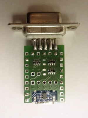

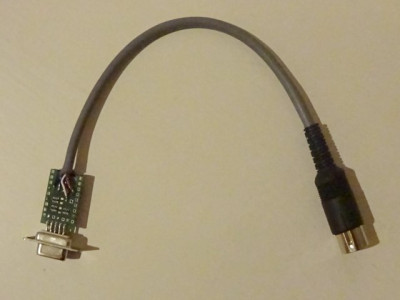

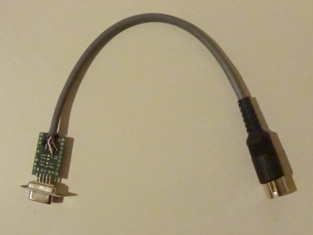

There are alternative RP2040 modules which are smaller, and I designed a PCB to turn it into a miniature QL RGB to VGA converter:
Resulting in a litlle adaptor, which I will mount inside a D-Sub case.
Since the composite video pin in my QLs is unconnected, I use it for the 5V supply. The converter needs less than 20 mA and a little electronic fuse can be used for protection, in the extremely unlikely case a QL device uses that signal (I have never seen any).
Lots of compliments to Oliver, who wrote the firmware and made it available!
Without doubt, this is the best QL video converter ever!

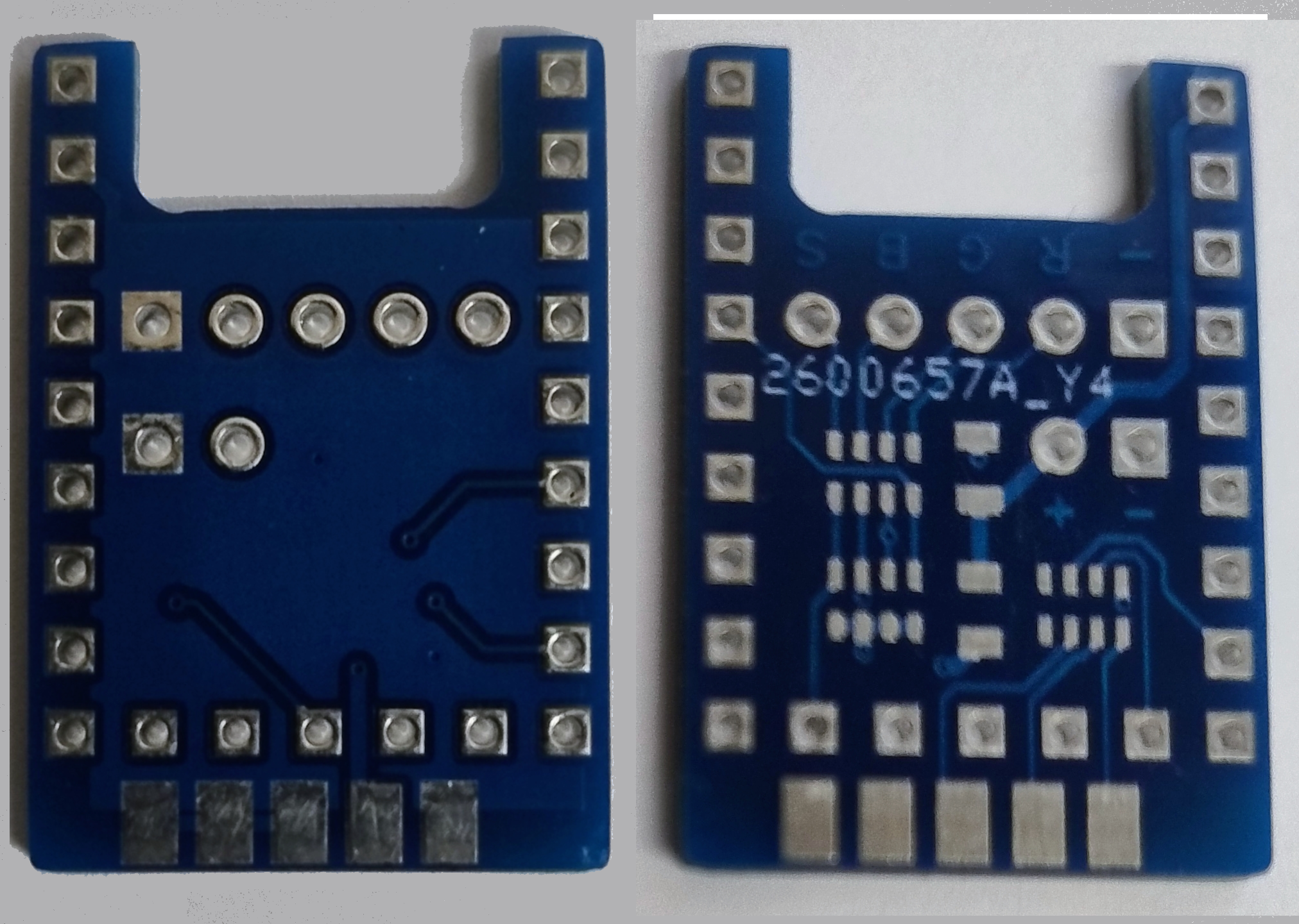

Hi folks,
please find attached Gerbers, schematics and placeplan for my Mini VGA board.

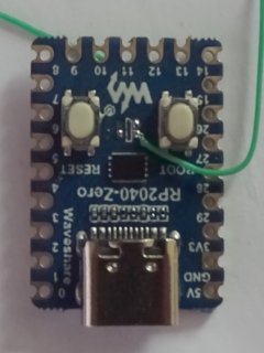

At current stage, the VGA HSYNC and VSYNC lines have to be wired according to the following photos:
GP16 (VGA Pin 13, HSYNC)
GP17 (VGA Pin 14, VSYNC)
Maybe Oliver will provide alternative IO for regular module pins later. When using HD-Sub with solder buckets, and a PCB is thicker than 1mm, it will not fit between the pin rows. (You see that in my previous post). I recommend to file off 0.3 mm of PCB border in that case. Or use HD-Sub with pins.
Good luck!
