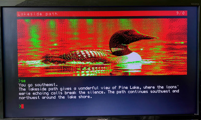

I'm happy to report that my QL resurrection has been a success! I have one working floppy drive (which is strictly off-limits to my old disks, which finally wrecked my other floppy drive, despite lots of head cleaning with cotton buds and IPA). And now having re-felted a number of microdrives, I have finally transferred an old program that I had feared lost forever.

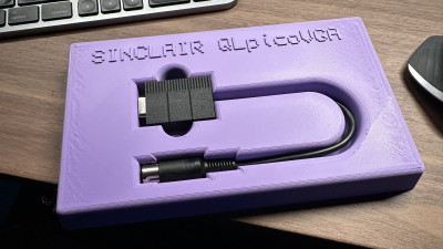

And not only that, Marcel_X's QLpicoVGA was set free from customs and arrived today. Wow - it's so beautifully made and packaged, and it works beautifully too! The screen is so clear and pixel-sharp. What a difference from plugging into my big TV with composite video. Thanks so much Marcel :D

And amazing package!
I wonder how did it with the plastics. Really very very very high quality.
That's a trade secret :-) Nah, just kidding! I got myself a vacuum forming machine and still learning the ins and outs of the machine. So this was a nice opportunity to make something useful. Modelled up a mould for the packaging and could make a few inserts before the mould started to deform due to the heat and vacuum. On Alan's picture you can already see the infill from the 3D model showing up as a rectangular pattern on the top surface. Which is actually not that bad looking!
