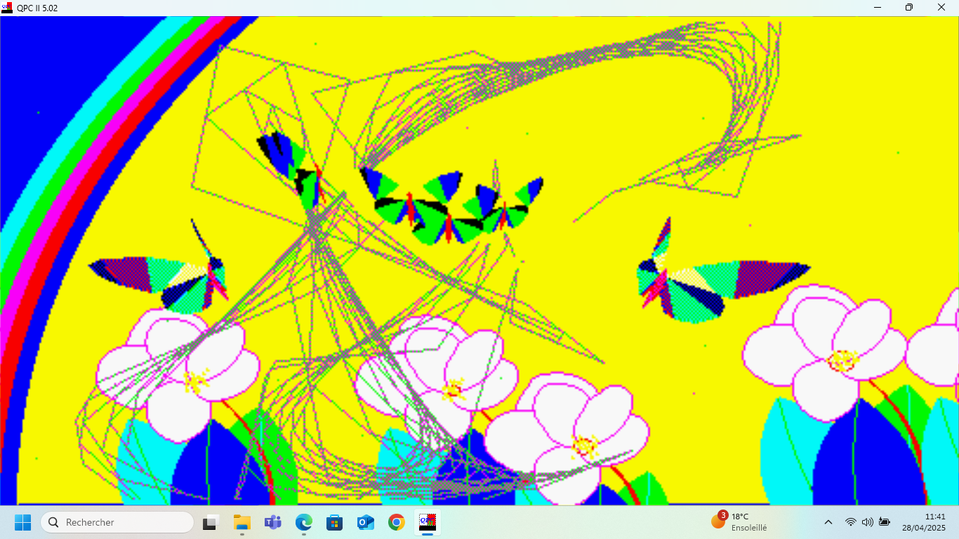

Out of hospital, so here comes Butterfly5_bas... to celebrate my 77th birthday and MayDay ! Steve.

Re: Talent 3D Designer
Hi Martyn,
Glad you like the 3D series of prototype perspective experiments.
I try to keep the code of eacj version constant, so that if anyone does try to see how the code works, it will little change.
The bits that do change , are the few data lines to define the drawings, and some tweaks for animation.
The 3D perspective viewer and the morphing cores hardly change at all. So hopefully, others may be able to do some animations too ?
I have plenty of projects in hand, and thanks to the skill of my surgeon, will be able to continue exploring the subject ! Steve.
