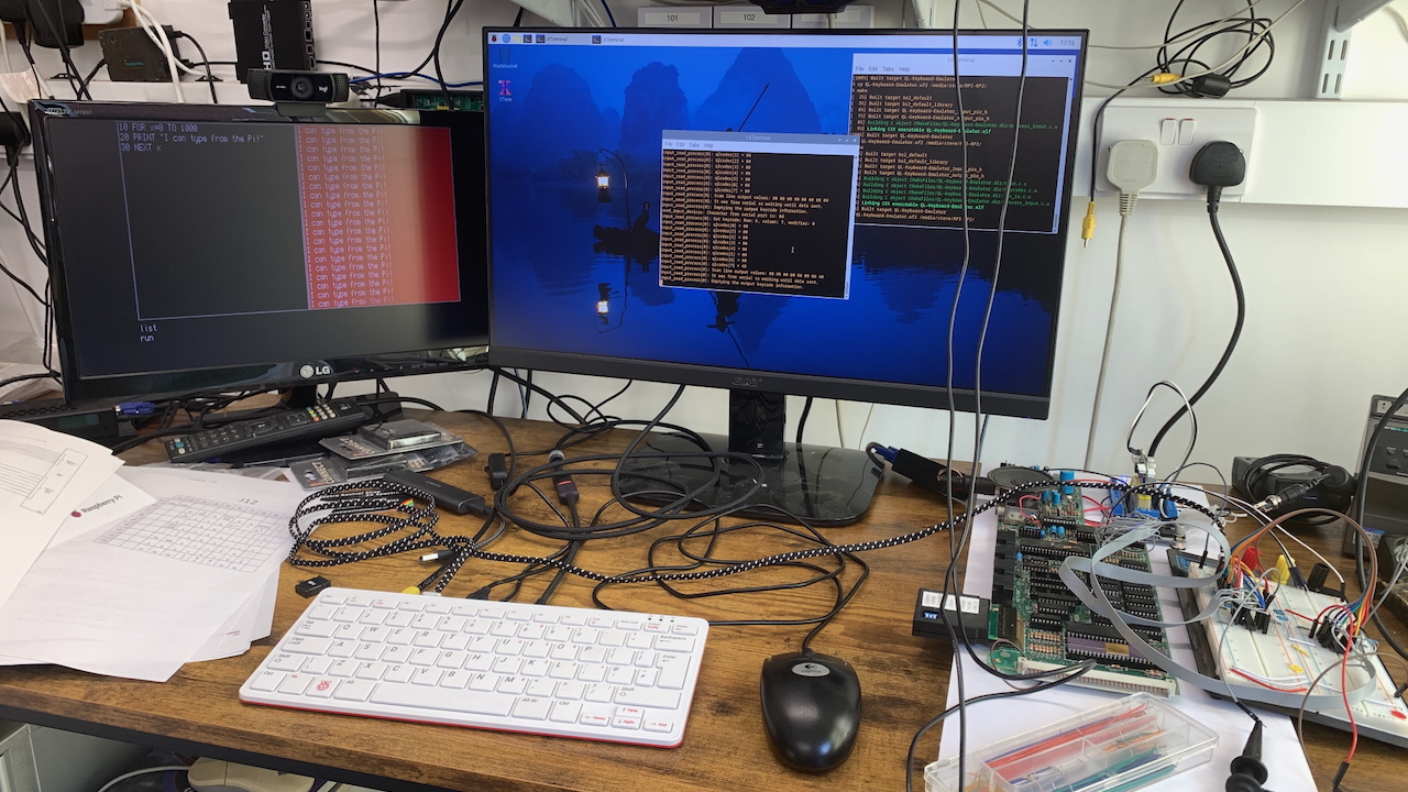

Over the last week I've been working upon a way of talking to a bare BBQL motherboard from another system.
Well, as of today I can do so with a prototype system...

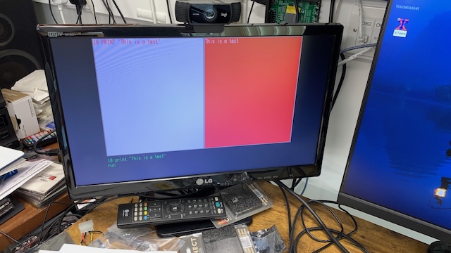

Currently I can plug the Pi400 into the PIco's USB port and use minicom so that I can type on the machine as if I'm using the keyboard, well, other than no ALT key as there's no way that ASCII can translate to that really.

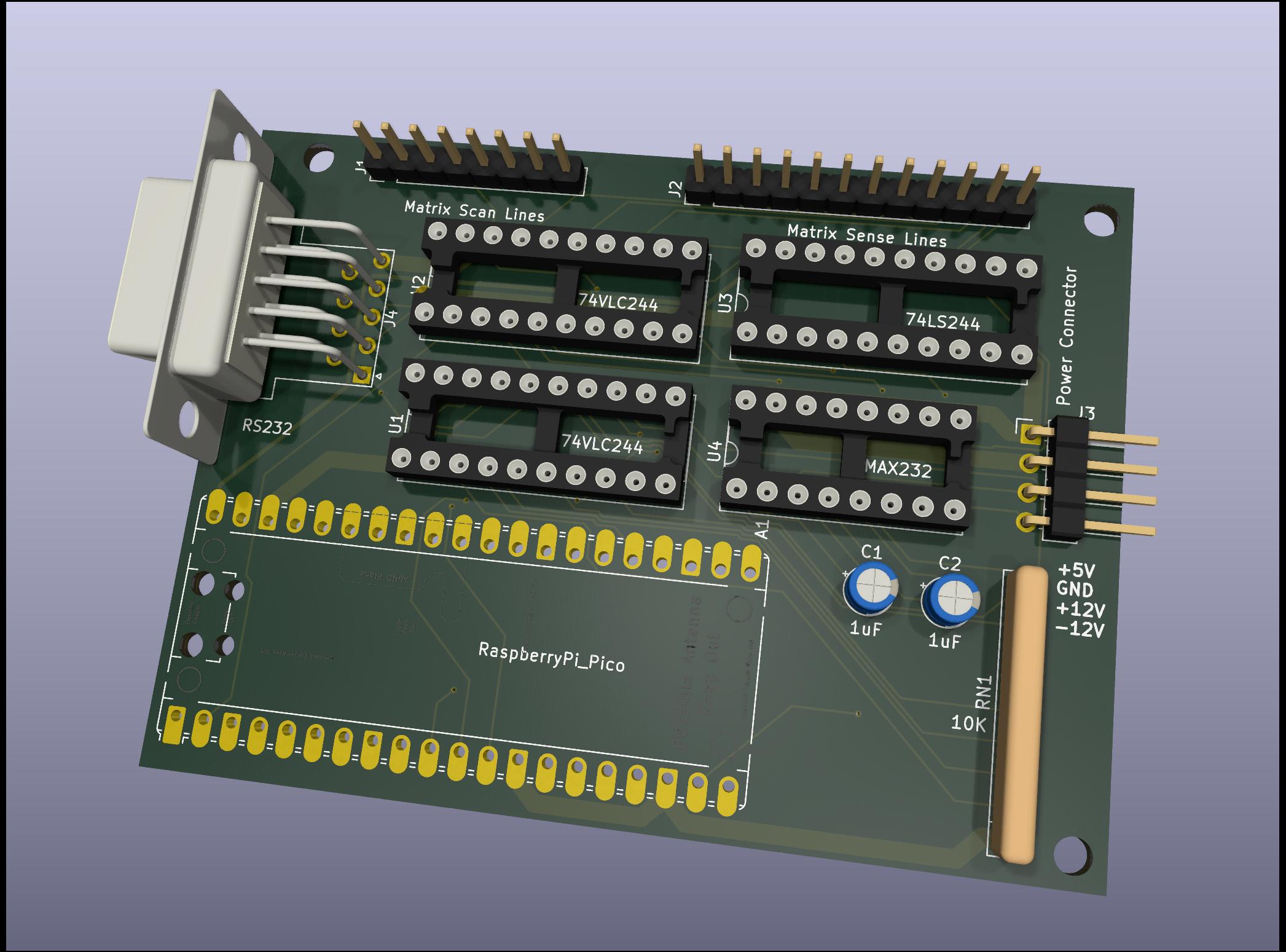

Anyway, I've designed a more generalised PCB (which can handle up to 12 sense lines) which also adds an RS232 port. Once I can move stdio over RS232 then I can develop the USB HID code to allow the use of USB keyboards and do away with an extra machine.

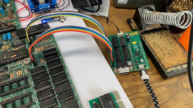

The boards arrived just after lunch, so I quickly built one up. Just a minor issue with the DB9 sockets I bought overlapping one of the header positions, but nothing a pair of wire cutters couldn't fix.
The good news is that it works at least as well as the breadboard version so far. I've not tested the RS232.

And the RS232 works... though when the board is powered by the PicoATX power supply the 74LS244 didn't get power as it seems that the Pico doesn't power the VBUS line if powered by VSYS, so a bodge wire was necessary.

The serial port is there mainly so that I can debug the USB HID (keyboard and maybe joystick) support via the Pico's USB interface. It's also a neat use case of controlling a QL remotely... :-)
As for why the Pico? I'm more comfortable with the programming in C with dual core and accelerated programmed I/O. One ARM core purely deals with the QL side of things and the other purely the input. As it is the Pico is just about keeping up with the IPC's scans in this configuration.
The board is also not only for the QL potentially, which is why I added an extra four output lines. I can use this board for other systems which have a larger number of sense lines. It can also double as a useful generic Pico interface board with 8 inputs and 12 outputs.

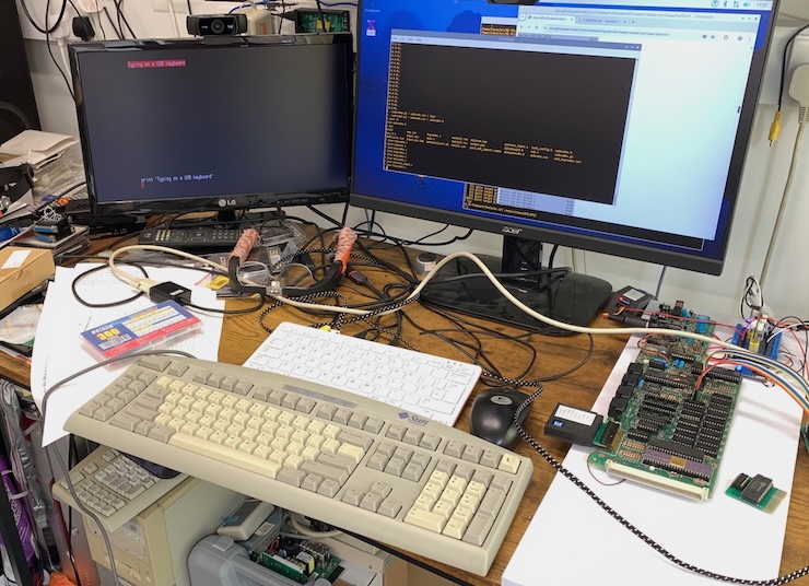

Using some example USB keyboard code I found on Github I've managed to get a USB keyboard mostly working.
Autorepeat isn't working and there is some key bounce, which could be being caused by the same thing.
More worryingly, however, with the keyboard plugged into the Pico I'm getting random memory corruption on the QL. I don't know how this is happening as the Pico board and the QL are independently powered by the same PicoATX power supply which should have ample oomph to power everything on the +5V rail and have about 100 watts to spare.

And all fixed!
