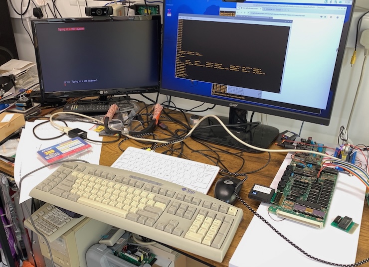

Over the last week I've been working upon a way of talking to a bare BBQL motherboard from another system.
Well, as of today I can do so with a prototype system...
Currently I can plug the Pi400 into the PIco's USB port and use minicom so that I can type on the machine as if I'm using the keyboard, well, other than no ALT key as there's no way that ASCII can translate to that really.
The QL's matrix is effectively just 8 scan lines and 8 sense lines. The Shift, Ctrl and Alt keys map into sense line 7.
One problem I had was that the matrix diagram I had to map the matrix to keys was wrong. It had 1 and 3 transposed, similarly 9 and o.
The other thing to note is that to enable one of the modifier keys you first have to enable them on their own before ORing them with the key code data.
Anyway, I've designed a more generalised PCB (which can handle up to 12 sense lines) which also adds an RS232 port. Once I can move stdio over RS232 then I can develop the USB HID code to allow the use of USB keyboards and do away with an extra machine.
Hopefully the PCBs will arrive around the end of the week and I can move away from the RatsNest(tm).

The boards arrived just after lunch, so I quickly built one up. Just a minor issue with the DB9 sockets I bought overlapping one of the header positions, but nothing a pair of wire cutters couldn't fix.
The good news is that it works at least as well as the breadboard version so far. I've not tested the RS232.
- Posts: 596
- Location: Oxford, UK.
Re: Pico based serial/USB keyboard membrane emulator.
And the RS232 works... though when the board is powered by the PicoATX power supply the 74LS244 didn't get power as it seems that the Pico doesn't power the VBUS line if powered by VSYS, so a bodge wire was necessary.

Using some example USB keyboard code I found on Github I've managed to get a USB keyboard mostly working.
Autorepeat isn't working and there is some key bounce, which could be being caused by the same thing.
More worryingly, however, with the keyboard plugged into the Pico I'm getting random memory corruption on the QL. I don't know how this is happening as the Pico board and the QL are independently powered by the same PicoATX power supply which should have ample oomph to power everything on the +5V rail and have about 100 watts to spare.

And all fixed!
https://youtu.be/eKsEGuwRFOQ?si=gRmY12IxoGUb2Pni
Once I've cleaned up the code I can post all of this on Github.
Adding replacement software for different machines shouldn't be too difficult using the QL code as a basis. It'll be mostly the translation code which would need to be changed.
