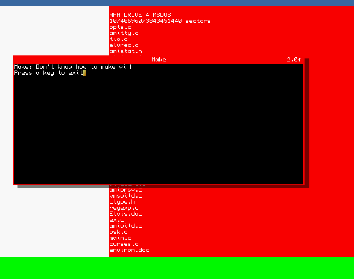

The problem raised itself when I was trying to compile Elivis v1.16 using make.
I store the Elivis file on a Linux share access from SMSQmulator, by Native File Access: NFA4_
Then running C68 MAKE on the makefile gives an error: Don't know how to make vi_h, when the file is vi.h: Changing the file to vi_h all is fine and make compiles the source code.
Using XTC68, which is the same compiler, compiles the source okay. This only appears in QL Make.

Use the filesystem type in sqlux.ini as qdos-like.
That enables filename translations on the fly!

Hi,XorA wrote: Wed Jan 17, 2024 4:53 pm Use the filesystem type in sqlux.ini as qdos-like.
Thank you for the information, mapping a QDOS device to a native file directory, with qdos-like, does convert the "." extension separator to "_"
To cmpile this in a QWA container, or QDOS environment, I compressed the C source files and extracted them to a QDOS environment, with infoUnzip v5.40, this also converted the separators and the C files could be compiled.
I am not sure if cross-compiling is better than compiling in a QL filesystem.
