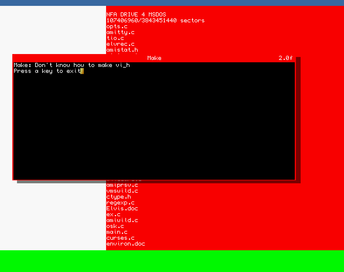

The problem raised itself when I was trying to compile Elivis v1.16 using make.
I store the Elivis file on a Linux share access from SMSQmulator, by Native File Access: NFA4_
Then running C68 MAKE on the makefile gives an error: Don't know how to make vi_h, when the file is vi.h:
Changing the file to vi_h all is fine and make compiles the source code.
Using XTC68, which is the same compiler, compiles the source okay. This only appears in QL Make.
Posts: 1647
Re: C68 Source Compiling
Use the filesystem type in sqlux.ini as qdos-like.
That enables filename translations on the fly!
Posts: 4762
XorA wrote: Wed Jan 17, 2024 4:53 pm Use the filesystem type in sqlux.ini as qdos-like.
Thank you for the information, mapping a QDOS device to a native file directory, with qdos-like, does convert the "." extension separator to "_"
To cmpile this in a QWA container, or QDOS environment, I compressed the C source files and extracted them to a QDOS environment, with infoUnzip v5.40, this also converted the separators and the C files could be compiled.
I am not sure if cross-compiling is better than compiling in a QL filesystem.
