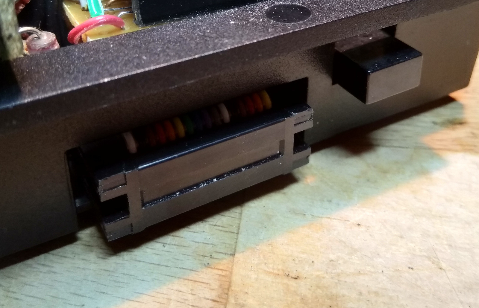

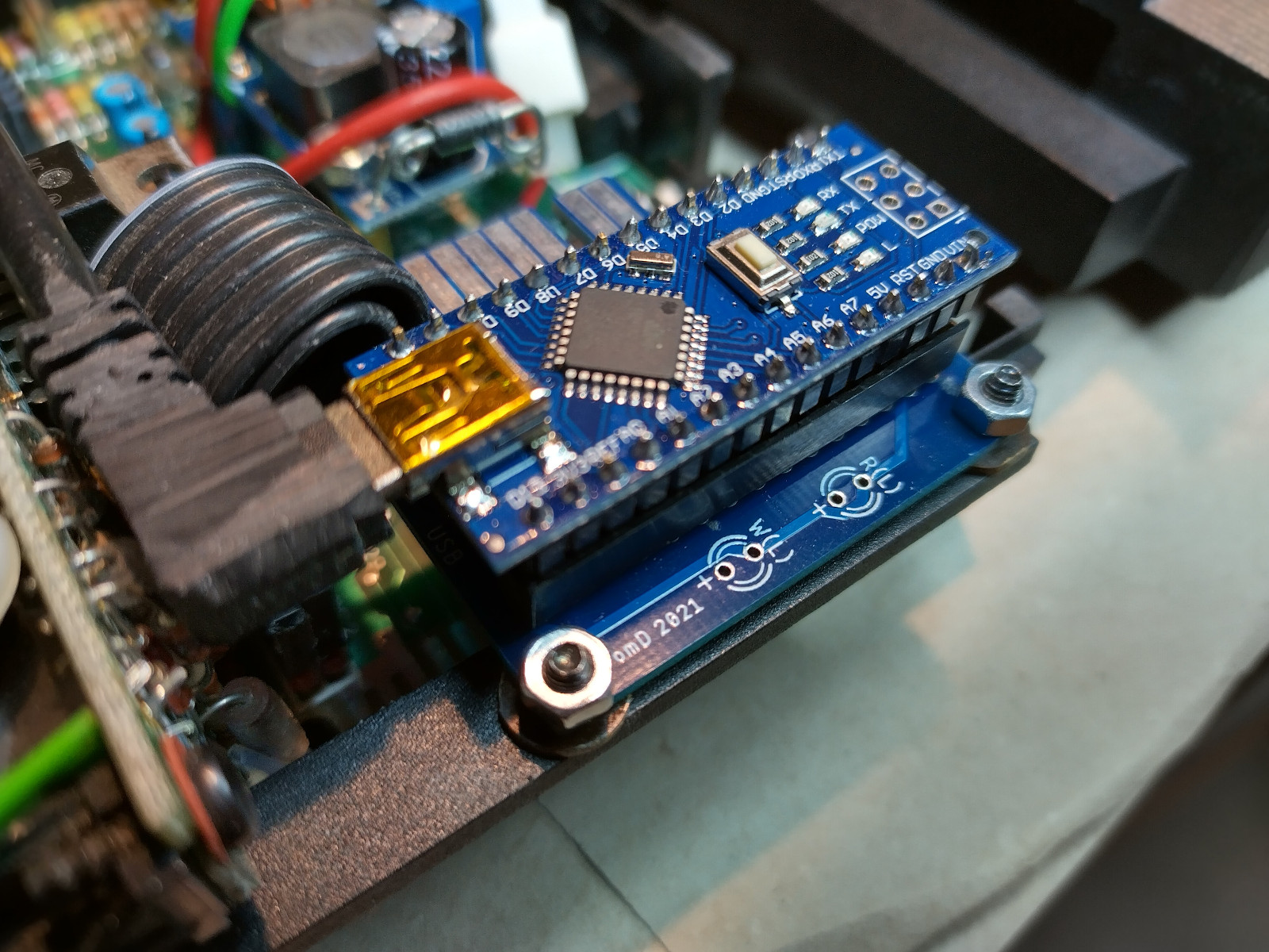

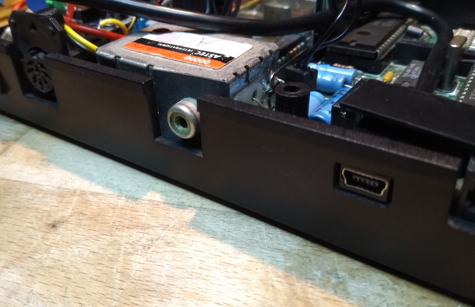

I've put an OqtaDrive inside my Issue 5 QL, using Tom Dalby's μPCB 1.0, with minor modifications. Due to the tight space, I had to shave off one corner. Note that a prerequisite for this build though is to replace the original 5V linear power regulator and its massive heat sink with a small bucket converter, to free up enough space.
I wanted to put OqtaDrive inside the QL because an external adapter can only act as drives 3 through 8, but I wanted to take advantage of OqtaDrive's hardware drive mapping also on my QL. The adapter still hooks up to the Microdrive port, except for the COMM signal which is directly taken from the PCB connector of internal drive 1 (pin 1). Drive 1 then gets COMM from COMM_OUT of the OqtaDrive adapter, i.e. the OqtaDrive adapter is now first in chain. This way I can freely move the internal drives, or completely disable them.

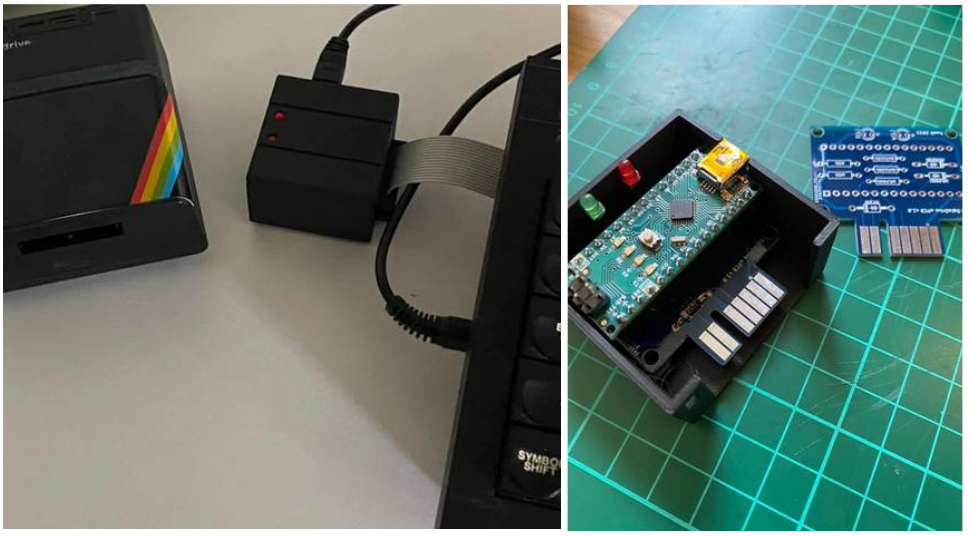

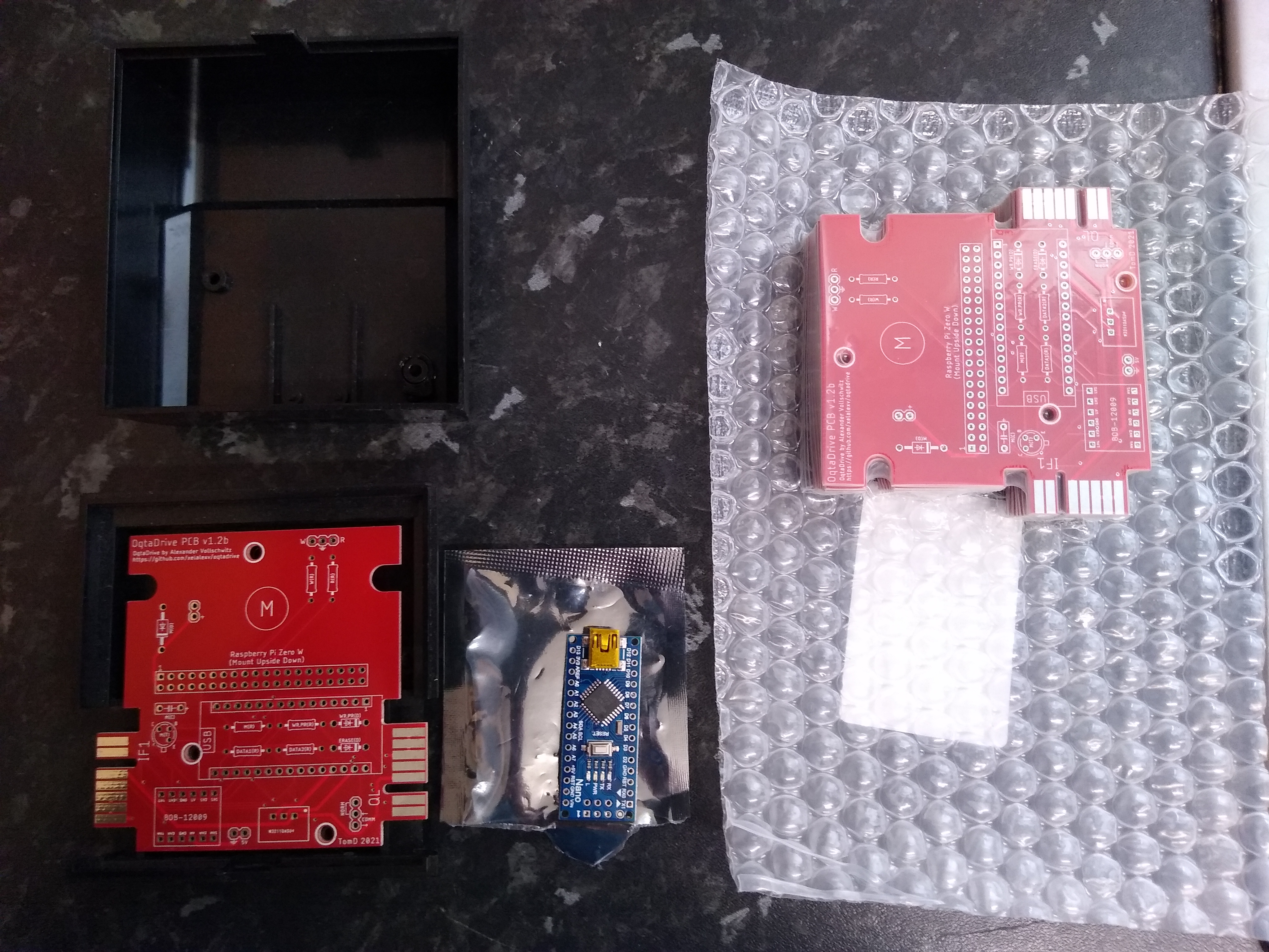

I have 10 OqtaDrive PCBs to make, just trying to make time.
I only have ZX Microdrive cases to house the Oqtadrive, but if I had a 3D Printer maybe better case would do.
I also need to see if the Oqtadrive will work with the vDriveQL.
There is also a shortage of the PI Zero W, which should be in stock in the next few months. Just need extra components
