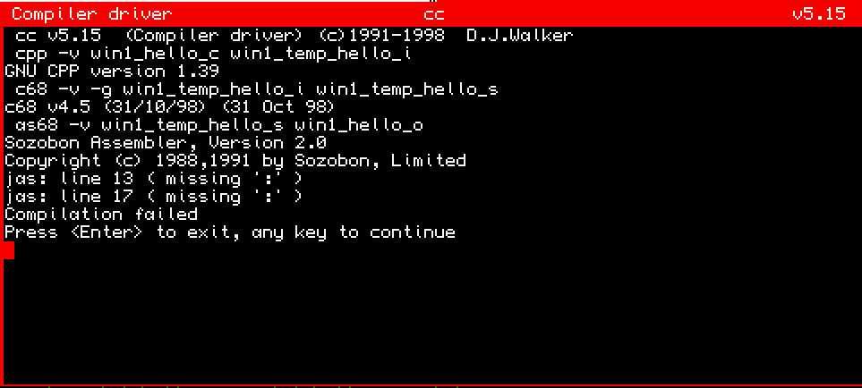

I tried to compile a simple Hello_World programme in C68 with:
EX cc;'-v -g win1_hello_world_c -o win1_hello_world_exe -lm'
which gave some error messages:
C68 -g debug error
C68 -g debug error
C68 Debug.png (6.33 KiB) Viewed 1982 times
Removing the -g from the command line:
the programme compiles and linked perfectly.
Is the Debug information for C68 created correctly or is it work in progress.
Needles to say GNU GDB v11 does not recognise a QL exectutable.
Posts: 2483
Re: GNU GDB
Hi derek,
looking at the C68 docs, I see this for the -g option:
-g [C68] Produce debugging information. Currently this has little effect in C68. It does, however cancel any -O option if that is also specified.
So it looks like there's a problem with that option reaching the assembler. You can, if you want to check the error in the lines mentioned, pass the -S option, the docs mention:
-S [CC] Stop after the C68 compilation phase. This will produce a file (ending in _s) which has
the assembler source produced by the compiler. Normally this is input into the AS68
assembler phase to produce the object (_o) file.
That will keep the assembler source files with the problem lines within. I suspect however, that there's no point building a debug version with the -g option. I suspect the best you will get is the use of libDebug in your programs. I've attached the C68 docs which has a section on using libDebug for your entertainment. Hope it helps.

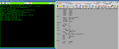

I added the -S option to the command line for the CC command string, which gave the error as shown above, I looked in the _s file, to see what the error messages are pointing towards:
C68 QD-DEBUB aseembler file
the JAS messages point to the ".line " entries on lines 13, 17, 20
NOt sure what is happening here, back to the manuals I fear.

Posts: 3112
Re: GNU GDB
Derek,
the Sozobon assembler jas which is normally used by C68 to translate the _a files to _o files simply doesn't understand the
.line
directive. I guess it was planned to replace it with the GNU assembler, which does (at least, used to) support this directive. But that never happened, apparently.
