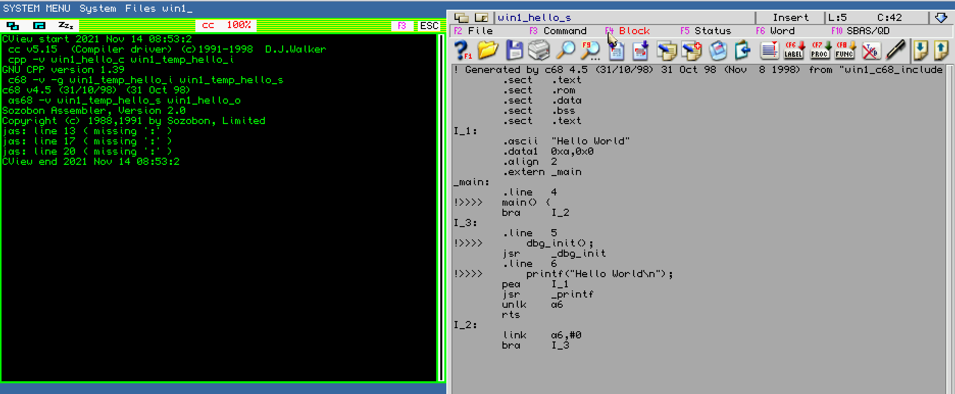

I tried to compile a simple Hello_World programme in C68 with:
which gave some error messages:
Removing the -g from the command line:
the programme compiles and linked perfectly.
Is the Debug information for C68 created correctly or is it work in progress.
EX cc;'-v -g win1_hello_world_c -o win1_hello_world_exe -lm'

- Posts: 4859
Re: GNU GDB
I added the -S option to the command line for the CC command string, which gave the error as shown above, I looked in the _s file, to see what the error messages are pointing towards: the JAS messages point to the ".line " entries on lines 13, 17, 20
NOt sure what is happening here, back to the manuals I fear.
I also use CVIEW to compile single C68 files, to see the compile messages.
Re: GNU GDB
Derek,
the Sozobon assembler jas which is normally used by C68 to translate the _a files to _o files simply doesn't understand the directive. I guess it was planned to replace it with the GNU assembler, which does (at least, used to) support this directive. But that never happened, apparently.
.line
