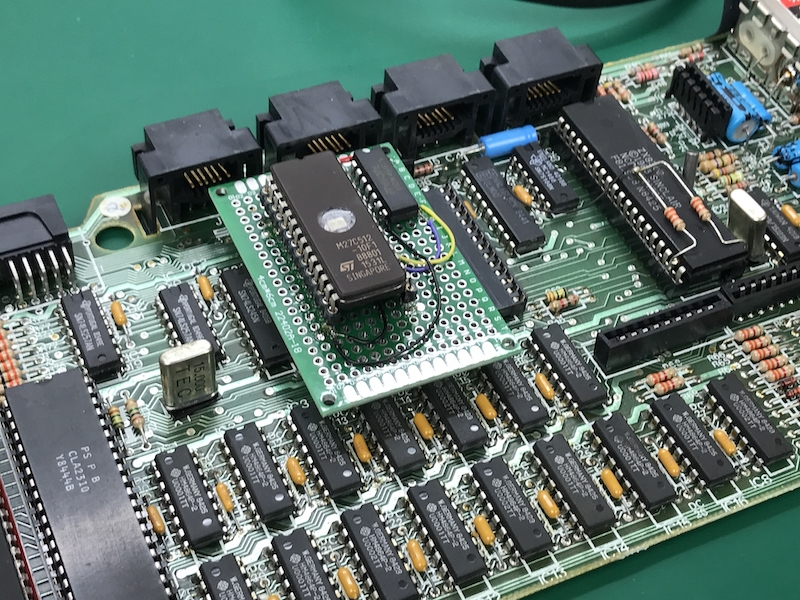

I'm repairing two QLs at the moment (bear with me, I'm very new to the QL). An Issue 5 and an Issue 6. Both of them show that dot pattern (RAM test I imagine) and one of them ends in a white screen and the other one in a green screen.
From what I read, that looks like a likely RAM issue. Since nothing was warming up and the busses looked fine, I decided to put the Minerva ROM because I read it also does a RAM test but actually prints information about failing chips if it detects any.
I ended up making a quick adaptor to put in a 27C512 with the Minerva ROM.
In the Issue 5 with green screen, it reports some numbers (I still need to figure out how to map those back to ICs) for about 20 seconds, then it does the RAM test again all by itself and it looks like starts up. Is that the expected behavior? Weird that it can get that far with RAM problems.
The weird thing comes from the other board. I popped in the same Minerva ROM and... it just starts up correctly. Doesn't report any errors! Does that mean that the problem was with the original ROM then? That's a bit strange, although I suppose the test could also include a ROM checksum in addition to a RAM test. Anyone knows if that's the case?

All right, just a quick test: I moved the ROMs in the Issue 5 to the Issue 6 board and... same thing. Dot pattern and then white screen. So it's not the ROMs!
Just for grins I'm planning on burning a 27C512 EPROM with the ROMs that came in that computer and trying it. I don't expect it to work now though. It really feels like a RAM issue that Minerva is not detecting from my limited knowledge!
Oh I just realized something (which I'll confirm as soon as I fix the Issue 5 board): When Minerva starts up it says 64K on the bottom left corner. I suspect it should say 128K, right? So maybe the RAM is so bad that Minerva simply thinks there are only 64K and doesn't actually test the rest. If that's the case, what's likely to be faulty? How does the QL go about finding the maximum amount of available RAM? On the ZX Spectrum we used to write to an address and read back from it to see if that existed to detect 48K vs 16K.

Right. I seem to have confirmed my own theory: Once I repaired the faulty RAM IC on the Issue 5, Minerva starts up and reports 128K!
I'm off to find what could cause that. The multiplexors before the DRAM seem like a reasonable candidate. Or I suppose even the ULA that seems to be involved in memory mapping could cause that...

OK, replying to myself just in case someone else is interested in the future. All of this will be documented in a video I'll release probably next week anyway.
I was reading through the Minerva manual and it talks about starting the RAM test in different places and to try doing a reset a few times to get all the possibilities. So I tried that, and once every 10-15 times, it reports an error!
It turns out this error is at address 0x30000, which is a suspiciously round number. I wonder if that's the address that it writes to to detect the upper RAM? Completely guessing here. Anyway, that bit patter in that address apparently corresponds to IC15. I replaced it without much hope and... it turns out now it works reliably!
I'm glad but it's surprising that Minerva manages to confuse RAM errors with missing RAM. Oh well. I learned a lot along the way. Thanks again for your input! It was very useful.
