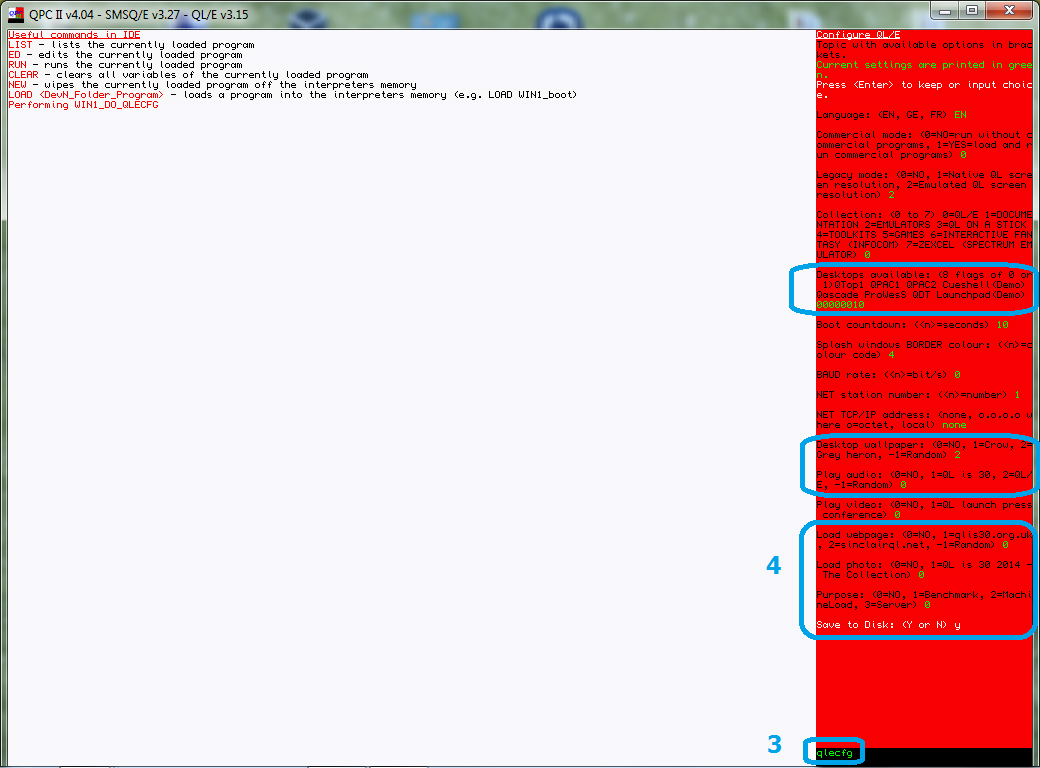

Look,
1 - once you've started QL/E, press <ESC> during the countdown,
2 - enter IDE followed by the <ENTER> key, this sets up larger windows for better reading,
3 - enter QLECFG followed by the <ENTER> key,
4 - change the relevant config items of the QL/E configuration, save it, then
5 - reboot QL/E and you're done.
For steps 3 and 4 I've attached a screenshot.
For step 5 I've attached a screenshot in the related thread.
QL forever!
Urs
P.S. I think about making QLECFG even more verbose for the next release.
I call it a simple 1-2-3-4-5.Derek_Stewart wrote: It looks a little complicated.
Look,
QL forever!
Urs

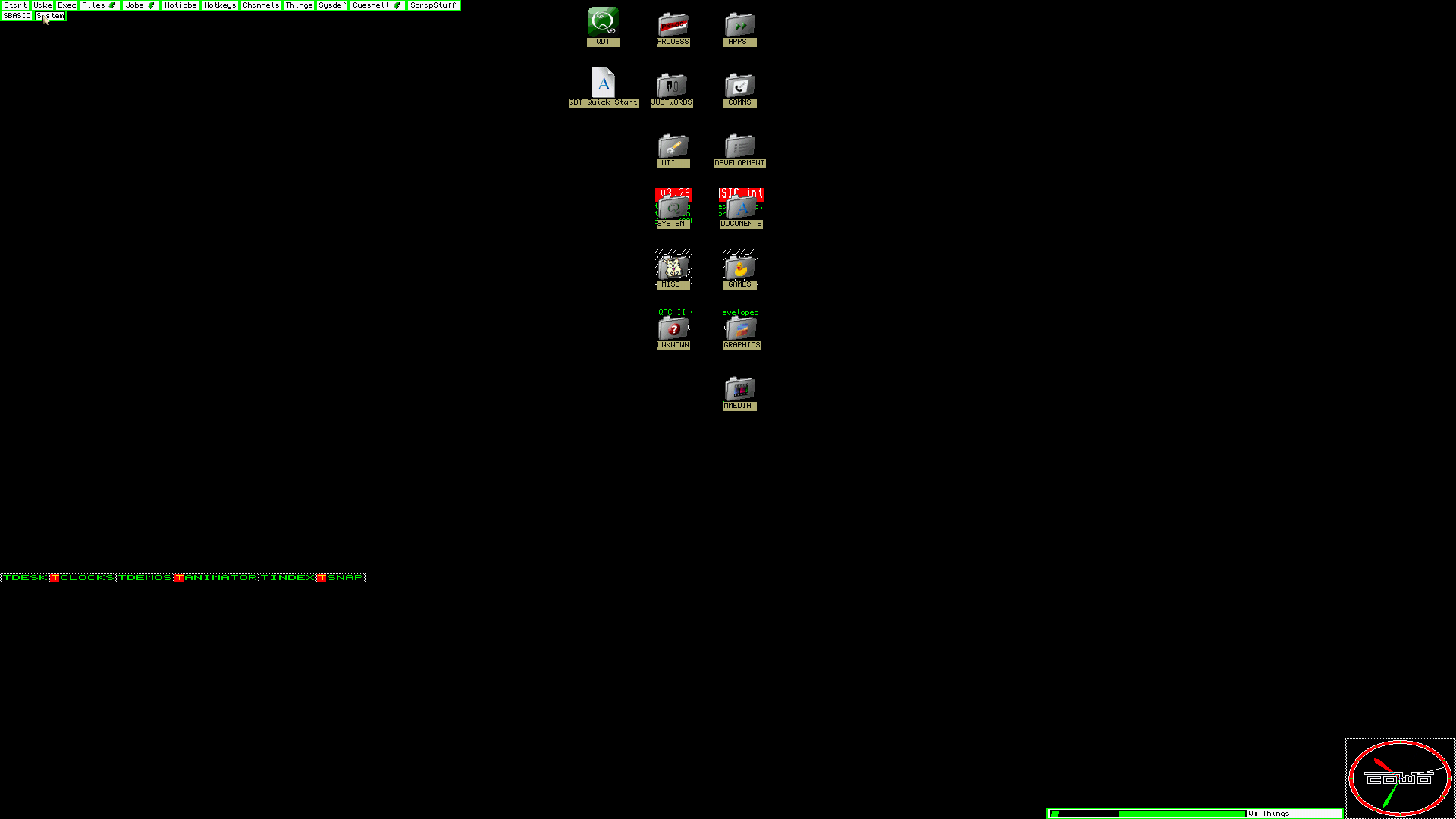

I tried to follow your instructions and found I had an out of date version of QLE, I have downloaded a the current version.
I have another question, when I run QPC2 on my laptop at maximum resolution: 1920x180 and loading all the QLE applictions, I get this desktop:
Is there any way to make the QTOP items locate at the bottom of the screen at any resolution.

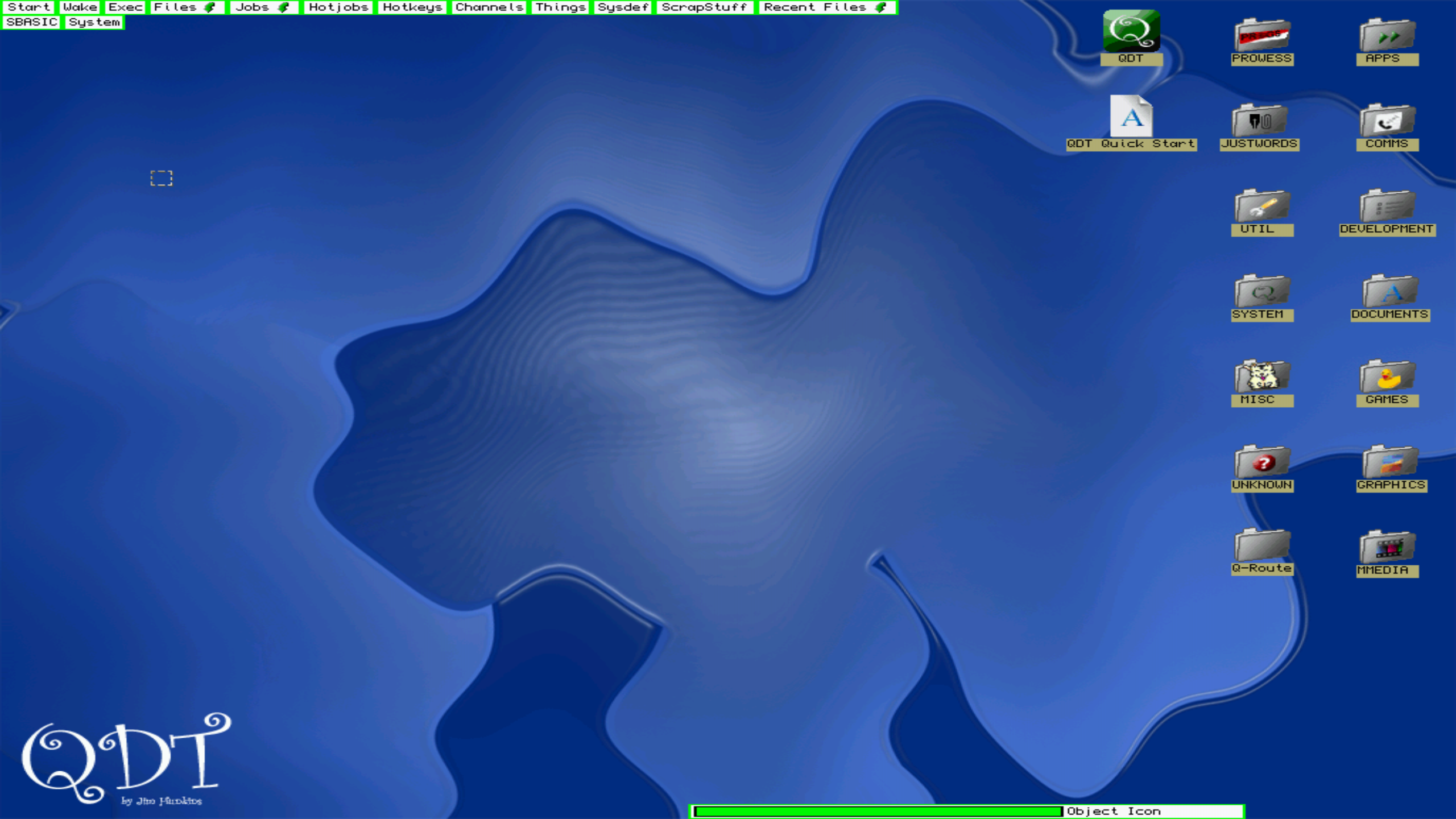

Looks good.Derek_Stewart wrote:I have another question, when I run QPC2 on my laptop at maximum resolution: 1920x180 and loading all the QLE applictions, I get this desktop:
The analogue clock is self-positioning on the bottom right corner of the screen using this statement in the BOOT program:Derek_Stewart wrote:Is there any way to make the QTOP items locate at the bottom of the screen at any resolution.
12063 IF SCR_XLIM>512 : IF QLE_desktops$(cDT1_QTop1%)="1" : IF FREE_MEM>QLE_freememquota : EX TCLOCKS;"con_146x107a"&(SCR_XLIM-146)&"x"&(SCR_YLIM-107)&"\ROLEX" : REMark QTop-Clock by UK (Rolex-style fingers mode), bottom right
1 - Wake the TDESK button, best using pressing the <ALT>+<t> key combination
2 - Press the <F9> key to enter re-position mode
3 - Move the button window to the desired position, then press the <ENTER> key
4 - Open QTop-Desk, best using pressing the <ENTER> key on the active TDESK button
5 - Once QTop-Desk is ready for input, enter the OPTIONS menu and invoke the SAVE OPTS menu entry
The next reboot will use the new QTop-DESK (TDESK) button position as base for all QTop buttons.
Enjoy exploring QL/E.
QL forever!
Urs
QL forever!

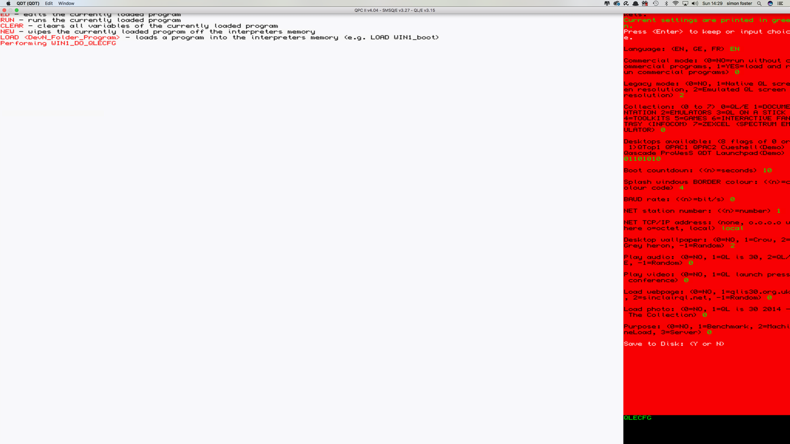

An Update to my QCECFG Post
Here are two screen shots one of the Desktop and one of the QLECFG that what I have done OK Thanks Simon Foster
