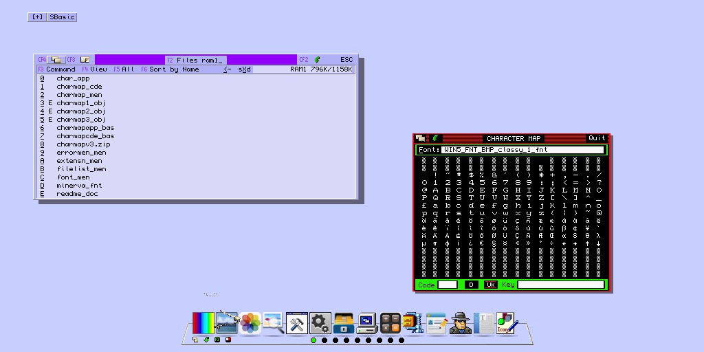

Charmap - The Final version
now everything works!
charmap.zip
(116.65 KiB) Downloaded 223 times
Yes it does. Have run it on my Q68. Great I have been thinking or writing something similar myself but there is no need now.

Artificier posted:- Have run it on my Q68
Attractive setup. I assume your screen shot is not of your Q68. Is it SMSQ/E on a PC or something else? Would you be willing to post your BOOT file or better still a win_ file of your setup?
