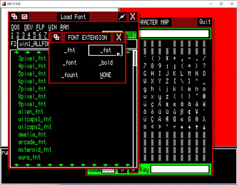

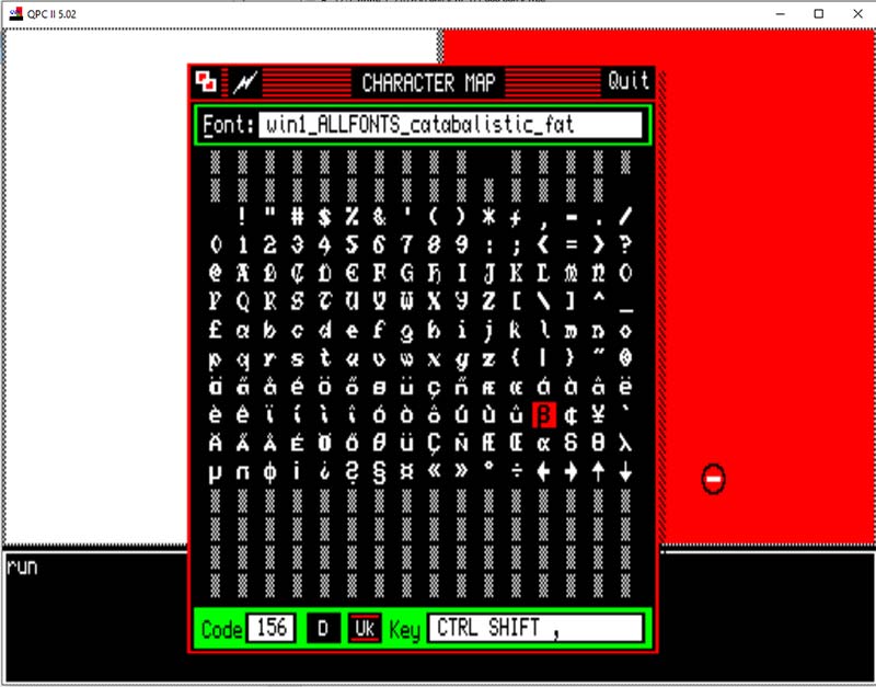

My first PE program is almost ready. I have attached the source code in the zip file.
Almost because:
- it runs perfectly in BASIC
- it took 2 minutes to compile it with QLIBERATOR and works, as long as I load the _men from disk
- spent 2 days to embed the _men files in the _obj and failed miserably! I read the manual 100 times and I still do not understand how to use APPMAN. I tried to create the Extension+Appendix - created several ... Program compiles but crashes on run. I have no idea what I am doing wrong. :( :( :(
Please explain me how to use APPMAN and what (and how) must I create there - to compile succesfully with QLiberator.
Later Edit: attachement removed - download final version here viewtopic.php?p=45034#p45034

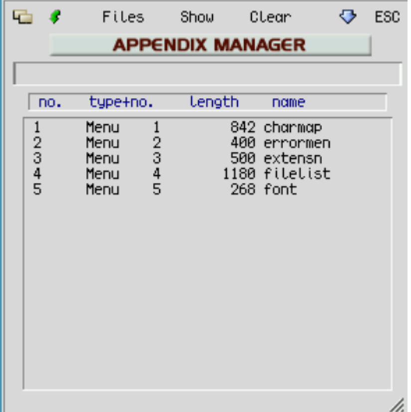

Yep, appman is a bit awkward to handle, but still very useful. Small Recipe:
  • Open appman
  • Add your menus ("load"->"Menu", assign some proper names (last column). Your Window should look like this:
  • Save as an extension (Set "Command" to "APPA0", which should be the default, then save as an appendix (e.g. "charmap_app", FILES->SAVE->APPENDIX). Don't try and mess with the "append" option or something - That's a bit of a nuisance in compiled programs, IMHO.
  • LRESPR the app file you made to check it.
  • PRINT appa0('charmap') (Or whatever you called a menu in the app file) must return a reasonable value. x = FOPEN ("con") : MDRAW #x,APPA0("charmap") must display the menu - otherwise, repeat previous steps until you succeed.
  • Up to here, you got it working in S*BASIC. Now you need to be able to use it in a compiled program. This is what I do with Turbo: "200 REMark %%dos2_charmap_app,0,60". For liberated programs, you would probably use something like 400 REMark $$asmb=win1_dev_charmap_app0_app,0,60 (The 60 works for me, but may depend on your appman version. In case 60 doesn't work, provide your _app file for analysis, please)
Hope this helps!

tofro wrote:Yep, appman is a bit awkward to handle, but still very useful. Small Recipe:
  • Open appman
  • Add your menus ("load"->"Menu", assign some proper names (last column). Your Window should look like this: APPMAN0.png
Hope this helps!
Done! And I still get the same errors when I run the compiled program...
