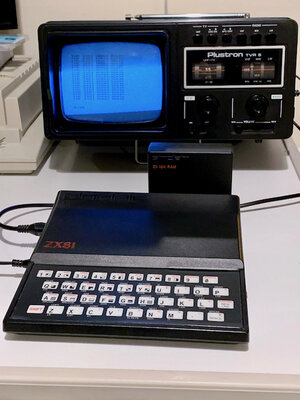

OK, I've got it working with the original ULA.
When I reseated the CPU last night I didn't notice that the /RD pin wasn't in the socket! I'm amazed that the machine worked at all!
P.S. The vLA81 still doesn't work so I'll have to contact Charles.
P.P.S. The keyboard membrane has finally failed too much to trim. I'll have to try to find the replacement I put into a "Safe" place, where ever that is!

Post by stephen_usher »
I managed to have a chat with Charles on Facebook and after a test he asked me to do it's confirmed that the CPLD is dead.
Anyway, it's alive with the original ULA...
