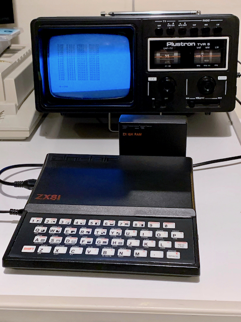

My ZX81's stopped working. :-(

OK, the input to the ULA on pin 35 is not looking good. I can see a small signal but it's hovering around the +5V mark. I wonder if R4 has died. This is supposed to be an 8K pull-down resistor for the clock. The clock on pin 14 is fine.
P.S. It's actually supposed to be 18K (poor scan of the schematics) and that's what it is. Not that removing it makes any difference. Of course, without a reference for how the signal should look it's tricky to determine what's right and wrong.

Ah, but the strange thing is that I'm getting the 'K' cursor but not the frame sync. The data and address buses are seemingly ticking along normally. I'm wondering if it's an interrupt issue.1024MAK wrote:With a original ULA, a white screen often means the Z80 is not running the ROM program (RAM fault, ROM fault or Z80 fault). In this case, you will not get all the proper sync pulses.
Mark
The PIN 14 clock on the ULA is fine, as is the CPU's, which is derived from the same source.

OK, I've got it working with the original ULA.
When I reseated the CPU last night I didn't notice that the /RD pin wasn't in the socket! I'm amazed that the machine worked at all!
P.S. The vLA81 still doesn't work so I'll have to contact Charles.

I managed to have a chat with Charles on Facebook and after a test he asked me to do it's confirmed that the CPLD is dead.
Anyway, it's alive with the original ULA...
