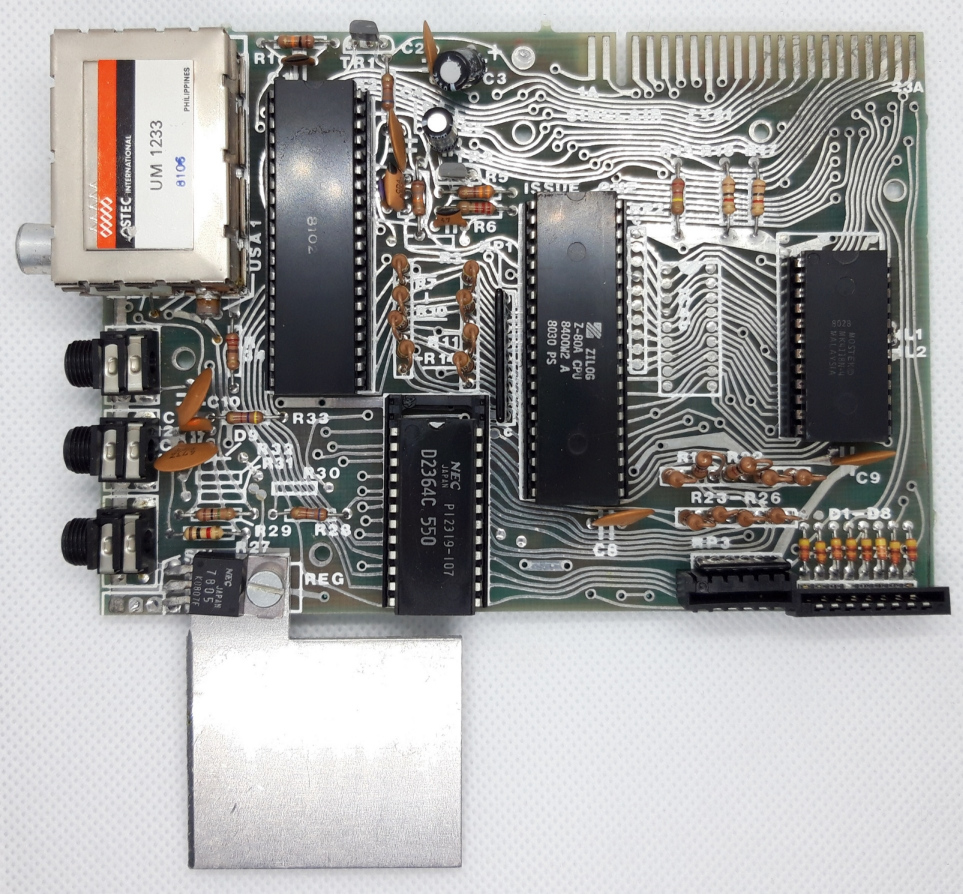

The ZX81 is 40, amazing. I actually have one that is 40 in a couple of weeks - at least the latest chip on it is. I think it's the earliest known ZX81 component-wise. 8102 ULA, 8106 Mod box, 1980 dated Z80 and RAM. And it's in amazing condition too... nothing ever been on the exp port for example. And it came with a ZX80 PSU. Quite proud of that one!
