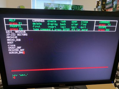

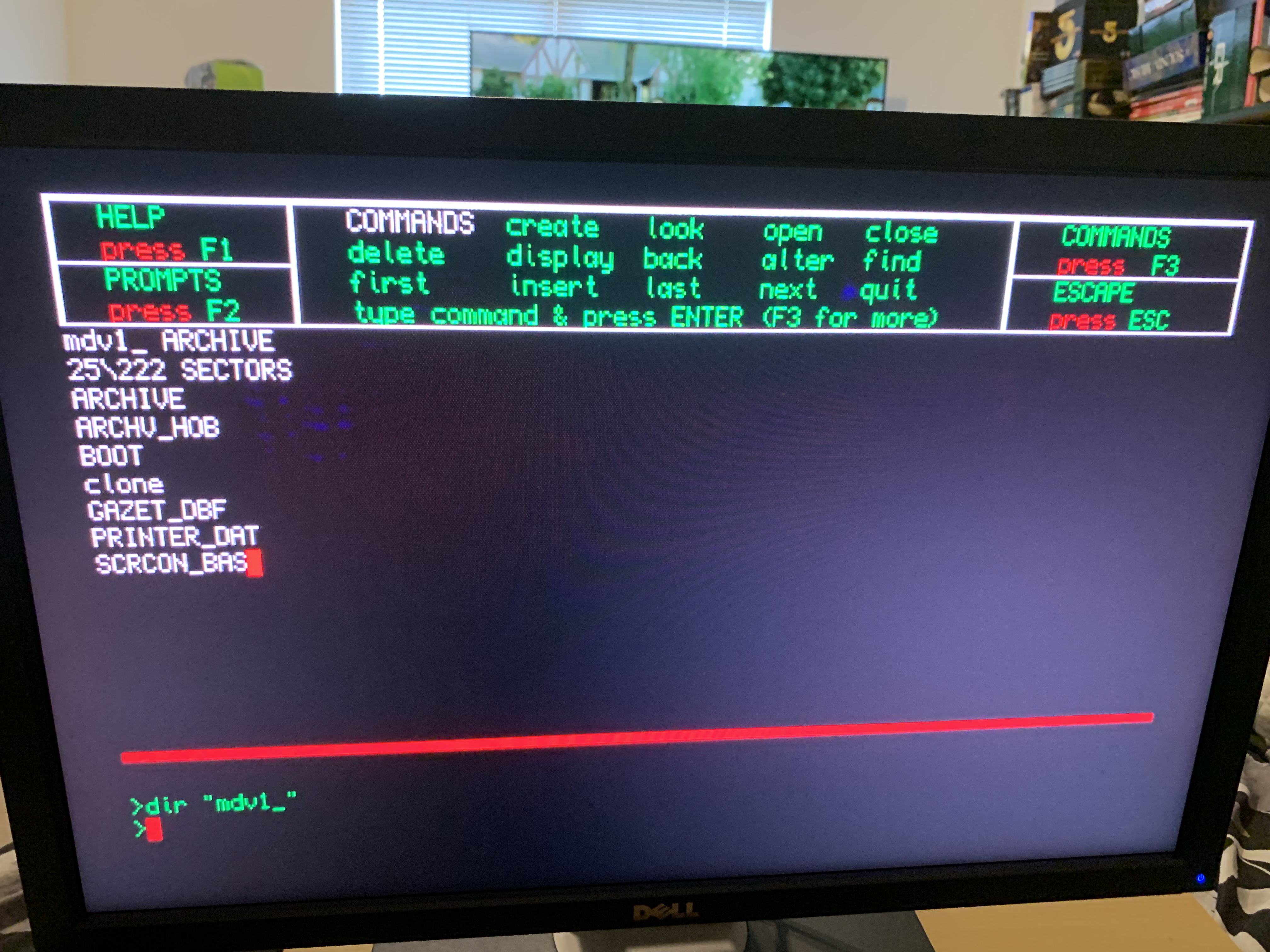

You are correct. I run the SDINIT command which prepares the SD CARD. I have tried multiple cards. The cards get formatted. Then I do MKIMG, which creates a blank image. MKIMG works, where it all fails is when I try to format the new image I created. The red LED comes on (indicating the drive is being accessed ) then the red LED goes out and then I get format failed.

I finally got my Vdrive QL working! It was my Vmap that caused my problems and Charlie is sending me a new one.
