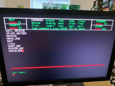

Hi Martyn,
You are correct. I run the SDINIT command which prepares the SD CARD. I have tried multiple cards. The cards get formatted. Then I do MKIMG, which creates a blank image. MKIMG works, where it all fails is when I try to format the new image I created. The red LED comes on (indicating the drive is being accessed ) then the red LED goes out and then I get format failed.
So I am scratching my head. I hope Charlie has some idea
Cheers
Bill

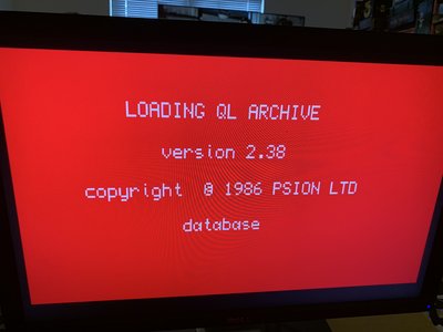

Tada!
I finally got my Vdrive QL working! It was my Vmap that caused my problems and Charlie is sending me a new one.

Thanks Martin. Great explanation. The manual has more detailed info if needed.martyn_hill wrote:Hi Bill!
The fact that you can 'see' the 'VTKQL109' medium listed suggests that the vDrive is being correctly accessed - but as yet, does not recognise the SD Card.
If I recall correctly from the vDrive documentation and my own experience, vDrive will present a 'pseudo' MDV image containing only a boot program and the (optional) vDrive Toolkit with no SD-Card mounted (or recognised.)
If you you have successfully loaded that boot program and the Toolkit, then the QL to MDV interface is working correctly - and all that remains is to review the documentation to check that your SD-Card is initialised correctly. The card initialisation itself is carried out using the utilities commands as contained in that Toolkit.
Good luck - you are almost there!
