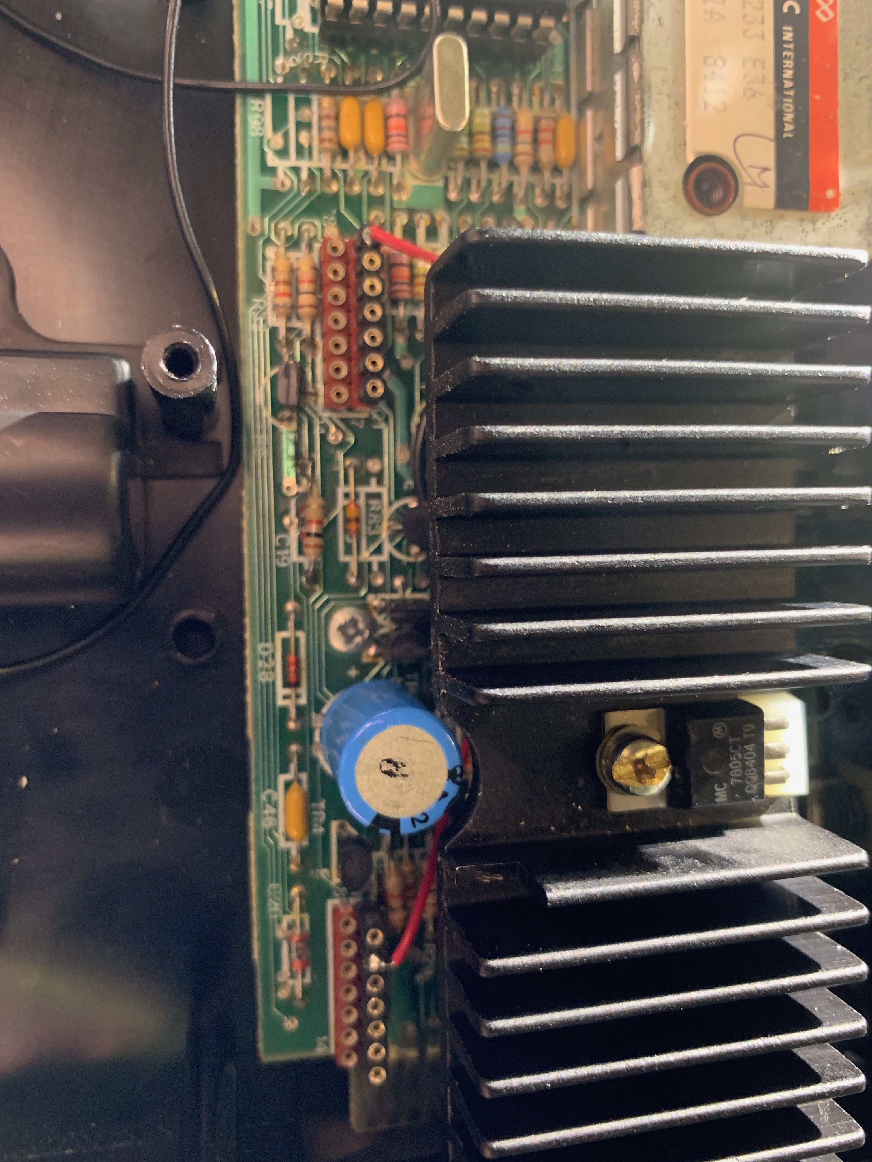

I have been struggling for the past months to get the vDrive working on my QLs - I also tried beating the head against the wall, but it did not helped
Uninstall vMap and the 2 microdrive units then install a strap wire from pin 1 of unit's 1 connector on motherboard to unit's pin 2 (pin 1 is marked on motherboard for both connectors)
This will simply bypass the microdive data to the external connector, where you have attached your vDrive
Now the QL will see your vDrive as mdv1_ and (hopefully) you will be able to access it

Andrew,Andrew wrote: Uninstall vMap and the 2 microdrive units then install a strap wire from pin 1 of unit's 1 connector on motherboard to unit's pin 2 (pin 1 is marked on motherboard for both connectors)
Pin 1 on MDV1 to Pin 2 on MDV2?
Cheers
Bill
Re: Microdrives dont spin or do anything
Yes, exactlyretro_collector wrote: Andrew,
Cheers
Bill

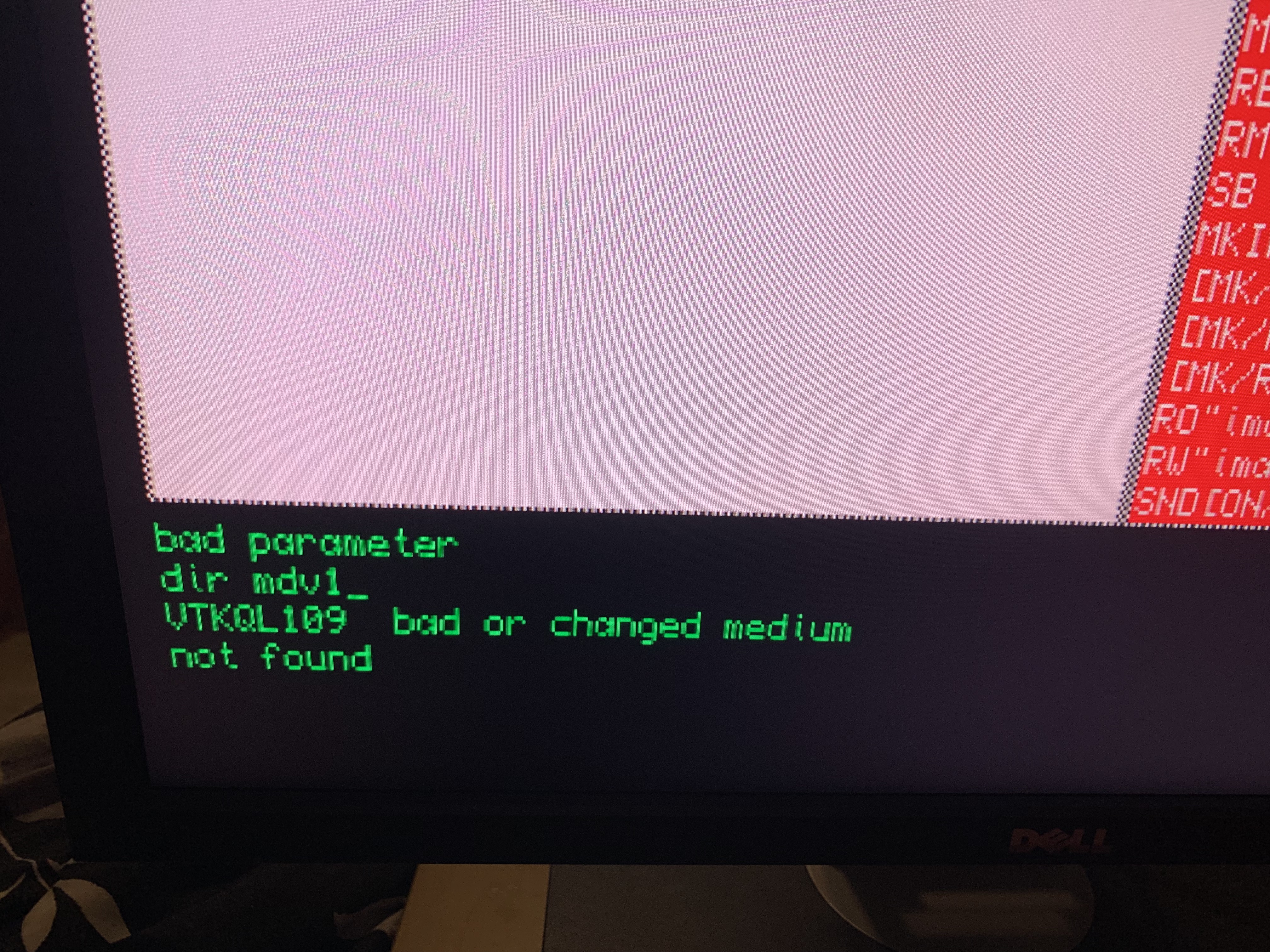

I did what you said . I made the connection from MDV1 pin 1 to MDV2_ pin 2
and I can access the Vdrive as MDV1_, I create and image but when I format the image I get bad or media changed media. I still access MDV1_ and load BOOT and do help but thats all
Any ideas?
Any ideas?
- Posts: 1125
Hi Bill!
The fact that you can 'see' the 'VTKQL109' medium listed suggests that the vDrive is being correctly accessed - but as yet, does not recognise the SD Card.
If I recall correctly from the vDrive documentation and my own experience, vDrive will present a 'pseudo' MDV image containing only a boot program and the (optional) vDrive Toolkit with no SD-Card mounted (or recognised.)
If you you have successfully loaded that boot program and the Toolkit, then the QL to MDV interface is working correctly - and all that remains is to review the documentation to check that your SD-Card is initialised correctly. The card initialisation itself is carried out using the utilities commands as contained in that Toolkit.
Good luck - you are almost there!
