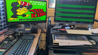

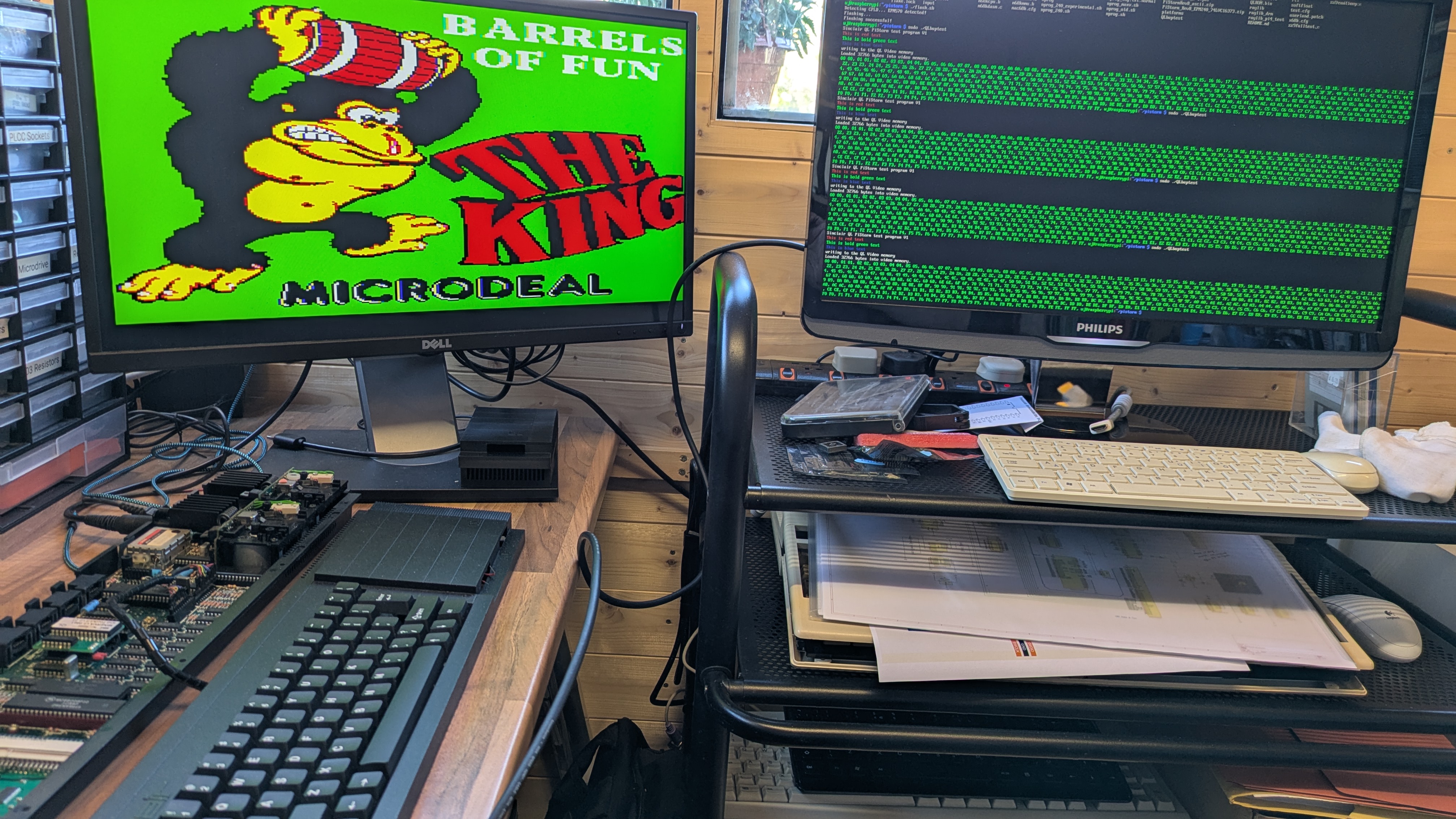

Update: OK after getting the Writes working perfectly and thinking the hardware was all done I discovered the Read cycles weren't working at all, another 4 weeks of fault finding I've just succeeded
in getting Reads working... it was all down to a bad solder joint sending me down the wrong path and QL's pesky DTACK holding for video writes. I have had to make quite a few changes to the Verilog state engine for the CPLD, but I think I am safe to say the hardware is done. I can now get on with the actual emulator software - I will be starting off using the Musahi emulator. Hopefully I will have something to demonstrate in the next couple of weeks... . The monitor on the left is showing a picture file that I've copied into video memory, the monitor on the right is showing Writes and Reads from memory, they are all green which is great because when they don't match they show up red... I wish I'd taken a photo when it wasn't working. there were band of red with a regularity which made me suspect video contention was causing the problem. Any way I am very happy now as I was almost ready to give up.

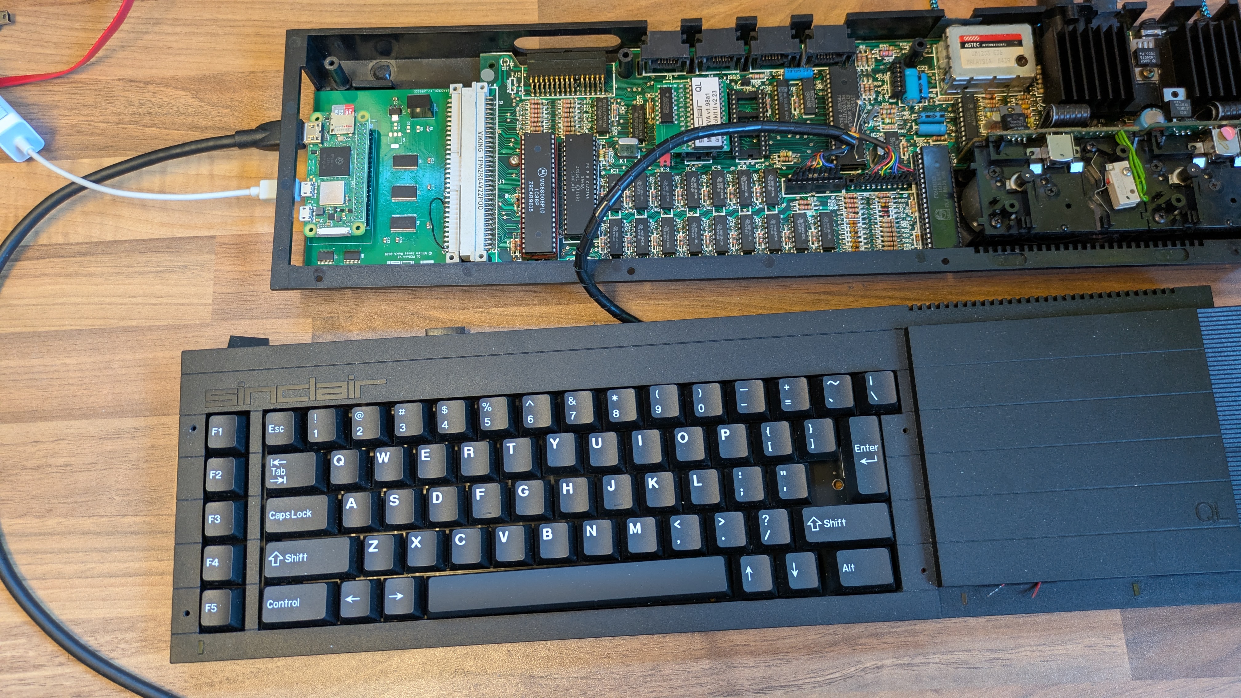

ps check out my MX cherry keyboard I made for my QL it works great and looks awesome if I say so myself. I have PCBs for this if anyone would like one - message me.

Great progress Will!
And I'd be very interested to build the keyboard replacement!
