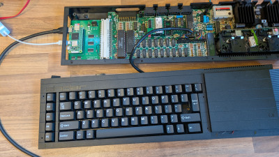

Hehe! - I appear to be on a roll at last. Reprogrammed the CPLD to handle !DS correctly. Change QLbuptest to set up the QL display register and got the QL PiStorm V3 copying data to the QL Screen properly now. The gaps in the picture must have been poor soldering on my V2 board or something... after a bit more testing next step will be to get the 68K emulator running.

So, now the hardware is done, I'm starting to work on getting the emulator going. I'm thinking of using Musashi as it runs under Linux which will make RTG and SD hard drive etc a lot easier. It's not as fast as EMU68 which hits the bare metal of the Raspberry Pi. I thought someone else might develop that if people want it. I'm not sure whether I will use the PiStorm emulator and cut out the Amiga Stuff or start with Musashi and add the QL stuff... I'm hoping to get it able to access Microdrives, and I'm tempted to add a FDD interface to the card as there is already an SD card on the Pi that I want to make into a QL HDD. I suspect I am going to need quite a lot of advice developing all this

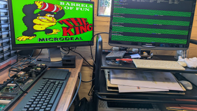

Update: OK after getting the Writes working perfectly and thinking the hardware was all done I discovered the Read cycles weren't working at all, another 4 weeks of fault finding I've just succeeded
in getting Reads working... it was all down to a bad solder joint sending me down the wrong path and QL's pesky DTACK holding for video writes. I have had to make quite a few changes to the Verilog state engine for the CPLD, but I think I am safe to say the hardware is done. I can now get on with the actual emulator software - I will be starting off using the Musahi emulator. Hopefully I will have something to demonstrate in the next couple of weeks... . The monitor on the left is showing a picture file that I've copied into video memory, the monitor on the right is showing Writes and Reads from memory, they are all green which is great because when they don't match they show up red... I wish I'd taken a photo when it wasn't working. there were band of red with a regularity which made me suspect video contention was causing the problem. Any way I am very happy now as I was almost ready to give up.
ps check out my MX cherry keyboard I made for my QL it works great and looks awesome if I say so myself. I have PCBs for this if anyone would like one - message me.
