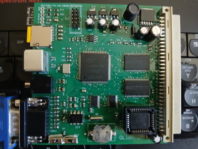

I have good and bad news to report.
The bad news is that after the aurora modes and speed improvements QLion is no longer compatible with microdrives.
I had no working cartridges to test with but when I borrowed a vdrive I found out.
I'll try to patch Minerva to make them work but I'm not sure I'll succed.
The good news is that now the card is 5.8 bogomips and tindex at qdos 512x256 is 26 and 21 at 1024x768 4 colour aurora mode in smsqe.

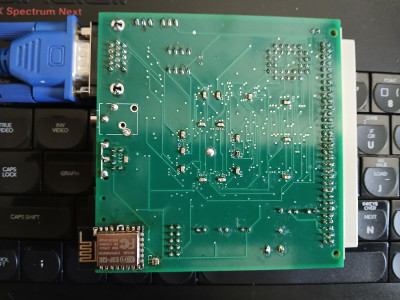

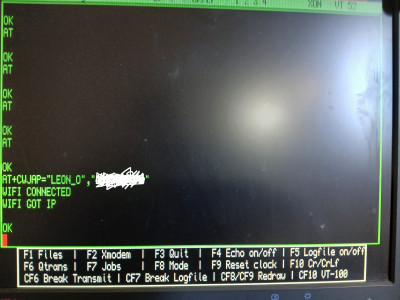

Added the option of an ESP-12E/F to be soldered on (under) the pcb. It connects to the fast uart at 115200bps by default.
Of course an ESP8266 WiFi Module can also be connected externally so I included this just for convenience (at least my convinience
