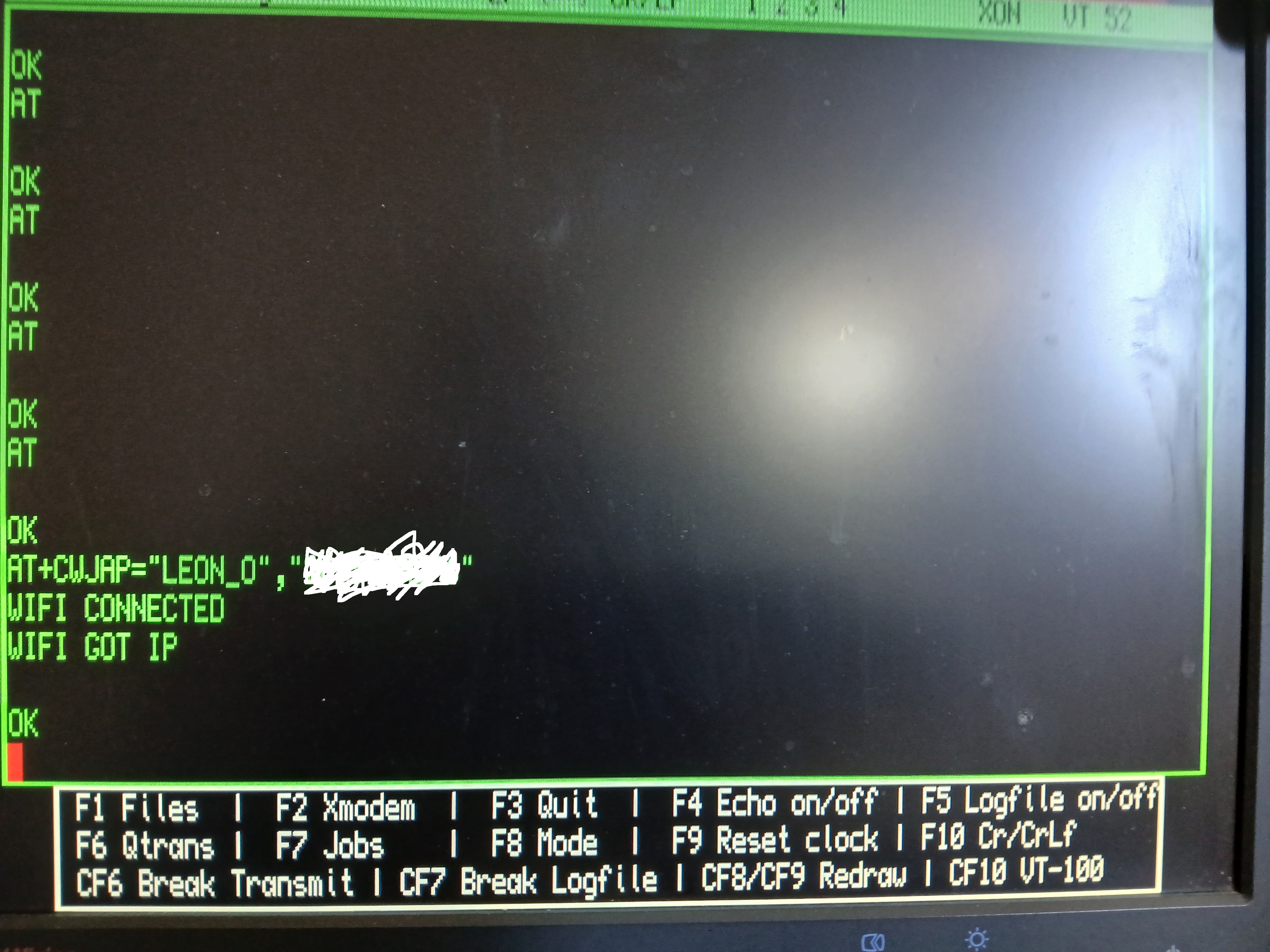

Added the option of an ESP-12E/F to be soldered on (under) the pcb. It connects to the fast uart at 115200bps by default.
Of course an ESP8266 WiFi Module can also be connected externally so I included this just for convenience (at least my convinience

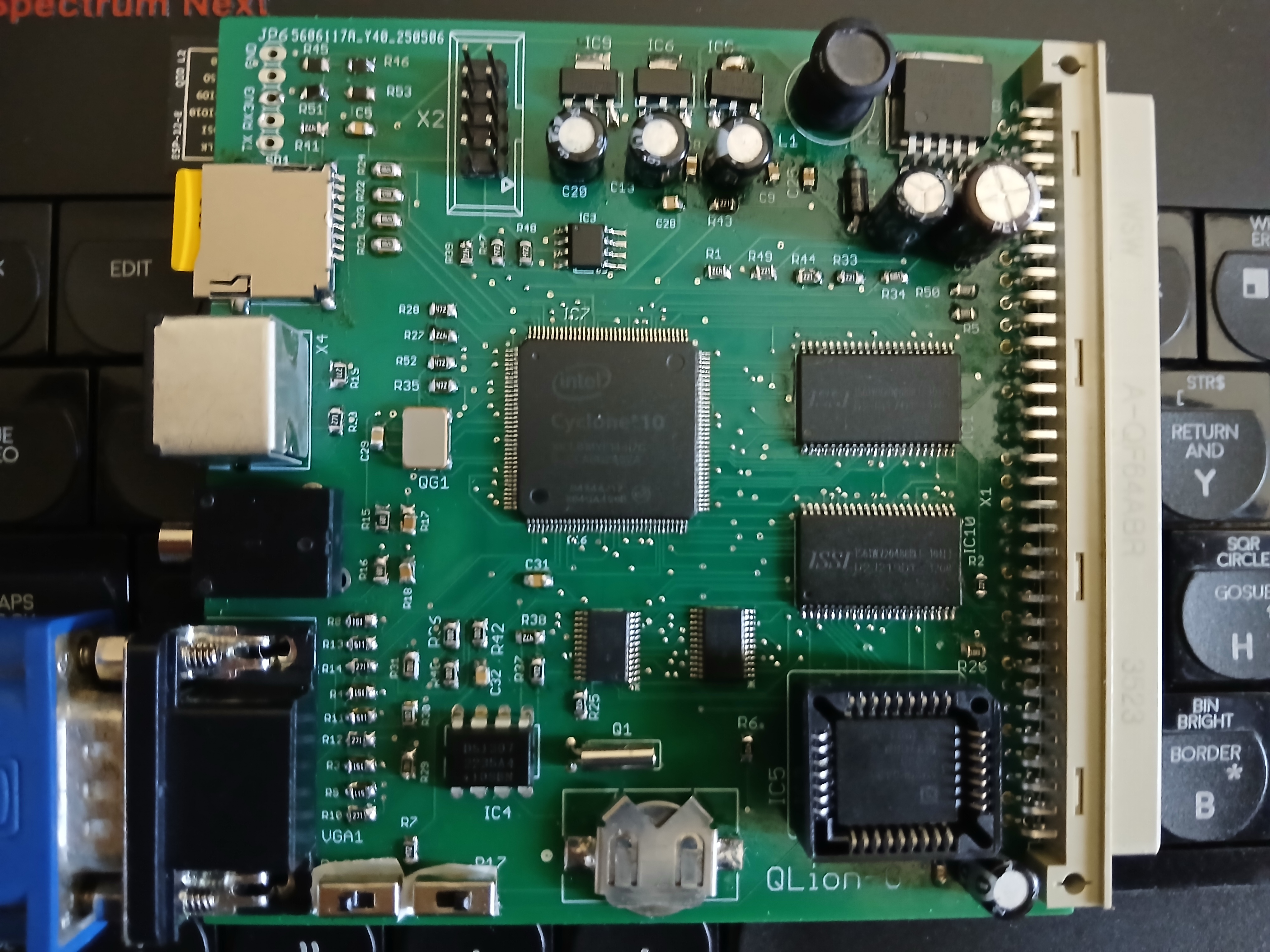

I made the card more ZXSpectrum Next compatible (sprites, video modes, esp, ay sound) although QLion Gold has more capabilities (4MB, more video resolutions, runs smsqe in aurora compatibility mode).
I wrote a user guide and have built and sent 5 cards to "test" users so far.
