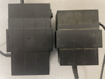

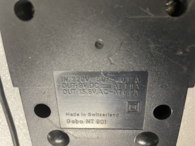

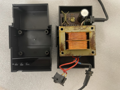

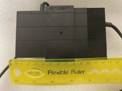

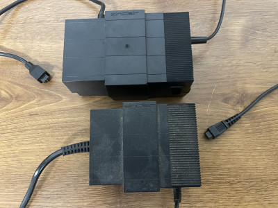

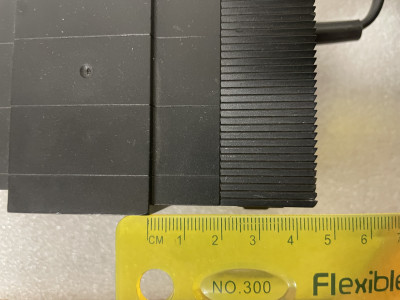

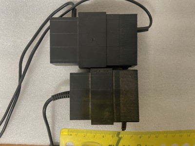

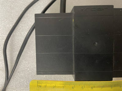

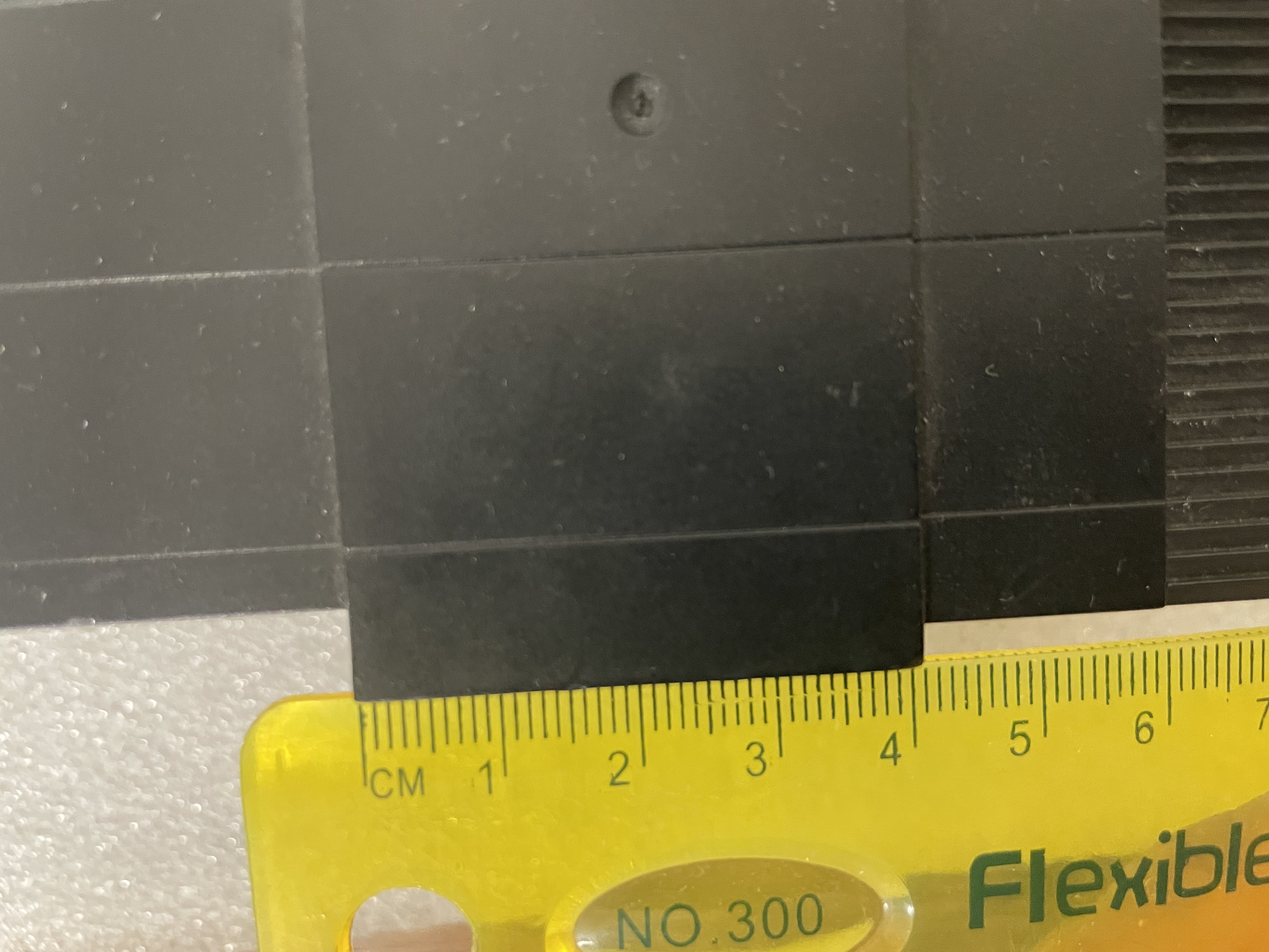

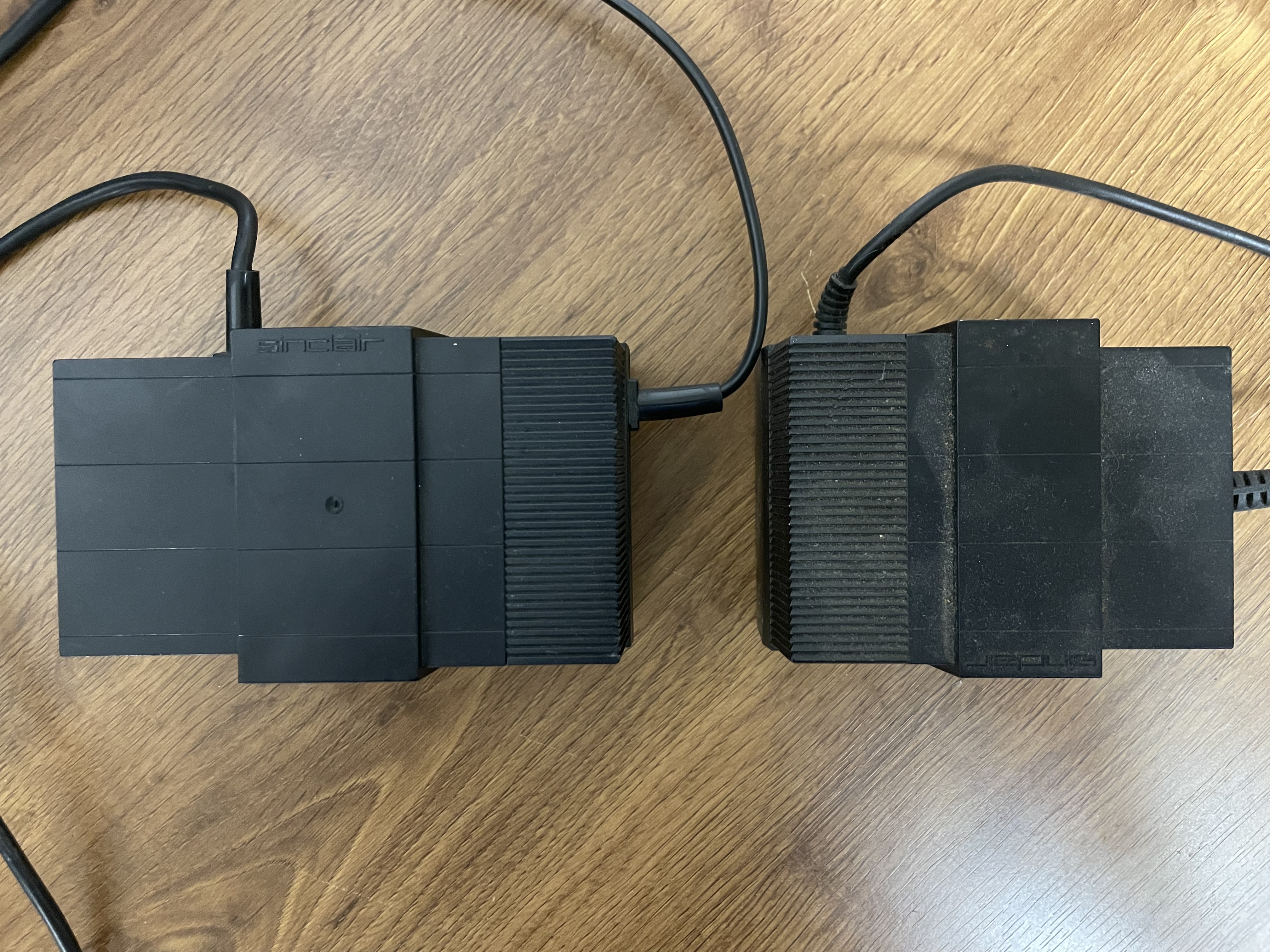

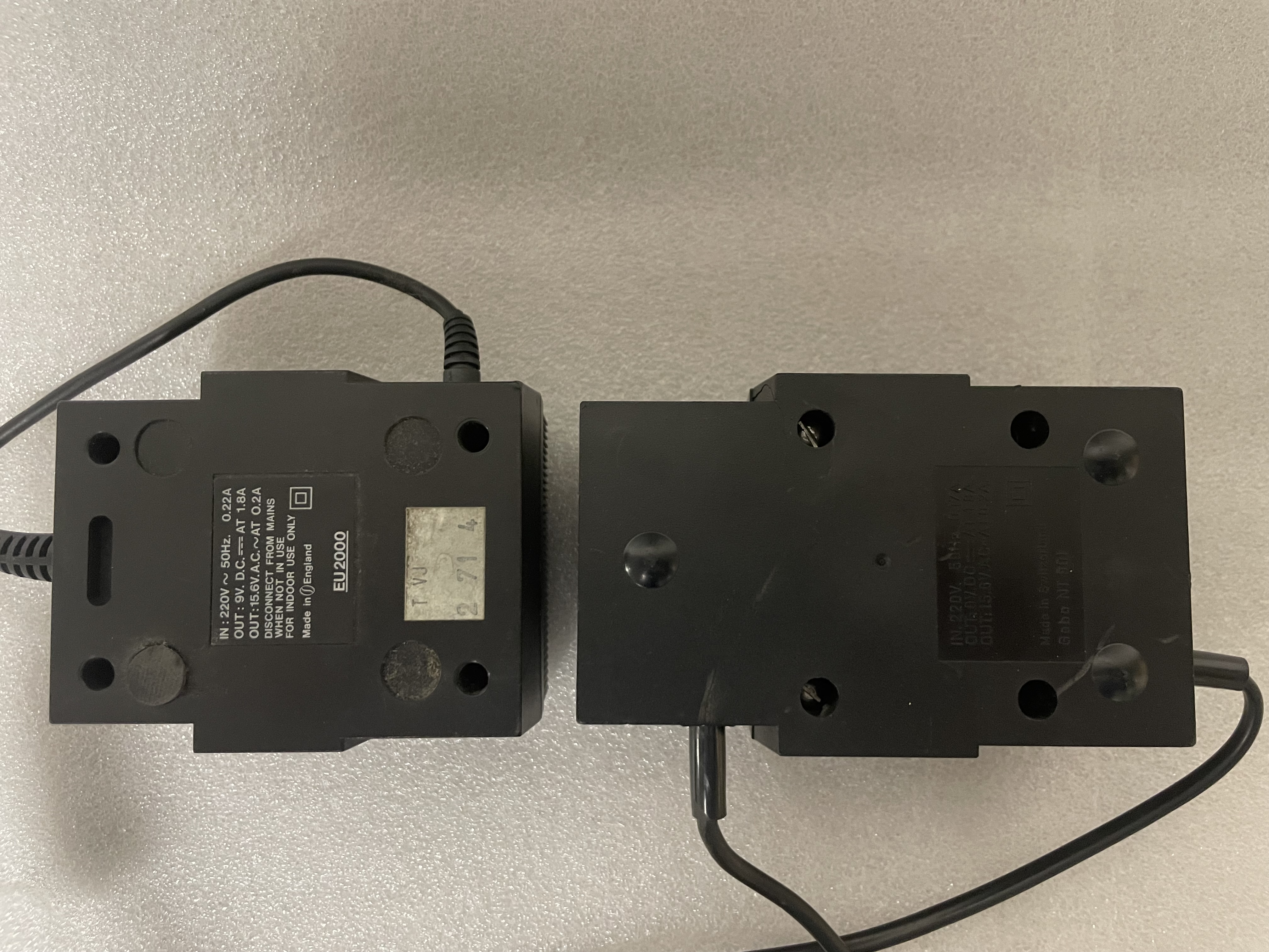

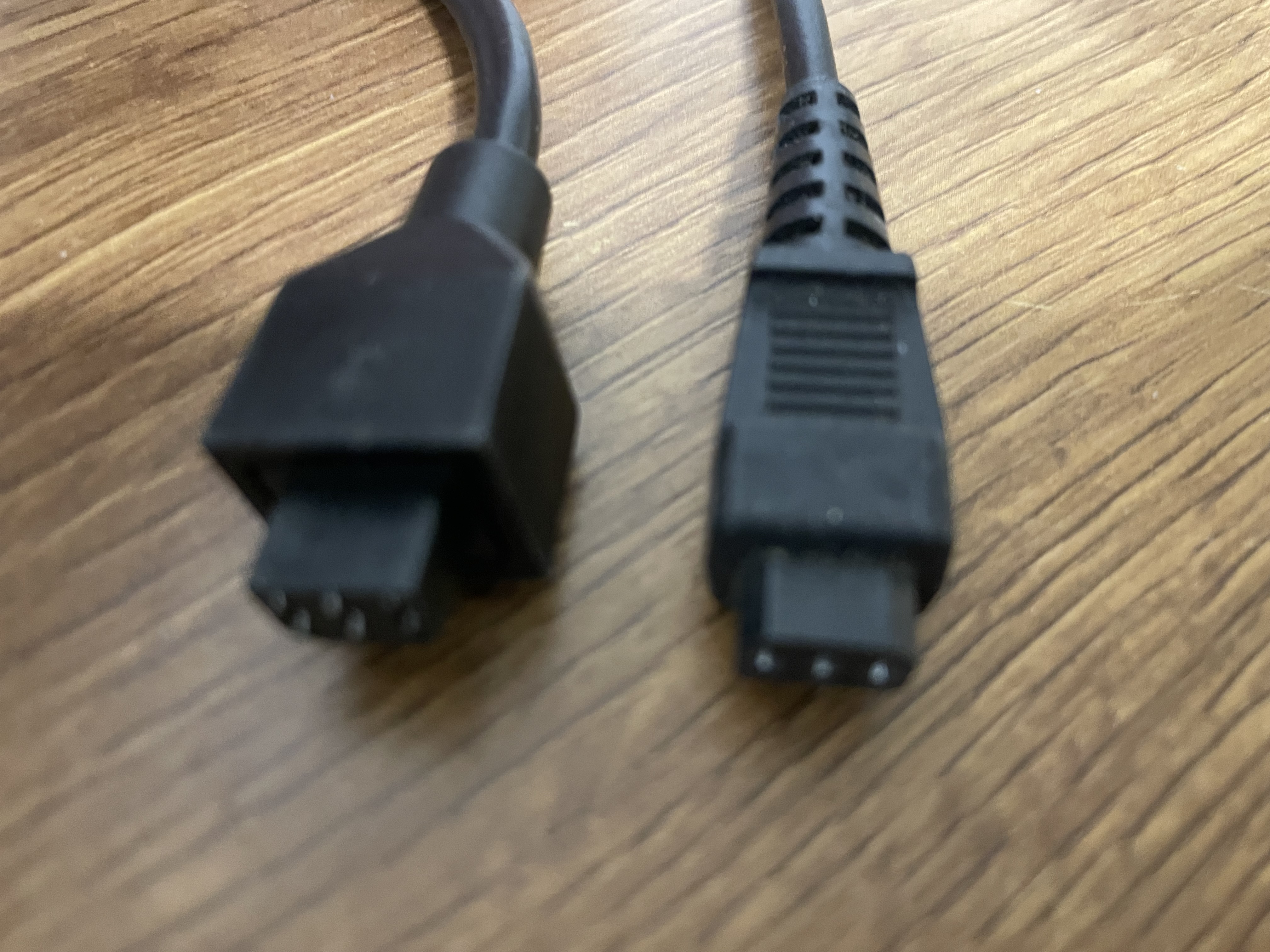

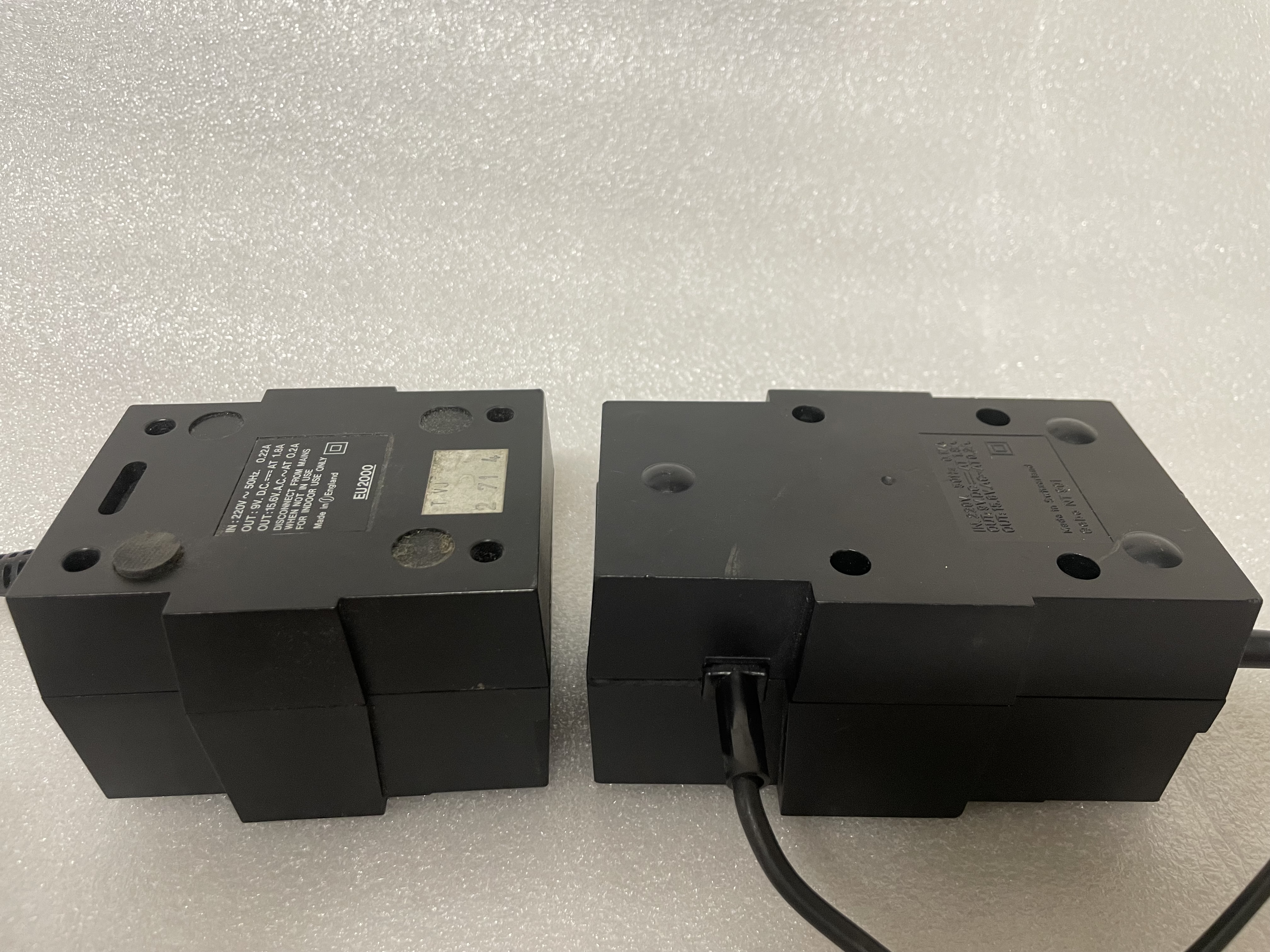

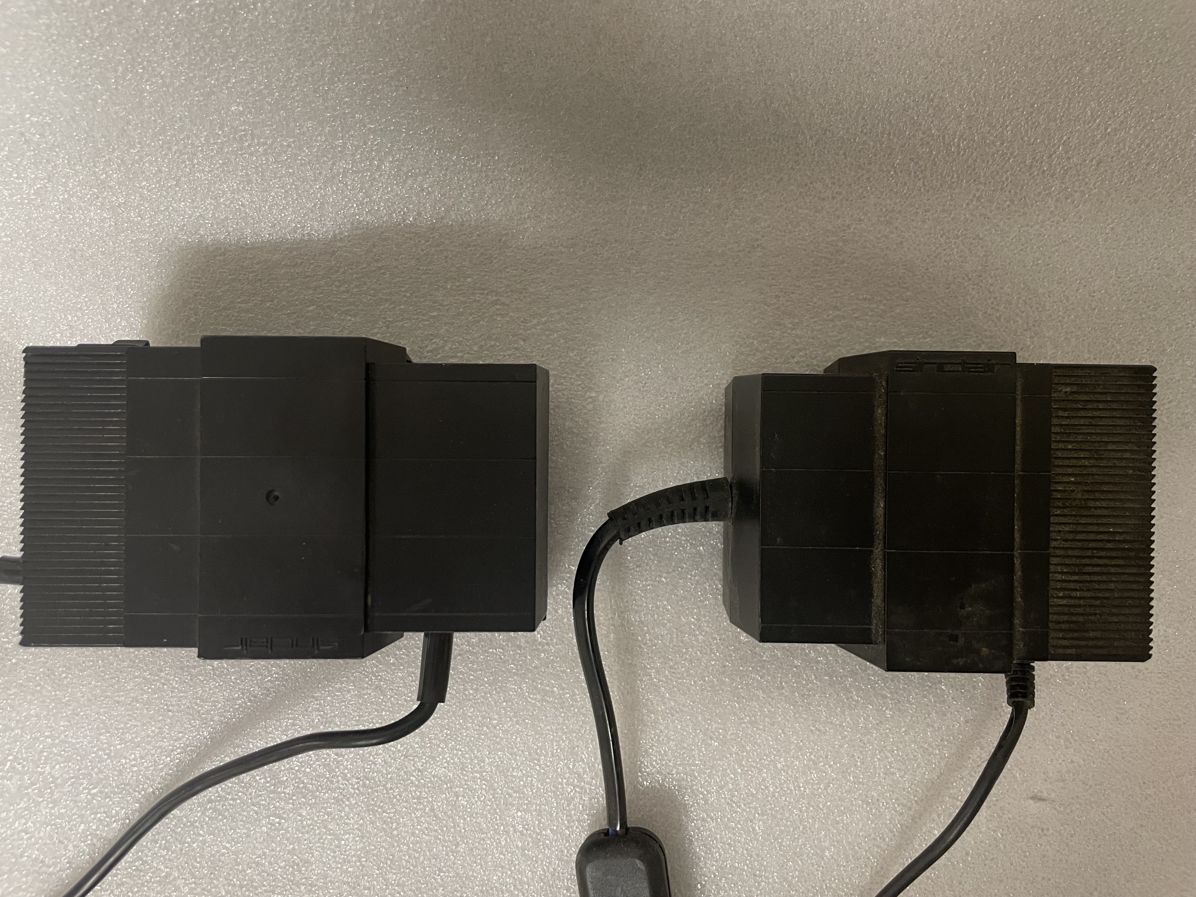

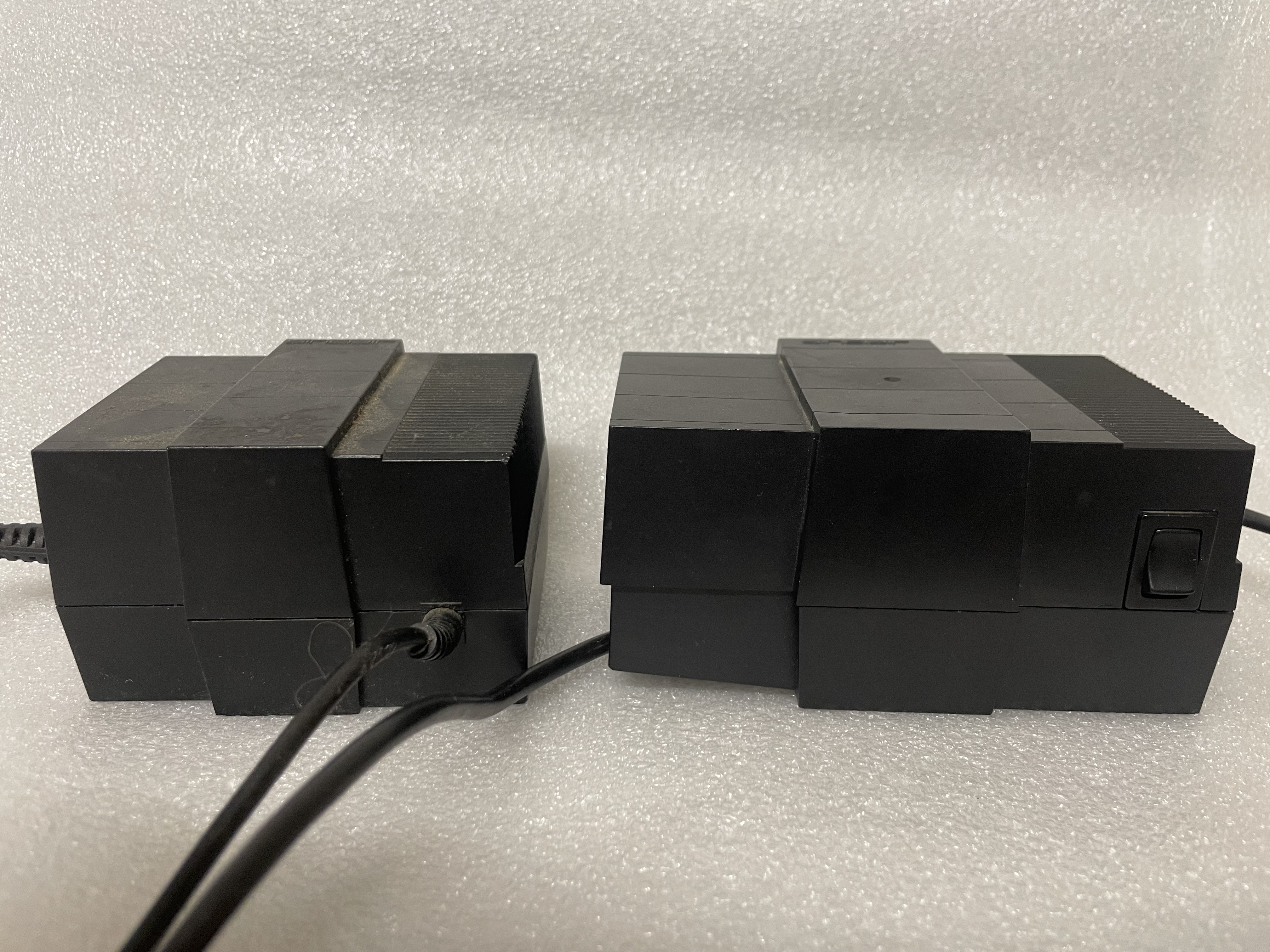

Re: German QL power supply with switch – dimensional sketch.
I have taken 15 photos.
The power supply is bigget than the usual one (which has 9-10 cm) with 12.5 cm, divided into 3 sections by 4, 4 and 4.5 cm.
Other dimensions (width, height) are the same as for the old one.
It was manufactured in Switzerland, I have photographed the internals, too.
Interestingly the power supply connector is different (bigger), too.
Hello.
Excellent, it’s so much more than I expected! Thank you so much! Plan is to do a 3D model of it and build one with some extras…
Thank you and have a good time.
