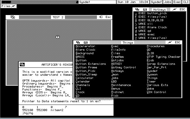

There appears to be a misunderstanding concerning my post where I state that:-
"I use the ancient programming environment of SMS2 adapted for SMSQE.
Most of pictures I post are SMSQE running on Q68, Pi5, PCs or tablets
As RalfR states, there is no interpreter in SMS2. I came to this forum from high resolution SMS2 on Atari but gave up using Atari computers some time ago and moved to systems that use SMSQE. As a user of SMS2 I was not exposed to interpreted BASIC and did not want to start using the interpreter that comes with SMSQE. (Except for booting).
To keep SMSQE looking and working like my original SMS2 systems I transferred the SMS2 Startup sequence to SMSQE. The SMS2 Startup file and the SMSQE Boot file I use are very similar. The software that is installed by the Boot file is identical except that I have loaded later versions of the Liberator compiler for this thread's tests.
I still use SMS2 but at low resolutions and in B&W. As far as I am concerned SMS2 and SMSQE are almost identical. (SMSQE's display software is superior of course). You can see below that there is no obvious difference.
I have just checked on the versions of Liberator files I use. I recently upgrade those files for the tests that I display in the thread.
Most of my systems use the following:- Qlib_run v.3.31 Qlib_bin 3.25 Qlib_obj 3.31
The upgraded files used for this thread are:- Qlib_run v.3.44 Qlib_bin 3.42 Qlib_obj 3.45
