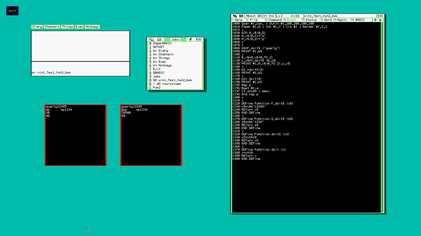

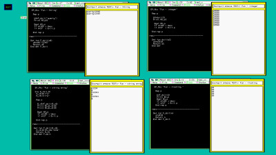

I am developing a standard way of testing BASIC instructions within a moveable windowing environment as can be seen in my JPG.

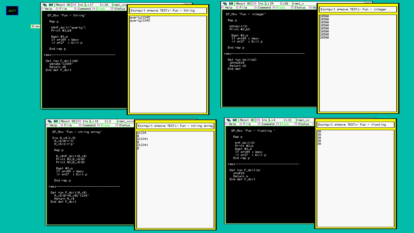

The four programs use a procedure compiled as an external that generates the image (EP_Mkw that takes a string parameter that is displayed in the title box). The programs then test passing an integer, a floating point number, a string and an array to a function called F_doit.
One can see that my attempt to pass and return an integer fails and my attempt to pass and return an array produces a strange result. The two others work correctly.
What am I doing wrong?

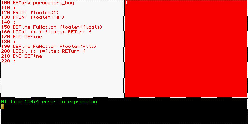

Take a look at the parameters_bug program attatched : Just Unzip it and LRUN it on your system.
Under QDOS you get an error at line 110, whereas under SMSQ/E the error is correctly at 100 as you would expect...
Under QDOS, the routine parameter's type depends on the calling variable's type !
This was hardly ever explained in documentation... Steve.

Re: Externals, Functions and Procedures
No, under SMSQ/E it says "At line 150:4 error in expression" and shows "1" at #1.stevepoole wrote: Fri Feb 28, 2025 2:46 pm Under QDOS you get an error at line 110, whereas under SMSQ/E the error is correctly at 100 as you would expect...
But I don't understand the error message.

Hi again,
Yes, under SMSQ the floats parameter is defined as floating-point. So when the calling variable is 'e'', SMSQ/E signals an error line 150.
But, under QDOS, floats accepts that the variable 'e' is sring-type, and tries to pass the value to the local variable f, which is by default a floating point type. Without delving into (expressions), the interpreter cannot convert 'e' to floating point, so signals an error on line 160....!
As mentioned last time, under QDOS this is a bug, in that routine parameters get their type from the calling expression.
Corrected under SMSQ/E, the error is correctly signalled on line 150... All rather confusing under QDOS, so prefer SMSQ/E every time ! Steve.
I have modified your code to suit my environment and have then interpreted and compiled your code.Hope it helps. Greetings from Switzerland. Markus
The interpreted result is in the window to the left of the screen and the compiled result is on the right.
One can see that there is a difference. The compiled code produces erroneous results.
