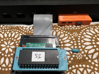

I've been annoyed that the BBC ribbon cable comes out of the top of the QL ROM port which means I can't plug any ROM dongles in unless I remove them from their case
So I made a slight modification to the case so it now runs out over the top of the CTL1/2 ports (which are still accessible)
(Next up is to make a ZIF version of a ROM dongle)
Posts: 984
Re: Ribbon Cable for Internal ROM Socket
Have completed burning & testing various ROM versions for the external ZIF socket
