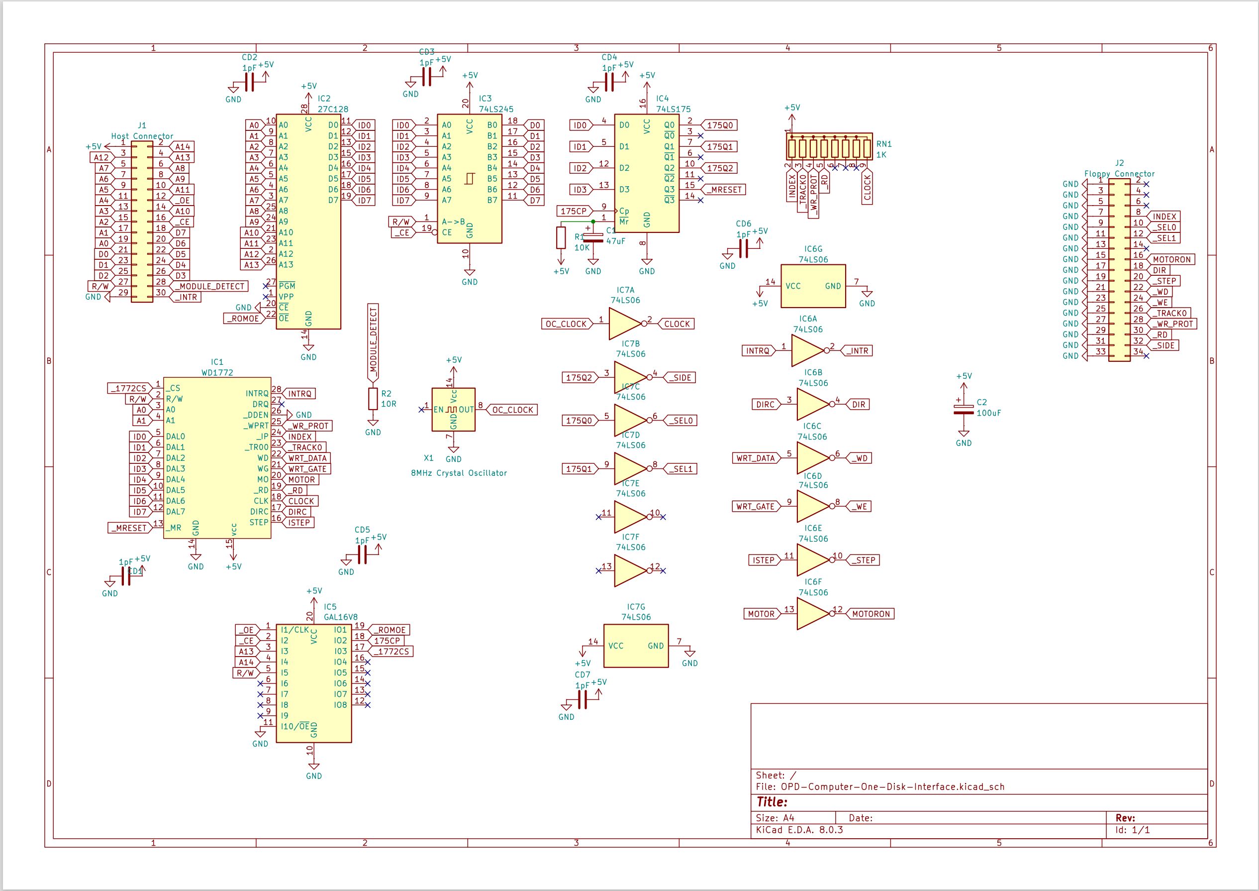

So I was looking at the circuit with a view to simplifying it.
I am uncertain as to the purpose of the 74LS74 flip flops in the circuit - in the ROM modules, pin 27 is just simply grounded to indicate the presence of a device in the ROM slot - surely that could also be used here - saving a whole chip and one gate.
Another 3 gates could be saved by using a crystal oscillator module, and the various drivers used for interfacing to the floppy drive could be reduced to a single 20 pin 74LS240 chip - used in a lot of the QL disk interfaces.
The ROM chip has to stay, the LS245 interface for the data bus - probably a good idea to keep that. The Floppy disk controller too.
So that leaves the other select logic and address decoding and the 4 latches (74LS175). This could probably all be tied into a GAL 16V8 in registered mode, and one mosfet to invert (open drain) the interrupt from the FDC chip.
I have not tested this - or tried compiling it yet - but the following logic:
175_clk 1 20 VCC
/DSL 2 19 /175_CE
/CE 3 18 /ROMOE
A14 4 17 /FDC_CS
A13 5 16 SEL0
D0 6 15 SEL1
D1 7 14 SIDE
D2 8 13 /FDC_Reset
D3 9 12 R/W (in)
Ov 10 11 Ov (/OE)
/ROMOE = /DSL * /CE * R/W * /A14
/FDC_CS = /DSL * /CE * A14 * A13
/175_CE = /DSL * /CE * /R/W * A14 * /A13
(175_clk tied to /175_CE externally)
SEL0 := D0
SEL1 := D1
SIDE := D2
/FDC_Reset := D3
would seem to address what's needed - /DSL is called /OE on the C1 interface diagram. D0-D3 would be ID0-ID3 on the interface (buffered by 74LS245)

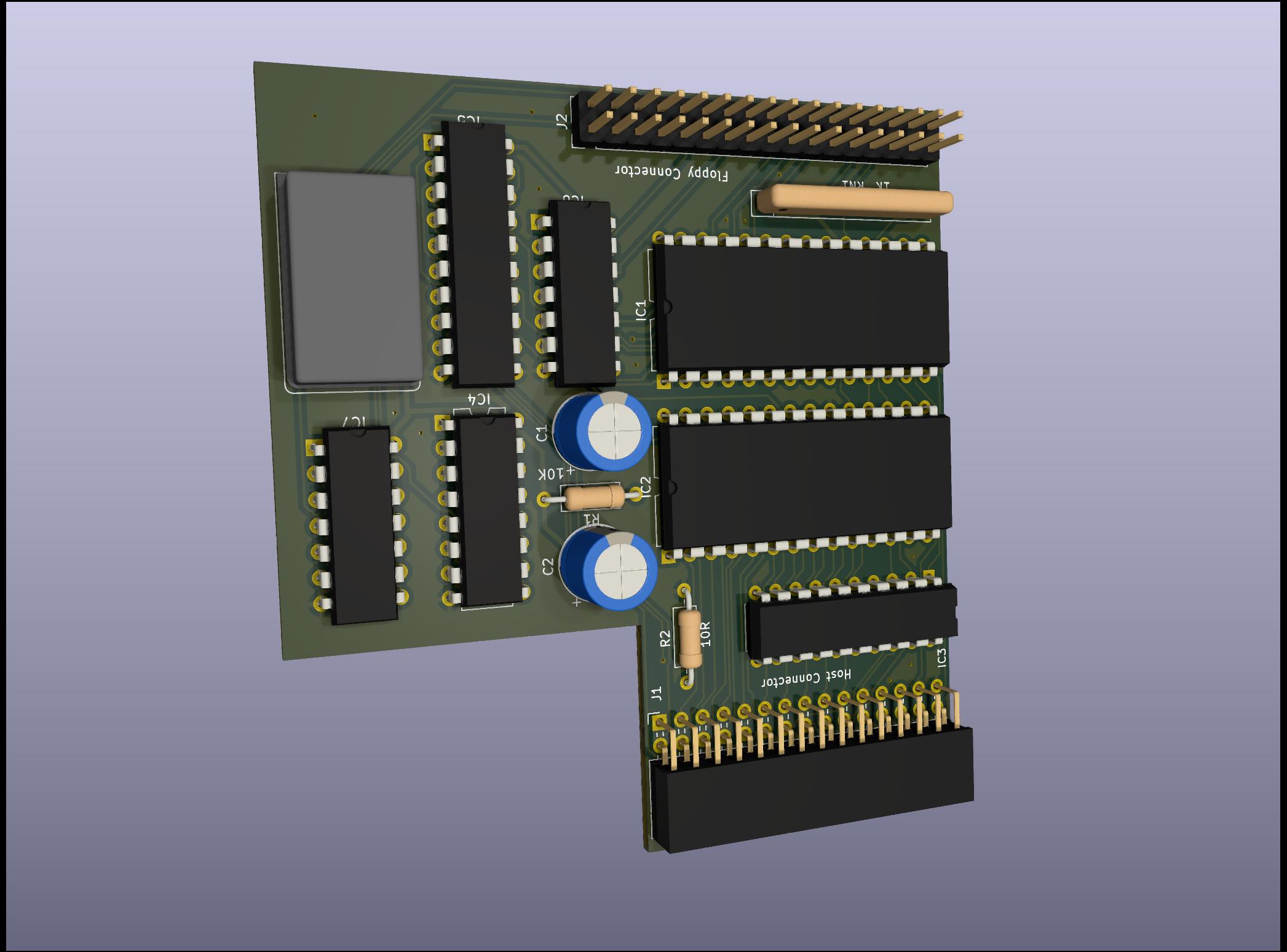

I've finally got around to redsigning the interface, reducing the chip count by three and using a GAL.
Here's the new schematic:
Hopefully it'll work and look like this:
I've fixed the ROM port connecotr so that it's on the component side, meaning that I can create a 3D printed case for it. It's also a lot shorter than the original and shouldn't interfere with the monitor and put less strain on the ROM port connector (which the case will help with too).
