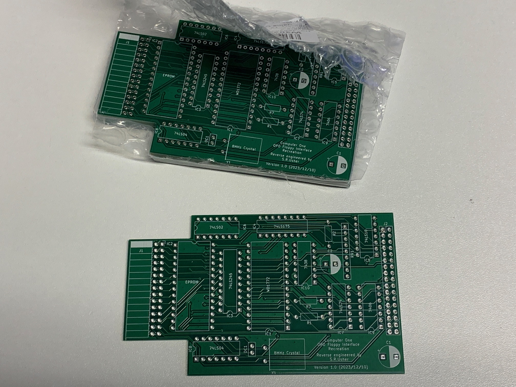

As some of you may have seen I'm attempting to produce a recreation of the Computer One floppy interface for the One Per Desk/Tonto.
The good:
  • I've reverse engineered the schematic from the information on the RWAP web site.
  • I've got the Mk.I PCBs arriving on Friday.
  • I've got all the chips and other components.

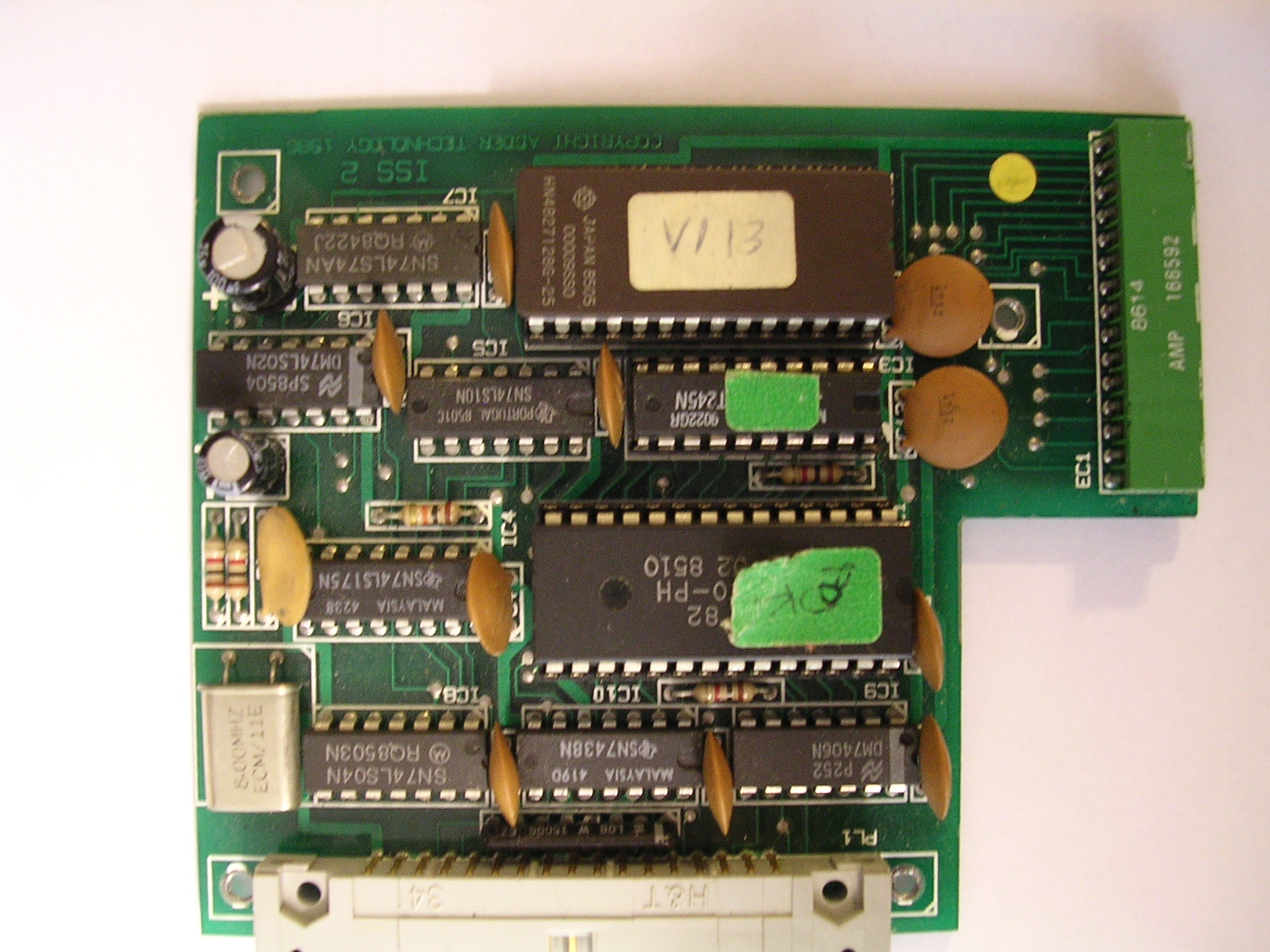

I did have a brief email chat with Rich last year and he didn't have the ROM data. All I have is a pic of an i/f. Label states v1.13 and the message on the PCB says Adder Technology. Is that the same as the current adder.com people? Not sure what the relationship was between Adder and Computer One.

He obviously lost the board he was sent then.
That's a different board layout to the one in the article on the RWAP web site too. Maybe the one on there was the issue 1.
I'm guessing that it is one and the same Adder, not that that would be any real help.

Post by stephen_usher »
Well, the PCBs have arrived...
