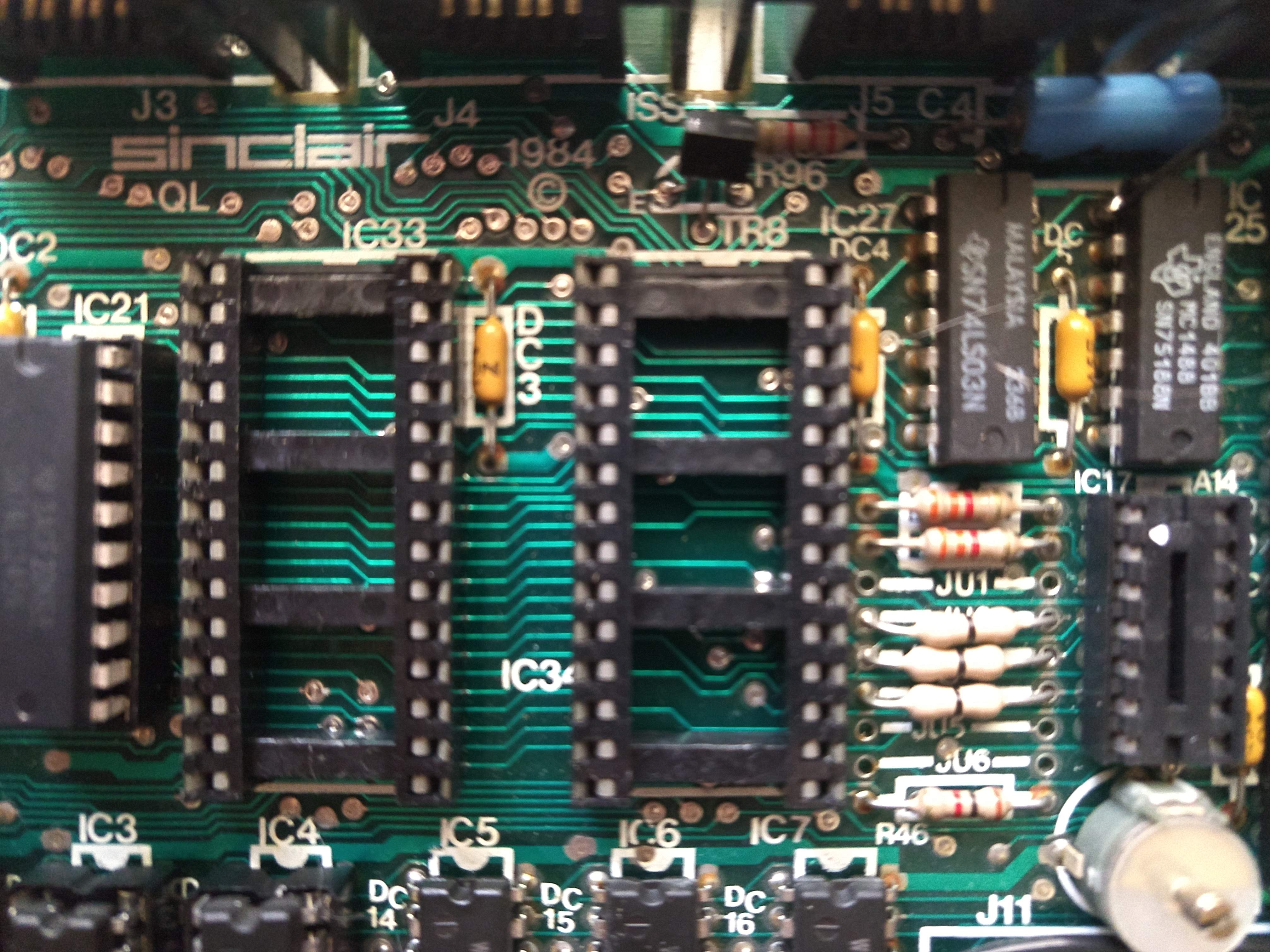

please,
May you show a photo of the naked socket?
Without IC.
Before go harder with another focus (that of course, higly probably will be another issue), but (at least in my experiece) sockets are really really tricky too often.
You have check out the connections between sockets pins and the counterpart (the other side), well done. But... have you checked out how IC legs make contact with the sockets? Very often there is the hide ghost.
I know that is many times useless and paranoid, but here are good reasons for it. And the cost to test it out is so little comparing with labor of de-soldering RAM ICs and test a whole new bunch.

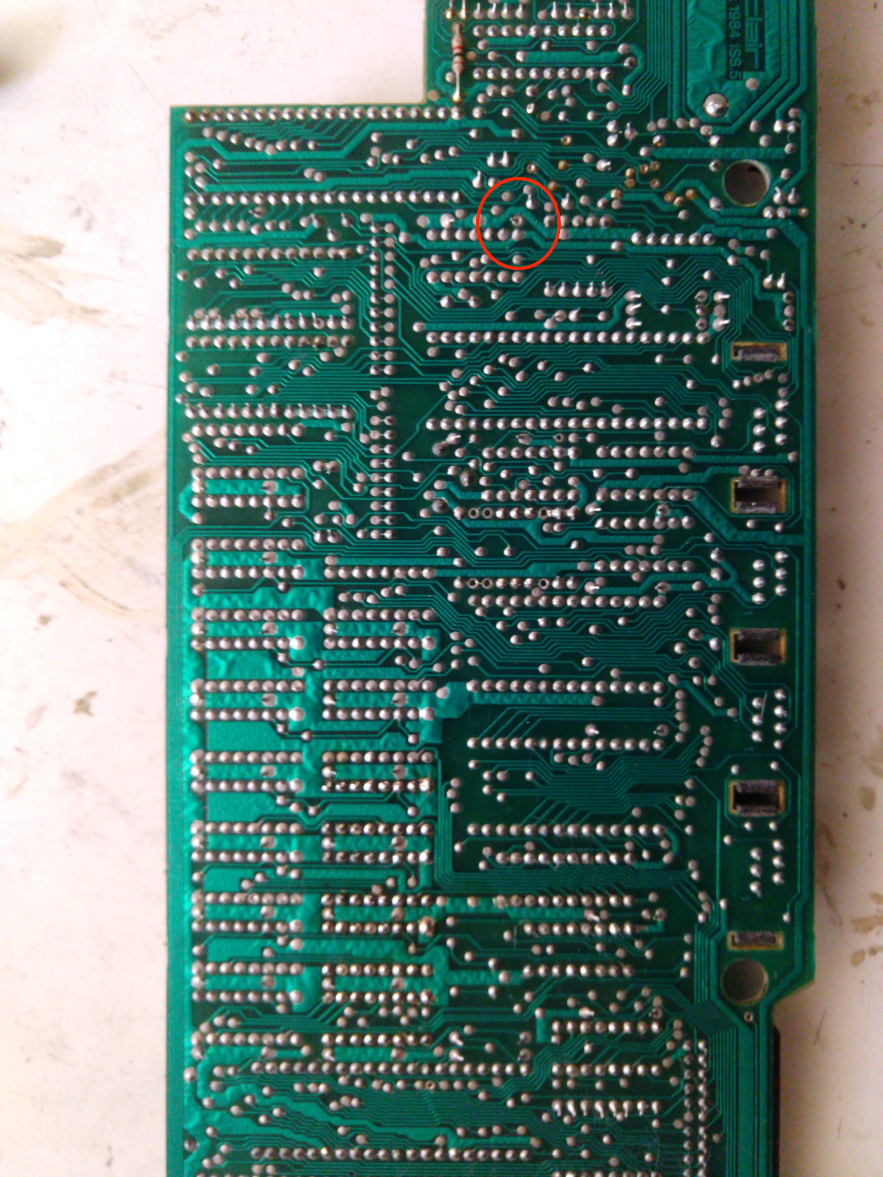

im not sure if i understood that correctly. I've tested IC leg to IC leg with the multimeter and if im not wrong got a beep on each. How could the socket inbetween leg and leg be the reason for smth not connected. Or do you mean the sockets could have bad influence on the signal quality ?Visually, i could until now not really find an issue. Nevertheless, adding some images, the are not very sharp i fear, but maybe good enough.

I think what popopop suggested was to measure with IC in place so you have connection from pad to top of IC, this to verify there is good contact in socket.
Glad you see some progress!!
Most likely nothing but have a look at the solder joint in red plus, if you have solder flux resolder the joints.

also thx for that hint you have marked, will do

But while checking that with and without ICs in sockets, i found that the ROM sockets have a short between Pin1 and Pin28 (might be that exactly what you commented is the reason why i didn't see that before). That would be A15 and VCC. Also fixed another bug made by me (one of the 257 had two legs in 1 socket .... )
Trying to find the short on the ROM sockets now. thx again
update: wait no, rom sockets 1 & 28 are A15 & VCC for the AT27C512R i ordered to burn minerva on. Pin1 & Pin28 are both +5V, so that is okay.

Posts: 1564
The QL motherboard has pin 1 and pin 28 wired to 5V - so the 'expected' A15 signal is not on that pin - instead it's used as a chip select for the ROM's - the ROM's in the QL ROM set - one is active high and one active low - so A15 decodes whether lower 32K or upper 16K rom are selected.
Either ROM can be used in either socket as they are both wired the same. The only problem is you can't just use a 64K EPROM in place of the ROM - not without some kind of adapter board or some tricky mods to the motherboard.
