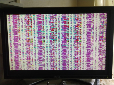

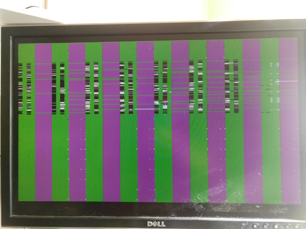

Hi there,
i recently got a 2nd QL in my hands, unfortunately not working. My assumption is that its a ram-chip problem and i also assume the video-ram is affected.
That is what i get after turning it on (the service manual says likely a ram problem with that pattern), i replaced the ROM with Minerva to figure out which chip it is, but unfortunately not readable. I once got an output that told me address is 0x10000 if i remember correctly, unfortunately written/read was not readable on the screen, but 0x10000 would be even before video-ram if im not wrong...

forgot: that screen is actually with minerva installed

Looking at the display it appears that (other than green/magenta stripes) the random pixels are placed exactly where Minerva normally shows fault report. So Minerva is trying to report a RAM failure. But surely only one 4164 fails at a time? This looks like something more than a single chip failure. As PrOf mentioned, it looks more likely to be a fault on one of the common address/data lines.

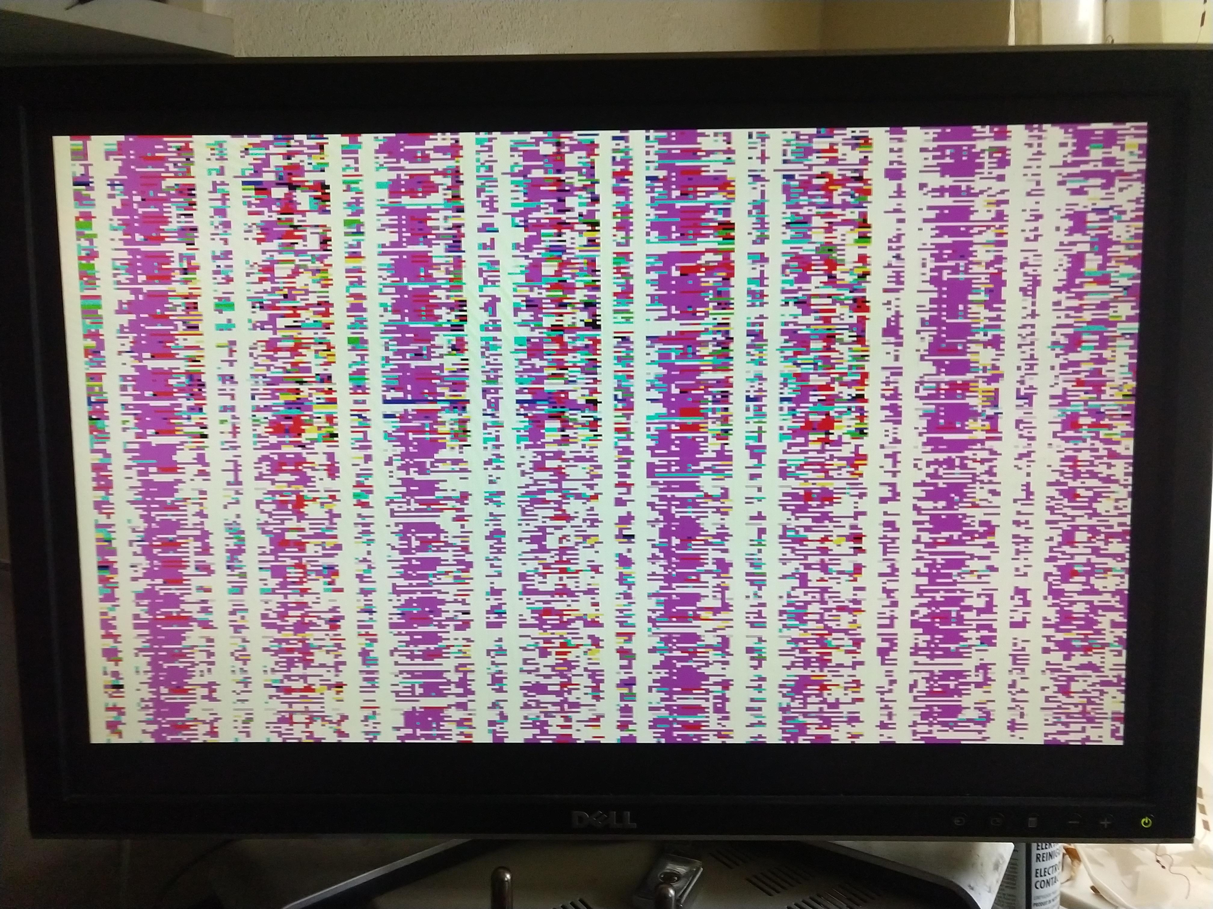

btw, thats how the screen looks like with the JM ROM the QL came with, that is also somehow blinking, means like changing a bit every 1s or so.
