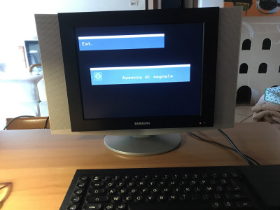

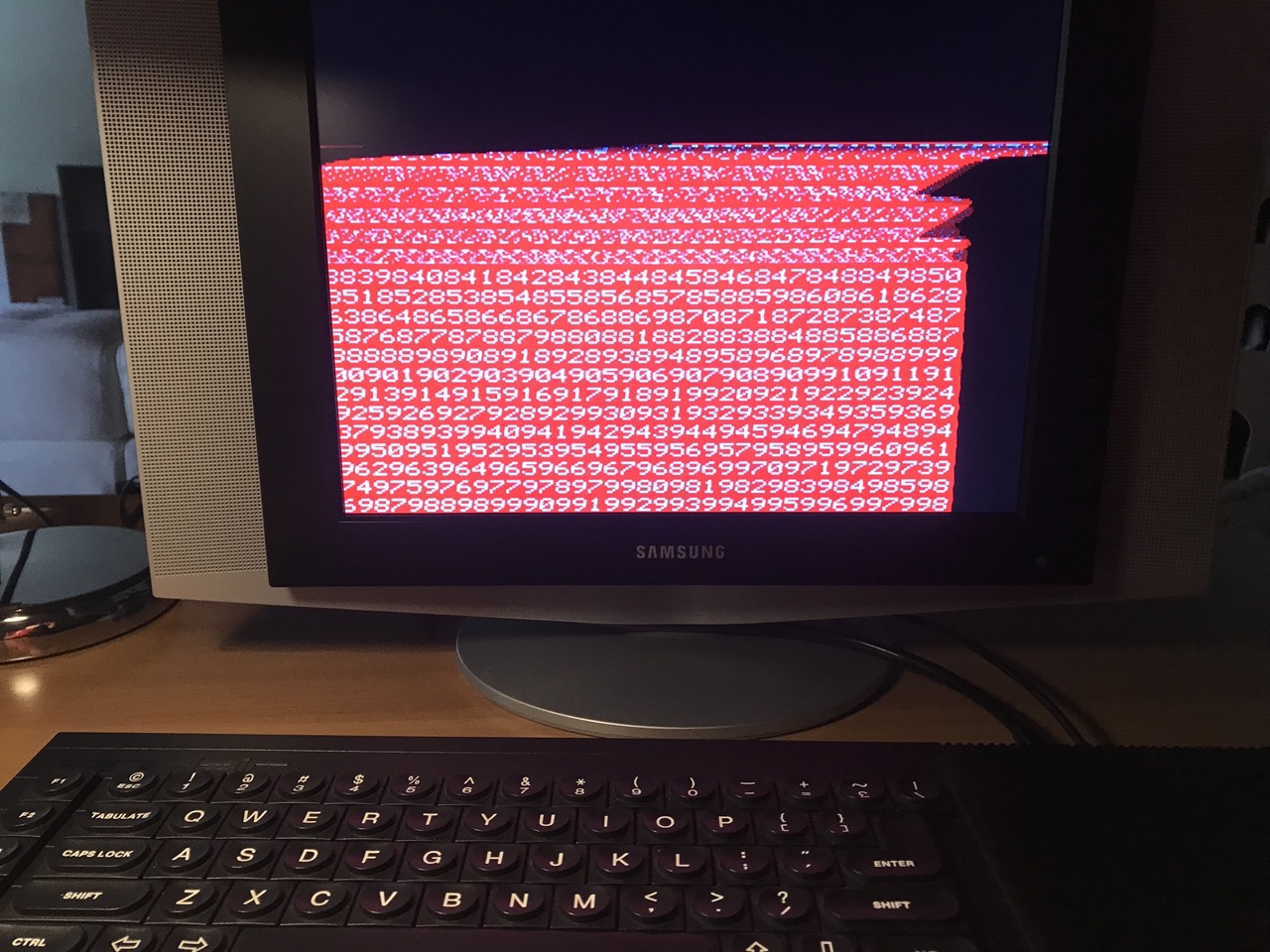

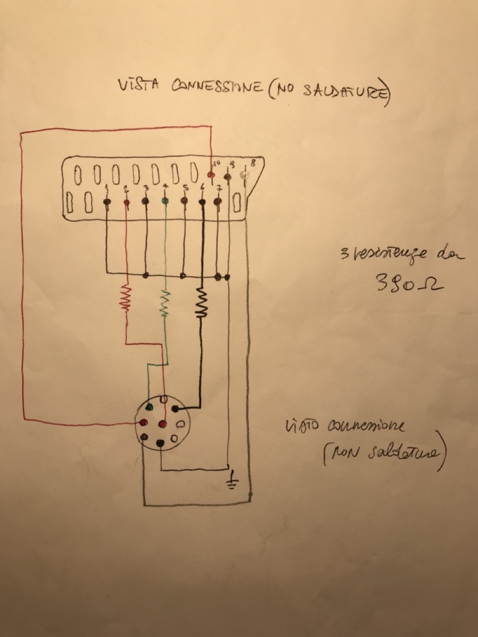

Hi guys, I found some time to spend with my QL and I built a Video Scart cable myself. I followed the diagram below (the sockets are seen from the front, NOT the solder side). It works very well with a couple of TVs at home but on a small TV/Monitor (where among other things I would like to always keep it connected to my QL), it doesn't work: on the latter TV there is a message "no signal" when I turn it on and then - when I press F2 - I see a red image out of sync. The resistors are 390 Ohm. What do you think it could be?

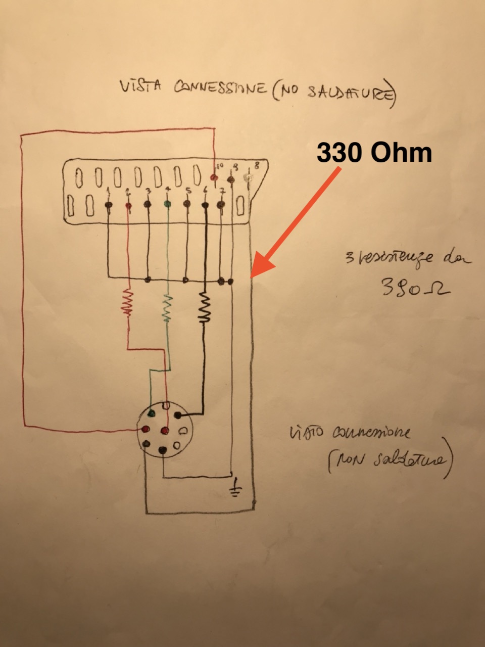

Thanks for the suggestion. I tried to put a 330 Ohm resistor in the point indicated by the arrow, but unfortunately I still receive no signal (when there is the initial F1-F2 screen) and then I see the screen as per the disturbed photo (exactly like before).martyn_hill wrote: Sat May 11, 2024 8:18 pm Hi Robbizz!
I've had success creating a number of QL -> SCART cables over time, based more or less on the really useful site:
http://www.fruitcake.plus.com/Sinclair/ ... ableQL.htm
I guess you might have used the same site and, like me, you've used that 'trick' to use the Comp. PAL Video (QL pin-1) output to drive BLANKING (SCART pin-16) as a convenience to present c. 1V+ and thus trigger the TV/Monitor in to RGB mode (vs Comp. Video.)
However, as per that site, I also add the 330ohm resistor in series with the TTL CSYNC signal in to SCART pin-18 (Video-in), effectively lowering the CSYNC signal presented at Video-in to around [75 / (330 + 75) x 5V =] 0.93V pk.
Some TV/monitors might be sensitive to the TTL level appearing on pin-18, so I recommend adding that series resistor to effectively lower the pk voltage present at Video-in.
Again, referring to the above site, I've never needed to drive the FUNCTION pin (SCART pin-8), but again, some TVs might be fussy, though the effect you describe doesn't sound relevant to driving this pin.
Let us know how you get on!

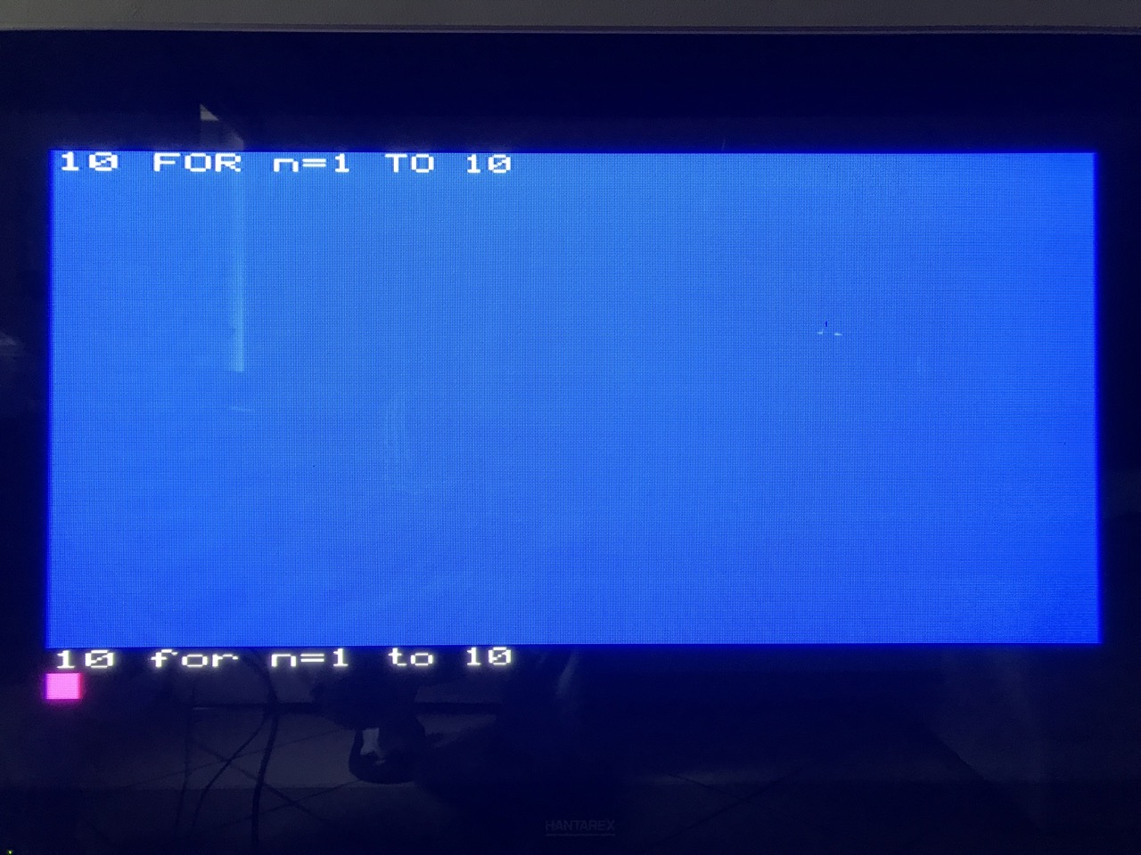

Note that with the same cable, on my TV at home, it works perfectly (see last photo).
I don't think that the Samsung TV has problems managing RGB signals, because I tested it using an Atari ST with Scart cable and it looks good.
