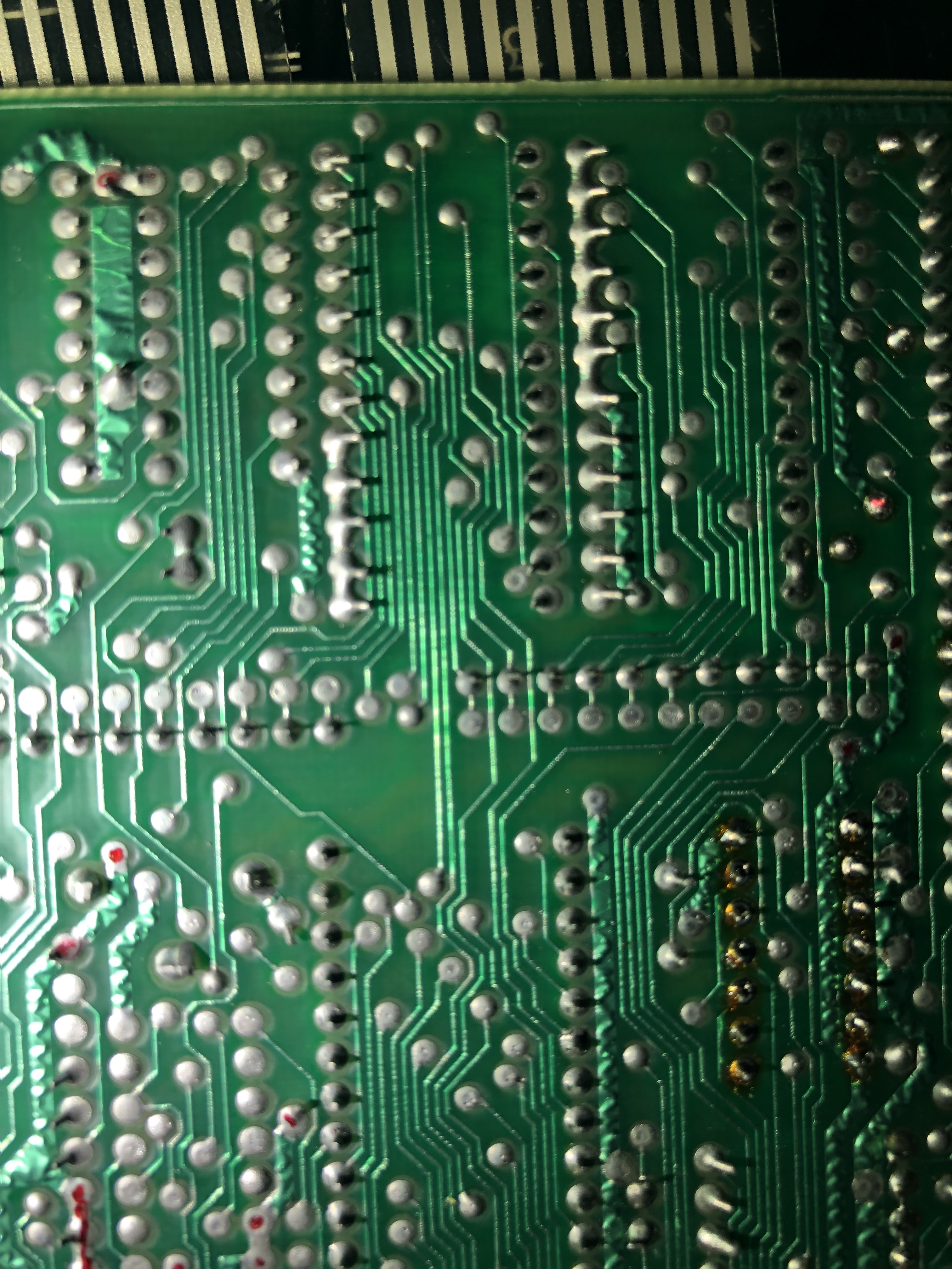

Here's two photos, I will double check exactly which IC it is.
Maybe you have written it before, but do you have solder flux and wick? Clean up where you replaced the ICs and if possible send a new photo.
For me the 245 and 257 gave very noisy and if I remember correctly output signal even when there were no input so if it's the same problem with yours I doubt it helps to piggy back.

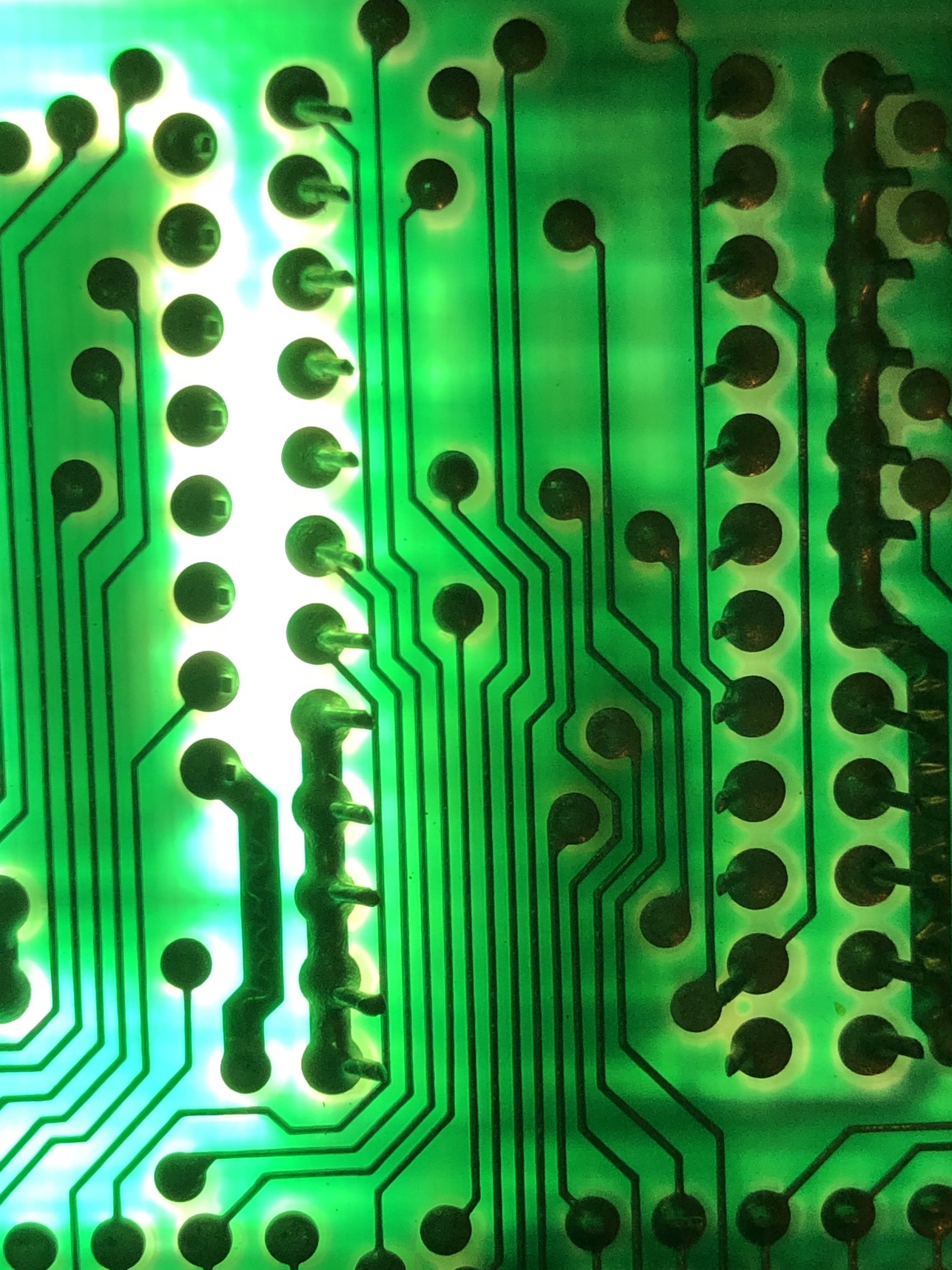

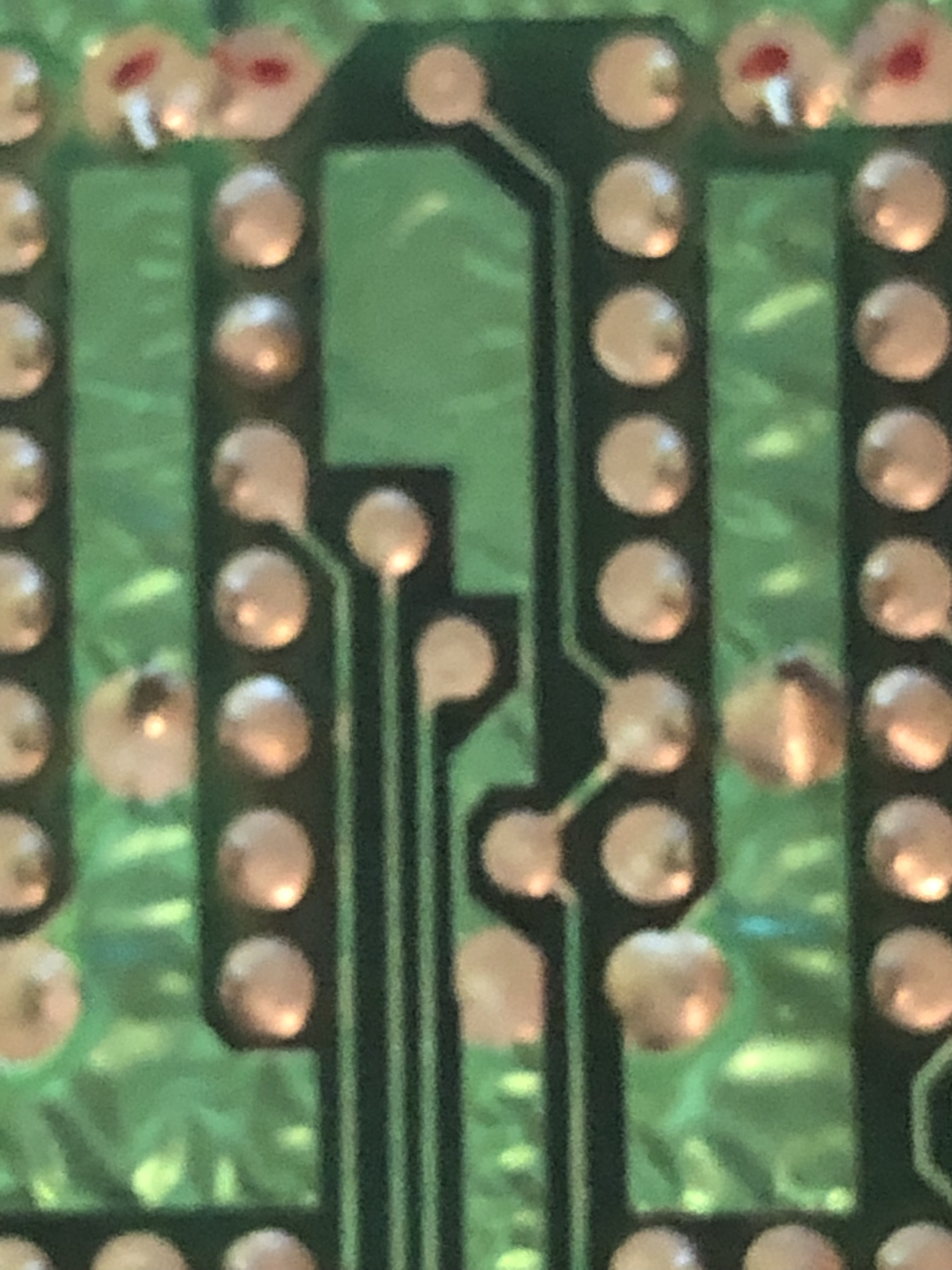

Hi
This is IC11
Double check so you the track around pin11 is alright,

Thanks for the Photos
I can't see anything different between yours and mine on IC11 (or IC8) in the sense of tracks etc, and I've tested the whole area for shorts and breaks

I don't know if these pictures of bare boards will be of any help viewtopic.php?p=24839#p24839
If you blow them up, you can just about follow the tracks.
