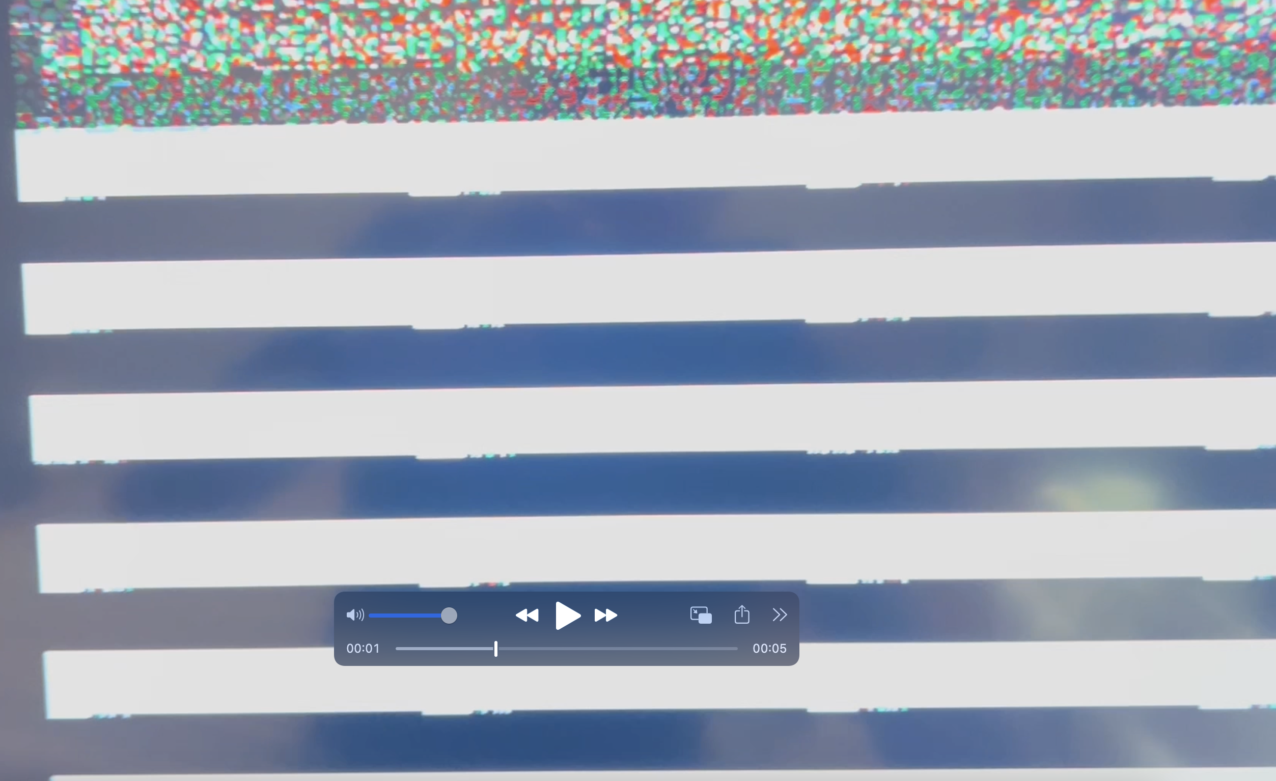

I tried each chip and still get green screen, also tried multiple to no avail
At switch on I get top half of screen showing the twead pattern with black and white stripes below, then it quickly changes to the full twead screen then black for a moment before turning green

Actually slo-mo of the video I took shows it starts with black and white stripes and the tweed pattern moves down until it fills the screen
Screen then blanks and then shows full twead again
Before blanking and going green
Posts: 1201
Re: Piggyback 4164 to Diagnose Memory Fault
This is what it looks like as tweed moves down the screen initially
