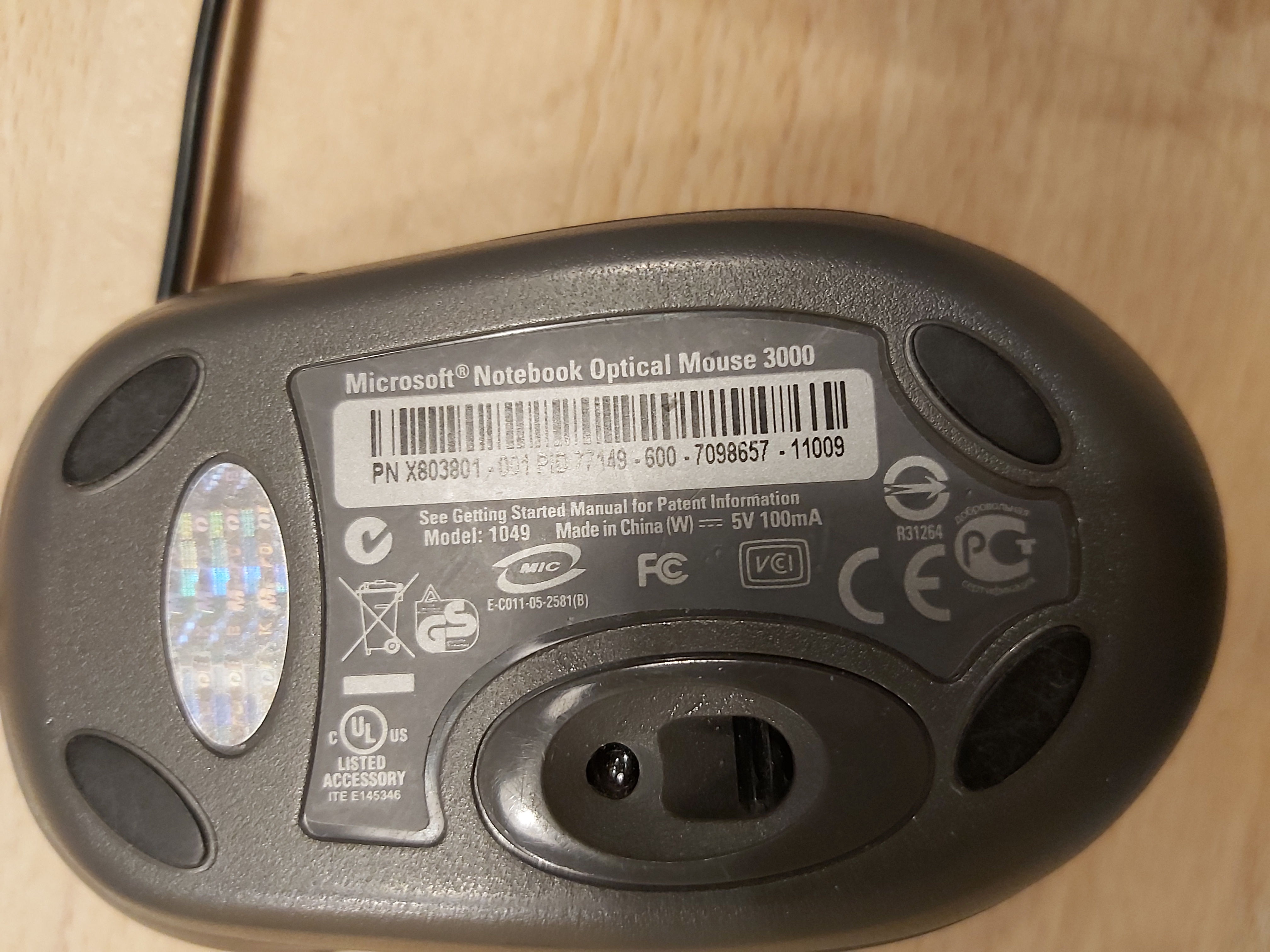

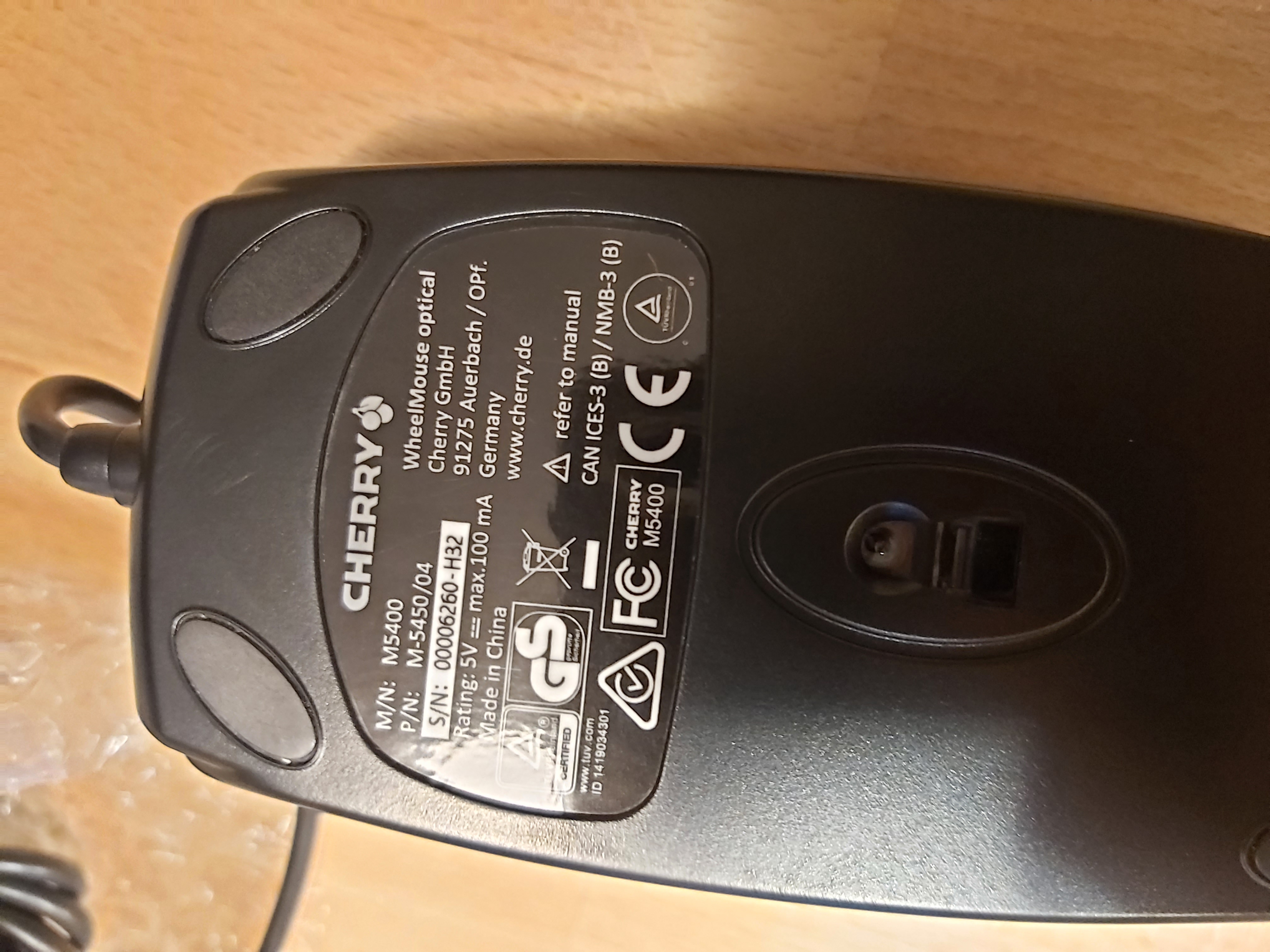

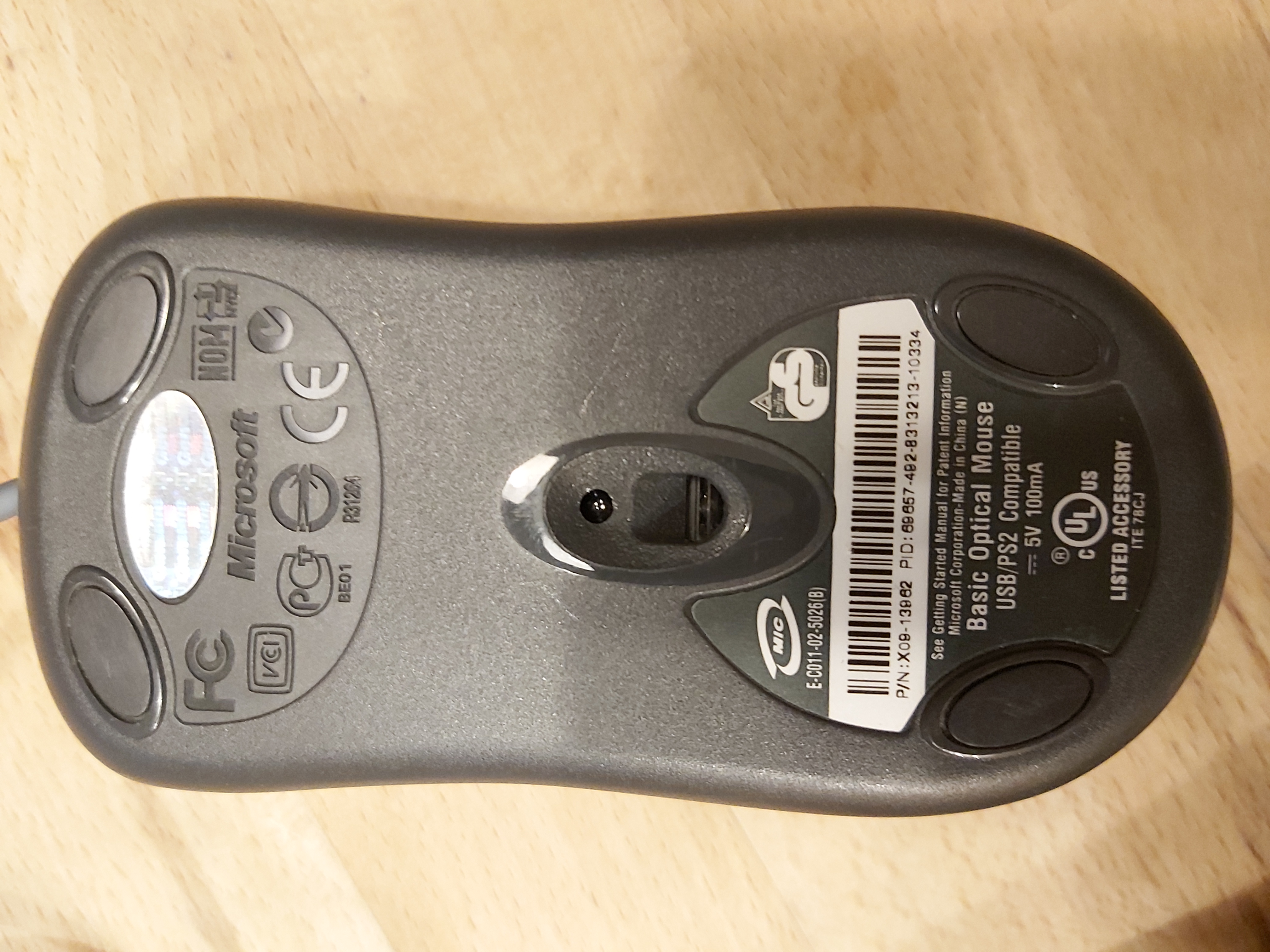

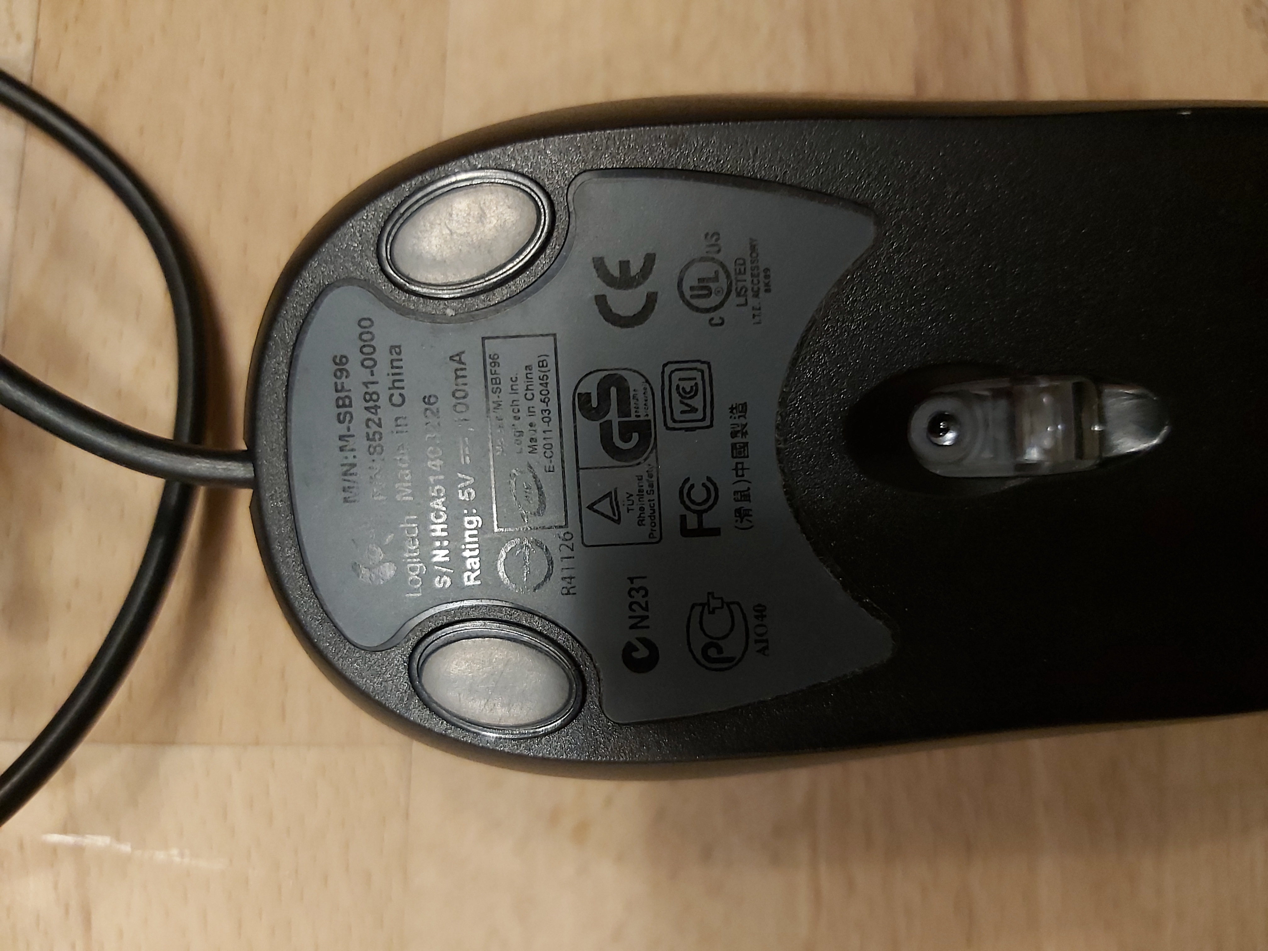

sorry to hear to you have some issues get the mouse running. These mice proven to work with QIMSI:

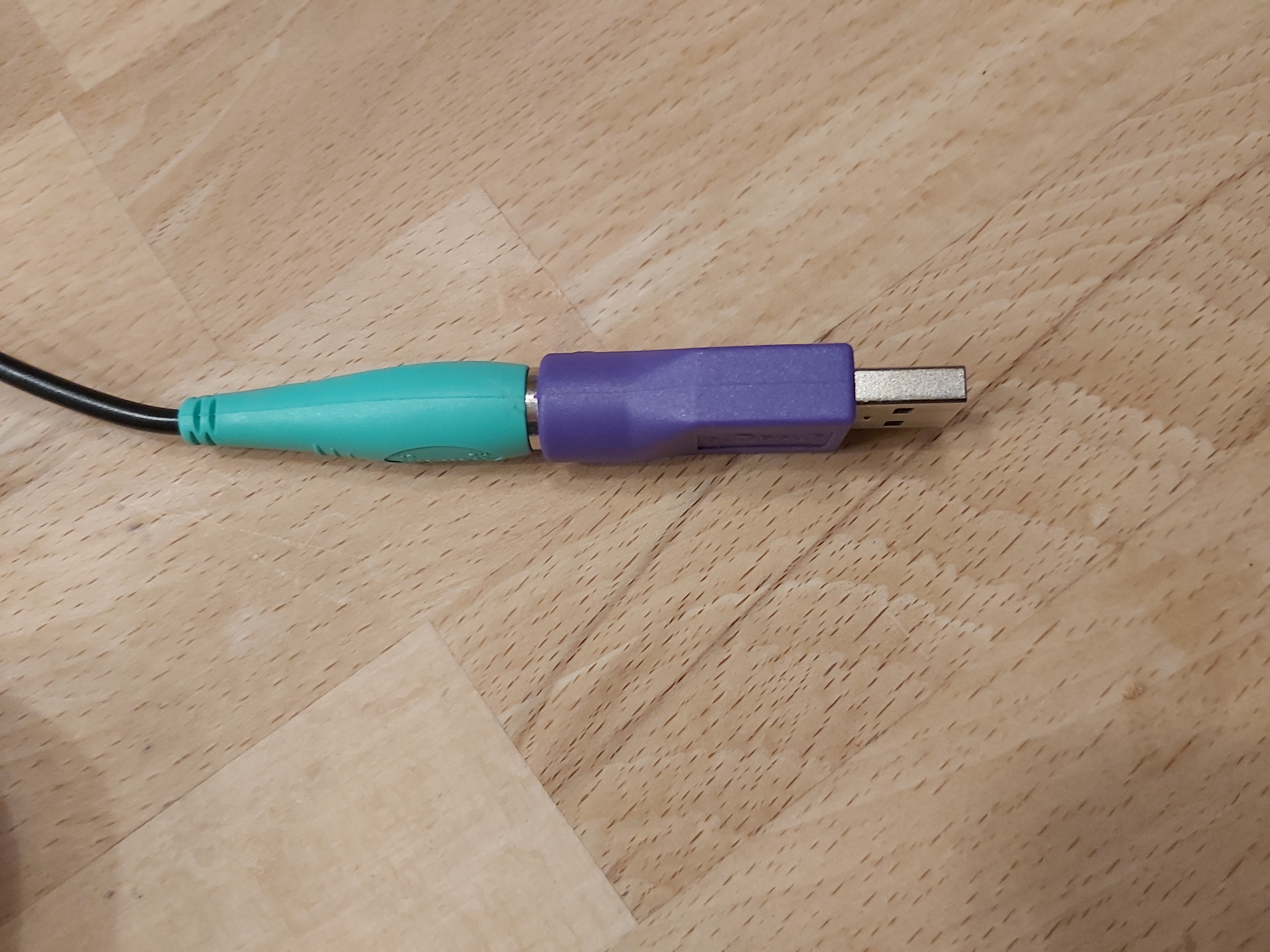

Also I made a picture of the PS/2 to USB adapter which works with my PS/2 mouse.
If not mistaken I sent you a link with the same mouse Peter proposes to use. Is it not available in UK?
I tested each QIMSI in terms of mouse, SD-Card, keyboard and sound so there must be a solution for this problem. Also I got feedback from other users that the mouse works.
