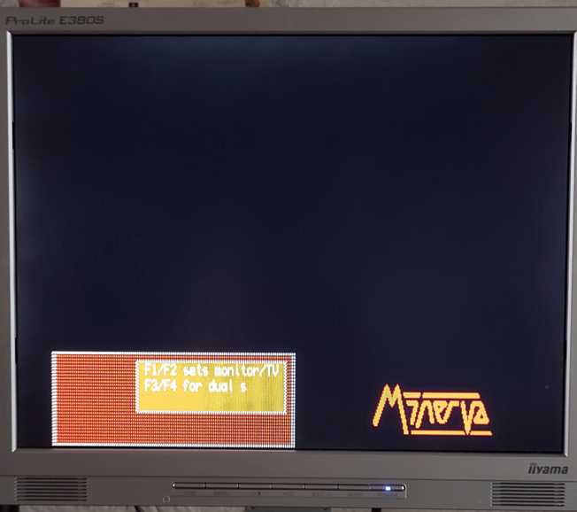

dilwyn wrote: Sun Jun 18, 2023 9:21 am I can confirm that even without a mouse connected (keyboard connected direct to Q68 without splitter cable) mine never even gets as far as being able to press F1 or F2 to start Minerva.
* UPDATE *: I have uploaded a patched version of Minerva4Q68 which should fix the interrupt problems; the mouse and Ethernet interrupt is now disabled on startup and an external interrupt handler added for the keyboard. Can you please try out this one?
This is a US keyboard version with TKII included so 96K. You may have to rename the unzipped file to Q68_ROM.SYS as zip/unzip seems to have its own opinion about how file extensions should be written. Alternatively, you can use Min4Q68ldr to load it from SMSQ/E.
Link to the ZIP file: https://files.bredenbeek.net/s/D8EC6PZ8PABnuR8c
As Q68_ROM.SYS it gets as far as the Minerva text in the picture below.
As a ldr/rext file LRESPRed from SMSQ/E it only gets as far as drawing the Minerva logo, no other text (in case the relative timings give you a clue).
In both cases, as before, after about 30 seconds (varies) it disappears off into a random technicolour crash screen.
Interim Min4Q68 startup

Just to close this conversation down for now, I got several mice and keyboards out, and tried all combinations, along with three different brands of SDHC cards. With and without mouse attached. With and without the keyboard/mouse adaptor.
It took ages to work through them all!
All combinations worked if I used Q68 SMSQE. Not a single combination worked with either the original or intermediate Minerva4Q68.
Like I said in another thread, starting to look like I have the only Q68 in the entire universe which can't use Minerva4Q68 :cry:
