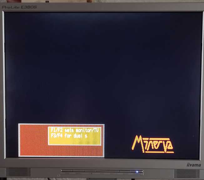

Re: Minerva4Q68 SD Card Setup
Thanks Jan, but still no joy. Here's a photo of where that version gets to: Out of interest, just in case I happened to be using a duff SD-card, I reformatted it and put Q68_SMSQ on it. That started up fine. So I reformatted it again and retried the 96K version, which continued to fail.janbredenbeek wrote: Mon Jun 12, 2023 10:22 pm Hi Dilwyn,Here is a link to the 96K image of my stable branch: https://github.com/janbredenbeek/Minerv ... _USROM.SYSdilwyn wrote: Mon Jun 12, 2023 8:07 pm Would it be possible for you to send a zip or image of your working Minerva4Q68, Derek? (Q68_ROM.SYS or _rext versions - either via here or to me by email) Then we could eliminate errors on my part in setting it up.
This is the earlier version which has the SD card driver in the $10000-$18000 area so no room for other extension ROMs. The actual keyboard handler hasn't changed since, only the setup code is different. But it might be useful to see if the newer version has bugs or maybe the image was corrupted. (from Derek's photo I gather that he's still using this version).

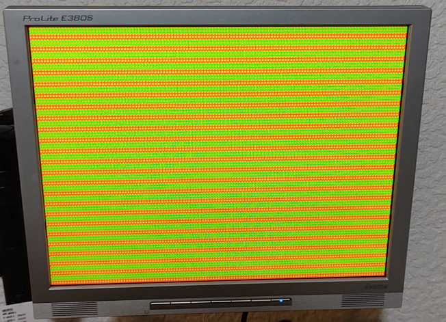

Derek recently mentioned that Minerva on his system worked fine, but that he only used a keyboard. I can confirm that even without a mouse connected (keyboard connected direct to Q68 without splitter cable) mine never even gets as far as being able to press F1 or F2 to start Minerva.

At least the crashes are more colourful without a mouse
[attachment=0]q68-6.jpg[/attachmennt]
(Not able to use a computer much at the moment as this village is back in and out of bloody power cuts again, so typing this hastily while we actually have power.)

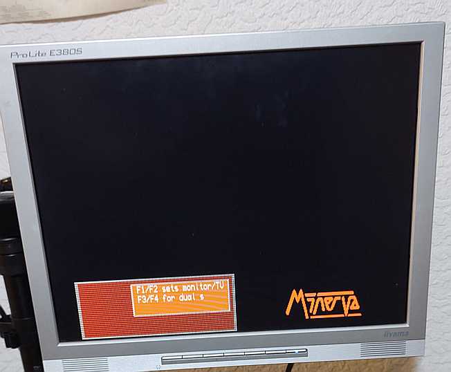

As Q68_ROM.SYS it gets as far as the Minerva text in the picture below.janbredenbeek wrote: Mon Jun 19, 2023 8:02 pm* UPDATE *: I have uploaded a patched version of Minerva4Q68 which should fix the interrupt problems; the mouse and Ethernet interrupt is now disabled on startup and an external interrupt handler added for the keyboard. Can you please try out this one?dilwyn wrote: Sun Jun 18, 2023 9:21 am I can confirm that even without a mouse connected (keyboard connected direct to Q68 without splitter cable) mine never even gets as far as being able to press F1 or F2 to start Minerva.
This is a US keyboard version with TKII included so 96K. You may have to rename the unzipped file to Q68_ROM.SYS as zip/unzip seems to have its own opinion about how file extensions should be written. Alternatively, you can use Min4Q68ldr to load it from SMSQ/E.
Link to the ZIP file: https://files.bredenbeek.net/s/D8EC6PZ8PABnuR8c
As a ldr/rext file LRESPRed from SMSQ/E it only gets as far as drawing the Minerva logo, no other text (in case the relative timings give you a clue).
In both cases, as before, after about 30 seconds (varies) it disappears off into a random technicolour crash screen.
