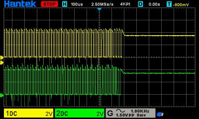

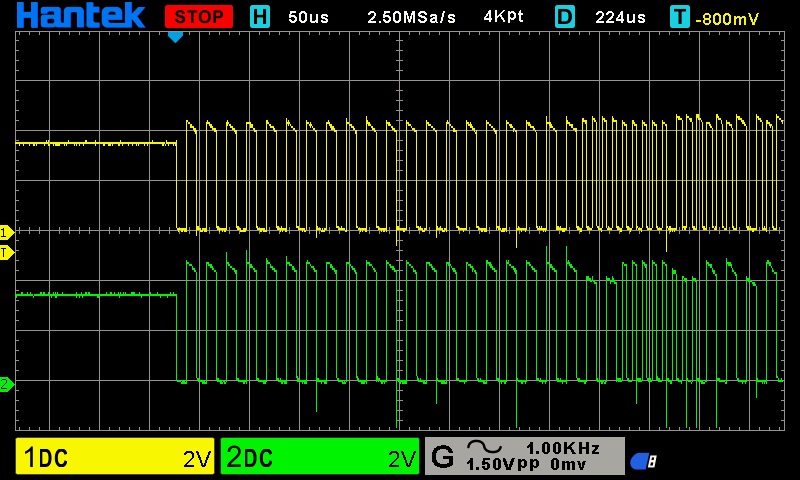

Here are some screen dumps from the oscilloscope.
Sector timings and gaps. Gap between header and data record. Data start. Track 1 is yellow. Data end. Track 1 is yellow. Data timing Thanks allot!
Antony
Antony

Hi Anthony
On first inspection, the only things to stand-out are the over/undershot/ringing of the RAW signal lines and also the very sharp falling edges.
The ringing may just be an artefact of the scope probes, but given the age of the QL ULA, I wouldn't be surprised if those voltage 'excursions' are upsetting the ULA electronics..
From speaking with Charles Ingley some time ago, we suspect that the ULA is of a hybrid digital/analogue design and between it and the MDV ULA itself (on a real unit), just use voltage shaping to create a digital-like signal.
The cleanliness of your falling edges might, counter-intuitively, indicate an incorrect drive circuit as (again, somewhat speculatively, and after chatting with Dave Park about it last year) we suspect the use of an 'Emitter-follower' type output (I think I've used the right term), which typically gives sharp rising edges, but lazy falling edges, with a definite slope-off - which the ULA copes well with.
You can observe these lazy falling edges in traces of real MDV units which are read well enough by the ULA.
[EDIT: I have attached a one-page document that includes some sample MDV traces from a real unit clearly showing the typical slope of the falling-edge - that was written-up to replace the rather blurred page present in the QL Technical Service Manual (Appendix D5). Compare figures D3, D5 & D8.]
You'll notice that both the QL and the Spectrum/Int-1 include passive pull-down resistors on each RAW line (across 10k ohm to 0v in the Int-1 and 33k ohm to -12v on the QL.)
If the ringing is the problem, placing a capacitor across each RAW line (figure out a reasonable RC constant) might help - the line amplifiers in the ULA will re-shape it.
Just some initial thoughts, anyway...
Keep us posted!
