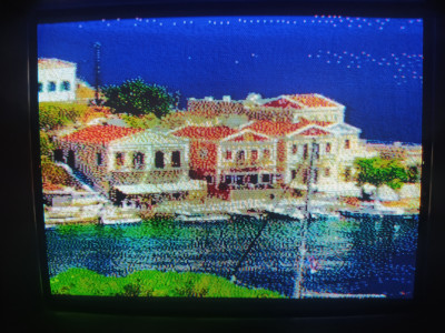

Post by lliont »
Photo converted for the QL with the help of Gimp and a little C# program I wrote.
Posts: 1742
lliont wrote: Fri Feb 03, 2023 11:28 pm 1675466692881.jpg
Nice, if you replace sqlux-pallette.png with your pallette this https://github.com/xXorAa/ql-picture program will convert photos to _scr files!

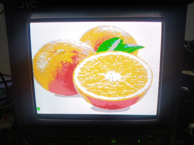

Post by lliont »
This works nice
