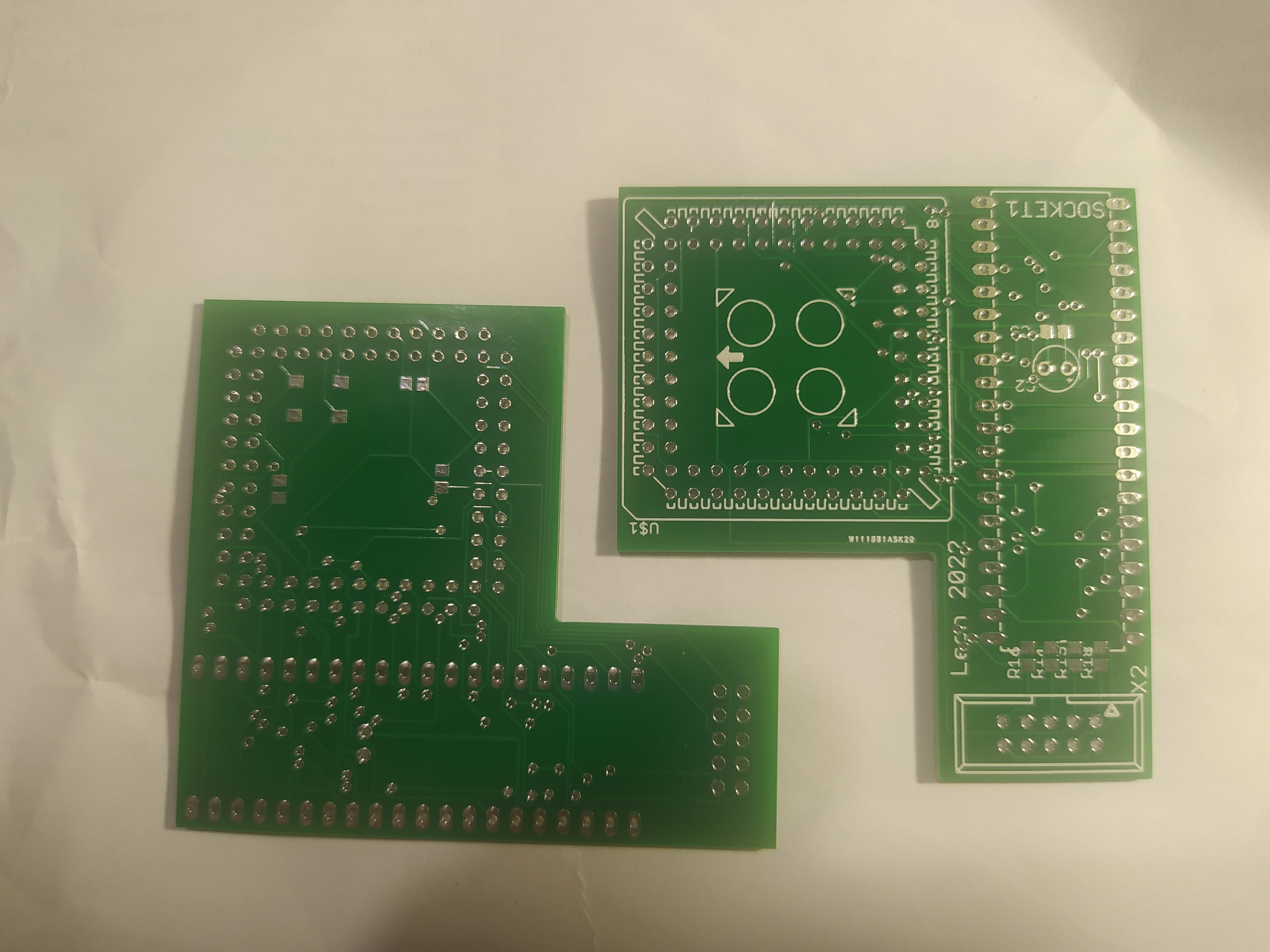

Theodoulos Liontakis posted on the Sinclair QL For Everyone Facebook group that he has successfully created a CPLD replacement for the ZX8301.
This link will likely not work unless you are a member of the group:
https://www.facebook.com/photo/?fbid=54 ... 4457487075
Here is a picture:
Here is a picture:

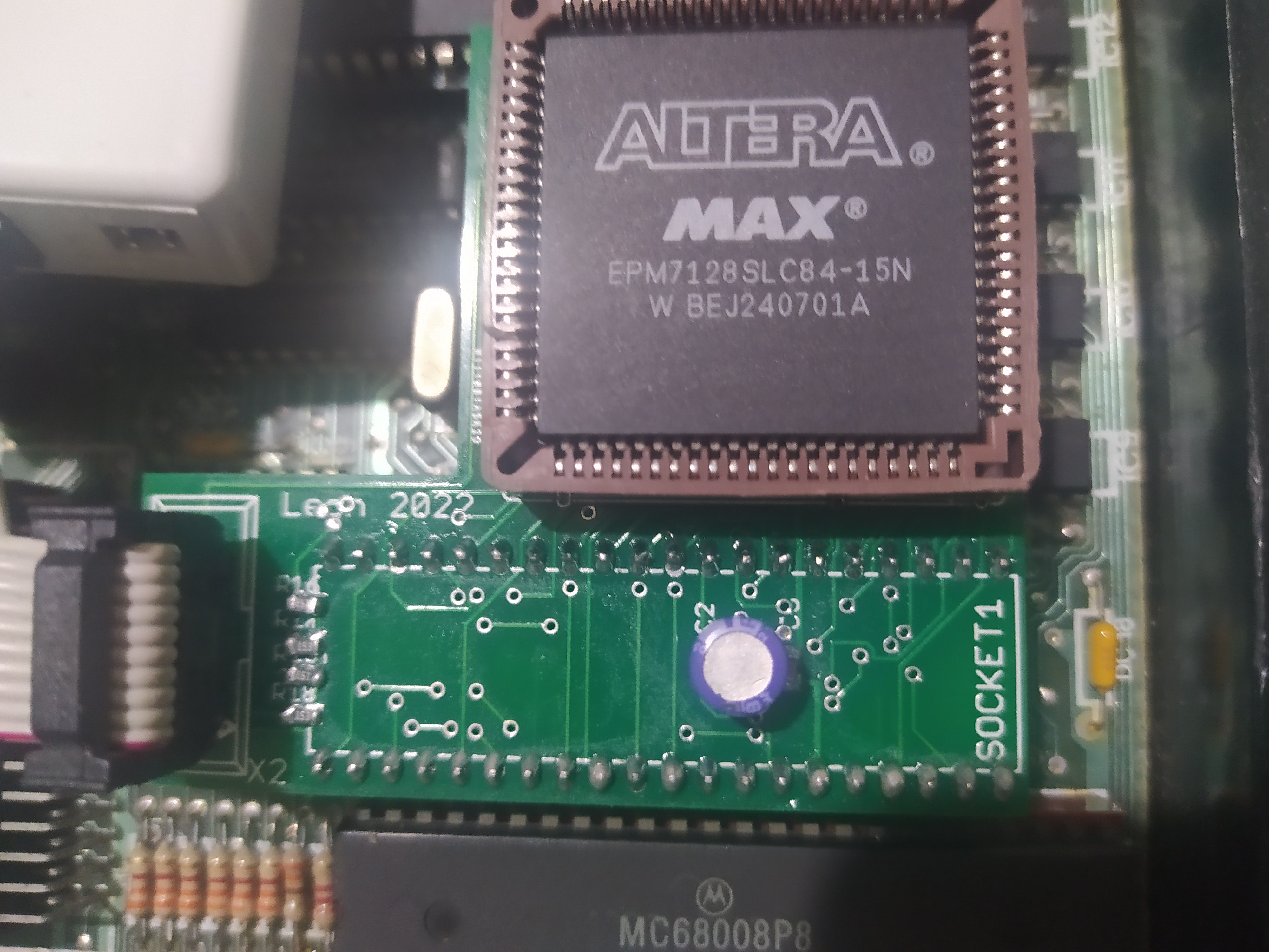

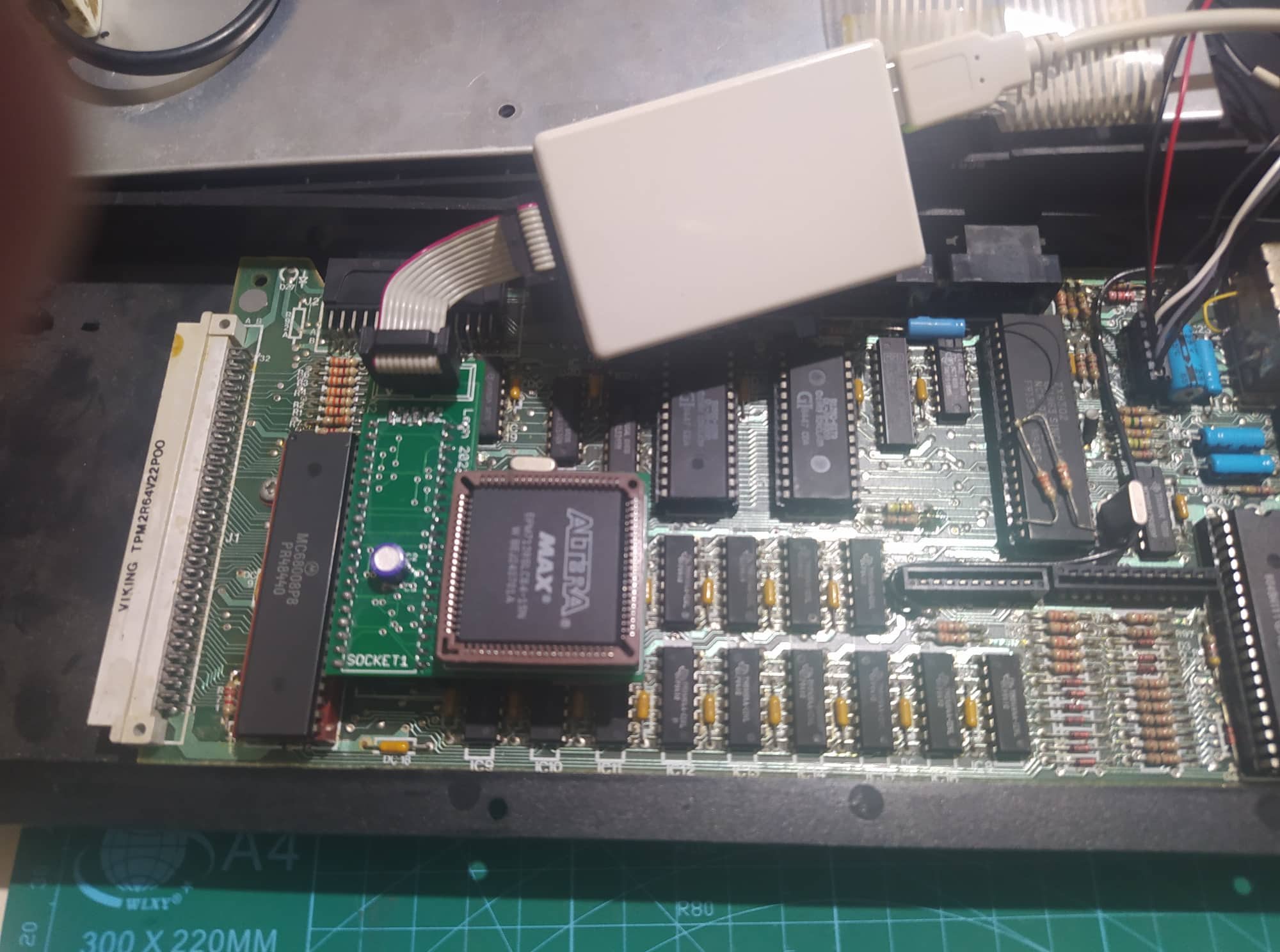

It works with everything I have tested (not much) including my version of qubide card (832K ram) and the Micro Peripherals floppy controller.
I haven't implemented the flash bit because I can't fit it in EPM7128S CPLD, but I have ready the code for a EPM7160 CPLD and waiting for the ic I ordered from China to test it.
I made a new pcb that will work with either 7128S or 7160S and also has a buffer for the video signal for better quality but I haven't ordered it yet.

Maybe I'll make it public, not sure about the source code, maybe just the CPLD programming file and the pcb.

Would video output also benefit from ESD protection?lliont wrote:also has a cd4050 buffer for the video signal for better quality but I haven't ordered it yet.
Even if something gets damaged from ESD it would be a cheap chipM68008 wrote: Would video output also benefit from ESD protection?
The reason I add the buffer is a flicker I noticed in the 256x512 mode in some patterns and I think the buffer can drive the video outputs better.
By the way if someone has to suggest of a suitable video buffer (but cheap and easy to get) please do, I haven't ordered the pcb yet so I can still make changes.
I have a lot of 74LS241 buffer/line drivers -15/24ma, 12ns, 133 Ohm load maybe those are ok, I'll see.
I'm sure the LS chip is less sensitive to ESD.
Leon

I'll inform when I finish and test the next-better version.
