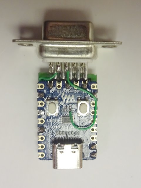

Re: QL Pico VGA
Bottom side with the RP2040 zero module. Note that the HD-Sub must be soldered to the QL adaptor board first, before the module is added.

Posts: 2489
Re: QL Pico VGA
Derek_Stewart wrote: Thu Feb 02, 2023 2:34 pm I will maybe get a batch of 30, which would include the Pico RP2040-Zero
Please keep in mind it is currently required to desolder the LED from the module. Not a nice job for 30 pieces.
