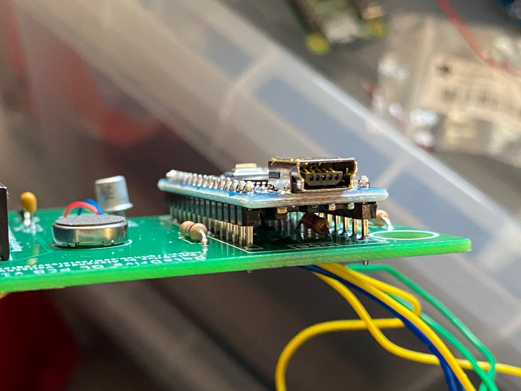

New PCBs have arrived:
I created a small 3D printed bracket to stop the PCB moving about/sagging and also a little cap which goes over the pin connector to help route the wires All these can be found on Thingiverse https://www.thingiverse.com/thing:5321965
Short video on YouTube of it working https://www.youtube.com/watch?v=1OUQeBX35TI
And some photos of it being fitted:
Fitting Nano to PCB: 3D Printed bracket: All in place: Lid shut:
All fitted and running great. Have configured the QL so OqtaDrive is mdv1 and the real hardware mdv2 still. I've wired up the LEDs so the case on is read and internal write which looks great. Only thing not completely happy with is I had to mount the Nano direct to the PCB rather than using a header strip as it is very tight and the larger USB connector gets in the way. I created a small 3D printed bracket to stop the PCB moving about/sagging and also a little cap which goes over the pin connector to help route the wires All these can be found on Thingiverse https://www.thingiverse.com/thing:5321965

I'm wondering, is the USB required after programming the Nano? If not maybe the Nano mounting stuff could be replaced by the minimum required to keep an ATmega328P (DIP version) in operation -- the Atmega, a two or three 100 NF caps, a 10K resistor and maybe a reset switch. That might get you some extra space on the board and get it to fit better. It would run on the internal 8 MHz oscillator rather than needing the 16 MHz crystal + two 22 pF caps, or a 16 MHz resonator, in this config -- which, given the speed of a BBQL, would probably be fine. (But I'm open to correction.)TomDD wrote:Only thing not completely happy with is I had to mount the Nano direct to the PCB rather than using a header strip as it is very tight and the larger USB connector gets in the way.
I build a "Normduino" on a breadboad using just those components (and a 6 pin header to program it) and it works fine, once fused for internal oscillator use.
Just wondering.
Re: OqtaDrive
USB isn't needed at all as you Flash the Nano via the Pi using the hardware serial. Surface mounting a ATmega328P and supporting circuitry would work great, just a bit beyond my skill set and hence why I just use an off the shelf Nano.NormanDunbar wrote:I'm wondering, is the USB required after programming the Nano? If not maybe the Nano mounting stuff could be replaced by the minimum required to keep an ATmega328P (DIP version) in operation -- the Atmega, a two or three 100 NF caps, a 10K resistor and maybe a reset switch. That might get you some extra space on the board and get it to fit better. It would run on the internal 8 MHz oscillator rather than needing the 16 MHz crystal + two 22 pF caps, or a 16 MHz resonator, in this config -- which, given the speed of a BBQL, would probably be fine. (But I'm open to correction.)TomDD wrote:Only thing not completely happy with is I had to mount the Nano direct to the PCB rather than using a header strip as it is very tight and the larger USB connector gets in the way.
