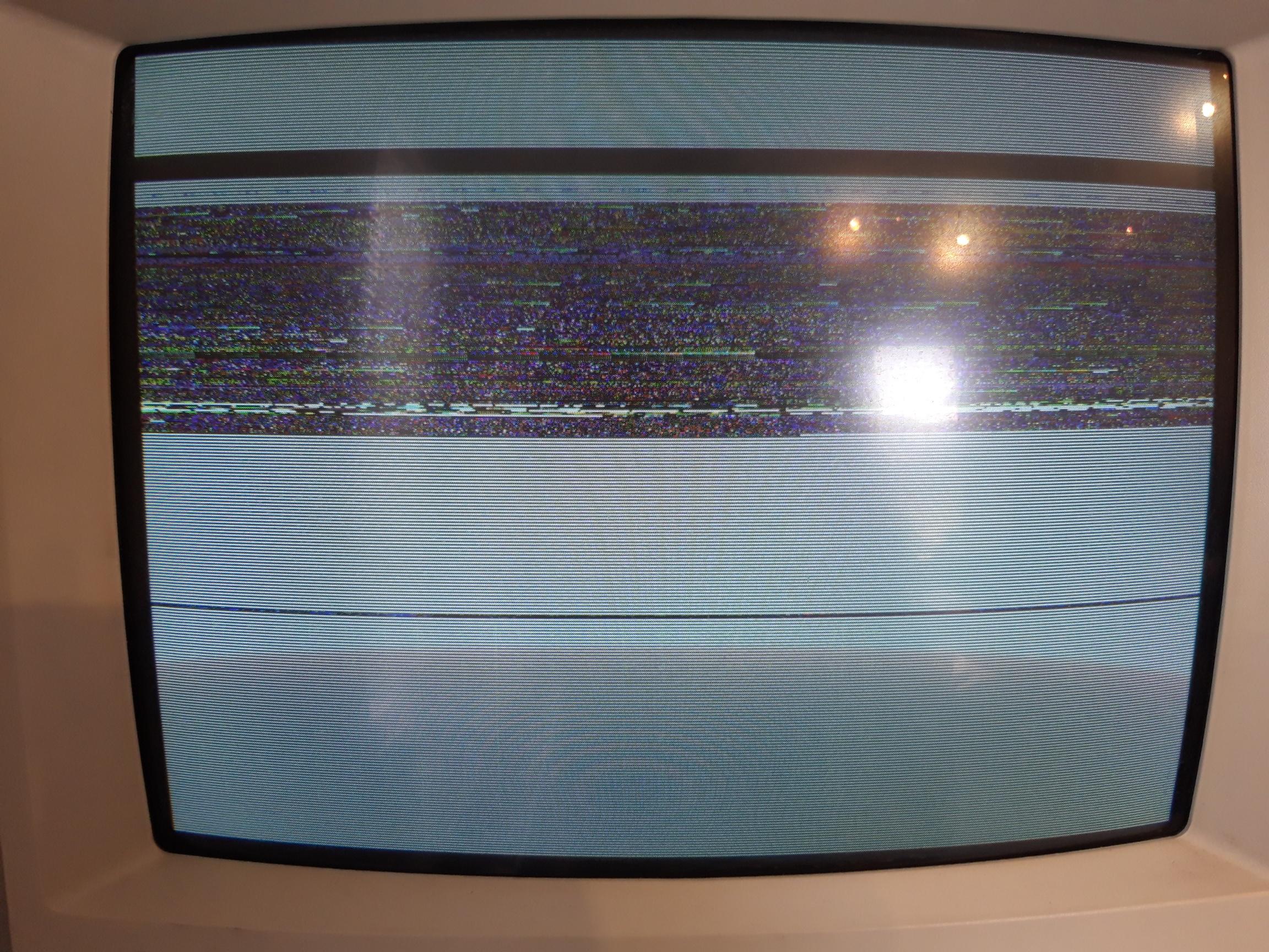

Just tried Fabrizio's ROMs too and they don't work for me either. It gets stuck on this screen, bit like after a reset but without continuing.
I'll have a word with the previous owner to see if there is something special I need to take into account.
