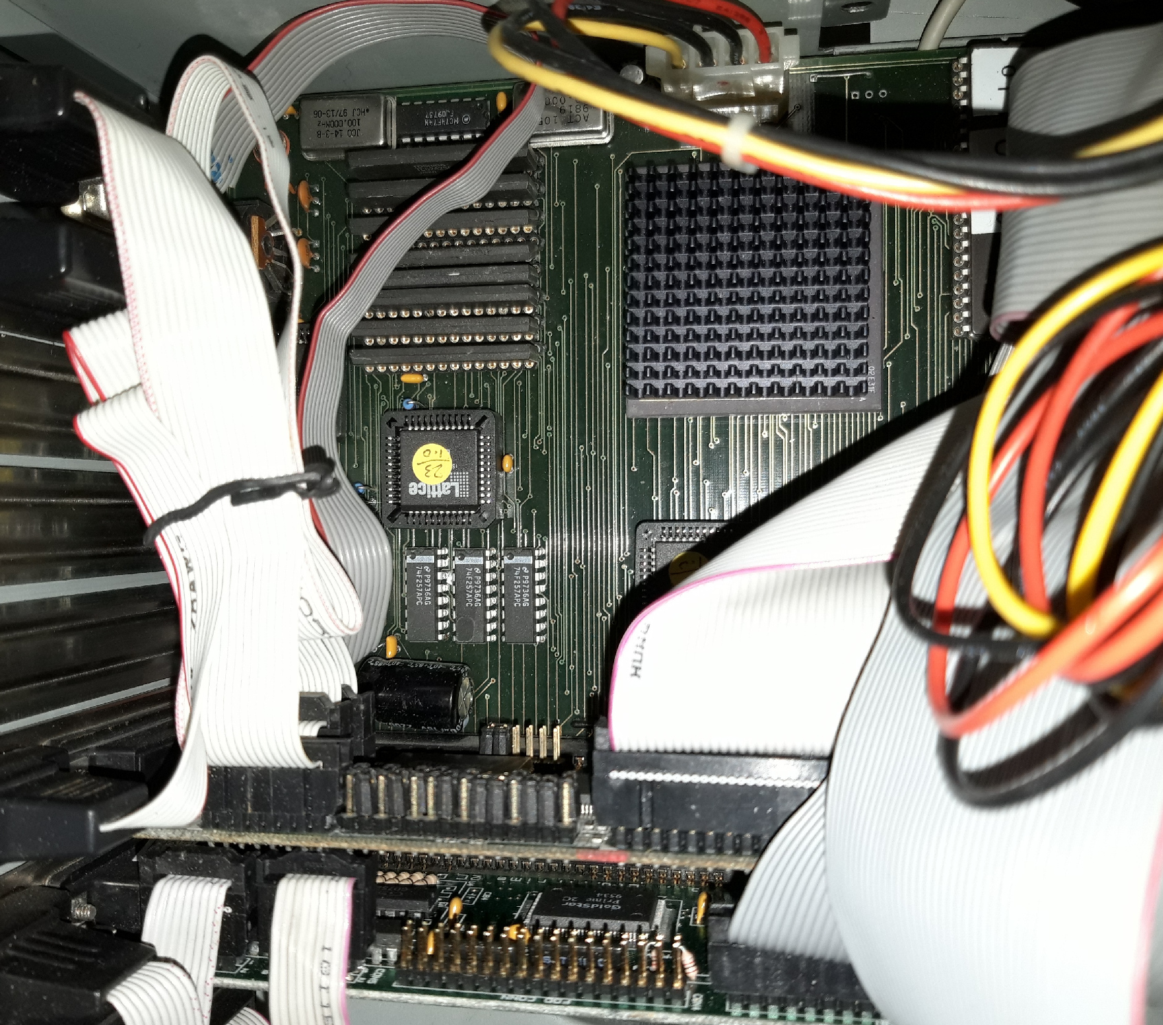

I have a Q40 to play with!
1. Apart from the CPU, what are the actual physical differences between the Q40, Q40i and Q60 motherboards?
2. What is the power requirement of the mainboard with 2 ISA cards for HDD/serial fitted, and out of interest does it actually use the +12v on it's molex input connector - all the board is no doubt 5v but I wonder if ISA/serial connections are what require the 12v?
(I'm wondering about potentially doing away with the wheezy old style PSU with fan, but I suspect with drives added it will require 5+ amps - or not, with just a CF)
3. Is it possible to attach a Q40 to an old fashioned QNET, i.e. for connectivity with an original QL/QXLII and Q68?
4. I understand that normally the 2nd ISA slot was an Ethernet card. What make/model was this? (so I can potentially source one).
Lots to explore and like with most technical things, I'll probably never get my head round it sufficiently, but I do have fun trying.
I will pop it in a new case eventually and perhaps make some changes to the hardware configuration. A few questions that come to mind (Peter and Derek will know the answers, but no doubt others will do too).1. Apart from the CPU, what are the actual physical differences between the Q40, Q40i and Q60 motherboards?

Looking the photograph of your Q40 board, it looks like a Qbranch board.
The difference between a Q40 and Q60 is the CPU, ram and lower voltage for the 68060.
Conversion from Q40 to Q60 is possible, but the Qbranch made Q40 boards used low tolerance parts and caused problems.
I have some Q40 and Q60 boards, which have user introduced faults.
There was an article in QL Today, about 68060 CPU Mask codes, so a few expert Q60 users removed the heat sink to read CPU mask code. But they did not refit the heat sink correctly, damaging the CPU.
I might find time to fix these boards some time.
Why are you bothered about the minium power consumptio n, a PC power supply will power the Q60 no problem at all.
