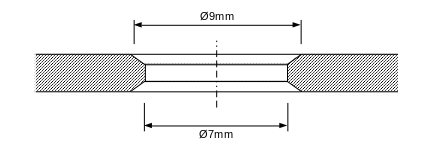

My 4 feet QL case. Can drill two more holes in the middle, and put additional two spare rubber mats in place [have 4 originals@ebay ]. Making 6 feet QL bottom.
Two drills dia needed, 7mm and 9mm, hand work only, it's soft polystyrene, avoiding electric machinary. 7mm through hole, 9mm from either side, but not through.
To flatten warp, can experiment with hair drier, to warm case and rectify.
drill for foot
drill for foot
Starting off with small holes, 0.5mm, then 1mm, 3mm, ...
