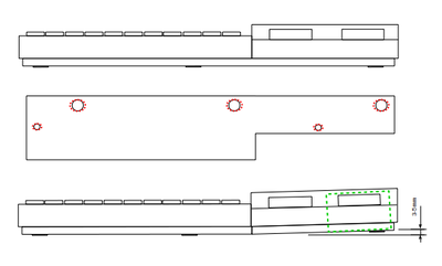

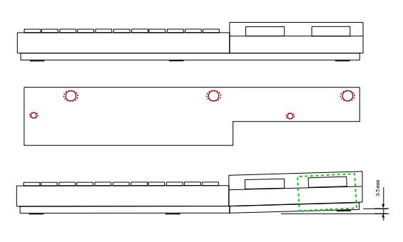

This topic I have wished to bring up for quite some time. Has anyone observed slight distortion of the case as QL warms up? I did. I was thinking what could cause such distortion. I tried to capture in the picture.
QL Case Warp
QL Case Warp
The warp is apparent on the right, in the worst case, causing top lid touching down on MDV2 head board. Sinclair rectified with a stand off spacer (plastic collar).
Has it not to do with two distinct materials (PCB, case), being firmly fastened with screws, due to some thermal dilation, leading to sort of `bimetallic effect'?
Provided above correct, which really is only my assumption, could it be rectified by making mounting PCB holes oval rather than strictly circular allowing for thermal dilation to compensate?

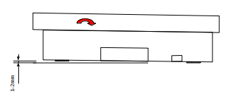

Regarding torsion, I can observe that as well. Both warp and torsion develop on the right side, where QL builds up some heat arround the heat sink, the bend starts from MDV1 unit rightwards. In cooller days smaller, in summer days of course bigger.

I was hoping to compensate by making two right PCB positioning holes, and one right mounting screw hole, bigger with some +0.5-1mm tolerance, to allow for PCB dilatation, if not too silly an idea.
This is only an assumtption, possibly entirely wrong.

Cool, perfect, barely populated Iss#6 board. Now having close up in front of my eyes, simply proves making even slightly bigger mounting PCB holes, not brightest the idea, as there are some tracks going near by?
