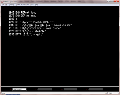

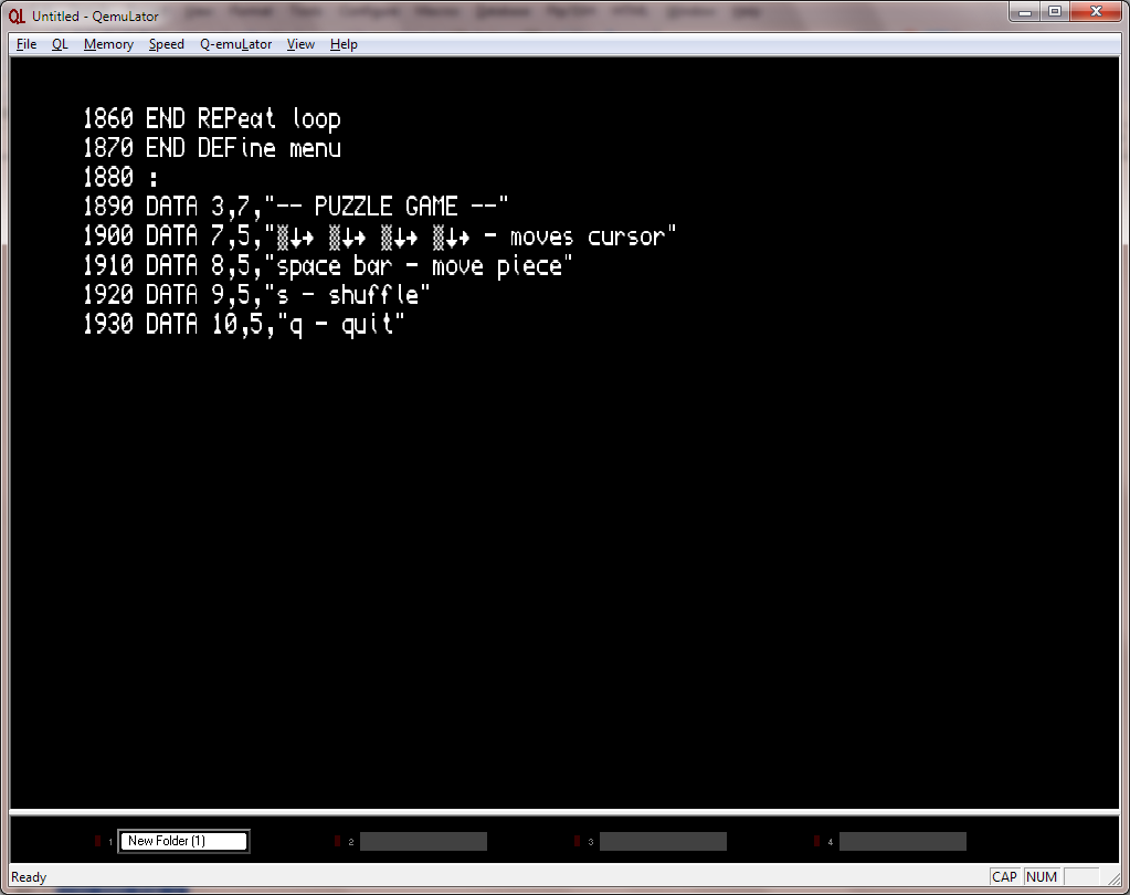

Well line 1800 does not help. I wonder why every line starts with a TAB when you copy and paste it from the site....
To get this into q-emulator, I use TotalEdit which has the ability to set various things such as the character set, and line endings - I tried a new document with UTF-8 and <LF> as the line ending. Pasted the program into it and then highlighted all the lines, did SHIFT TAB to remove the starting tab on each line.
Saved it to a folder and ran it in q-emulator.
It worked, but line 1800 is corrupt - see image - I wonder if there is a way around this...:

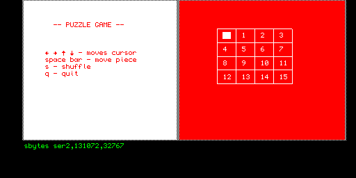

I wish to also share a screen capture of my first prog. As I use TV in monitor mode, I need to
adjust windows size, you can therefore see some black margins around boot screen.
This sets my windows as the best fit of TV visual area
2 WINDOW #0,467,51,35,205
3 BORDER #0 : PAPER #0,0 : INK #0,4 : CLS #0
4 WINDOW #2,225,202,32,0
5 BORDER #2,1,255 : PAPER #2,7 : INK #2,2 : CLS #2
6 WINDOW #1,242,202,257,0
7 BORDER #1,1,255 : PAPER #1,2 : INK #1,7 : CLS #1
Puzzle Game
Puzzle Game
