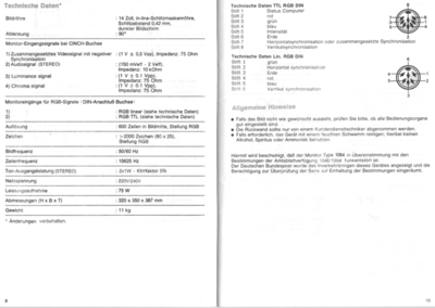

I have been lucky at the fleemarket, I got a Commodore 1084S monitor at the price of 10 GBP. I just had to clean it. My question is, is it possible that someone out there have a schematic of the cable between the QL and the monitor. Both have a 8 pin socket.

klausfrank wrote:Hi
Regards
When I got my 2nd hand 1084S a few years ago I found some pdf manuals but these only showed a 9D connection.
But I also found this image showing the TTL and analog RGB connections of my model.
I hope this helps.

Thank you very much. :) :)
